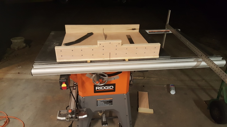

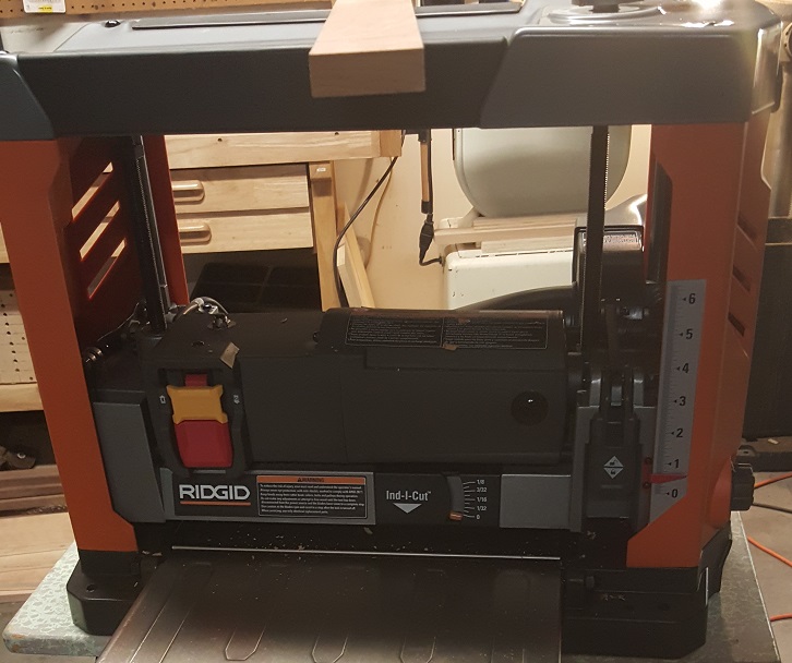

Went with the Ridgid Table Saw and built my first sled.used a borrowed dial indicater to square it. MAN it is so nice to use. Since the garage got broke into wife is really into going to Home Depot with me... so much she sprung for another orange thing. I need to rebuild my turning tools and accessories.To bad the box stores don"t sell turning stuff.
FYI Call around to your Local Home Depot the one in Dothan Ala clearanced these table saws out for $404.00 not all stores are doing it but worth looking into if your in the market
Sherman; The sled looks nice. I would make only a few mods to the sled.
1. Add a block of wood to the fence over the slot in the fence. The spinning saw blade comes out of that slot and can get in the way of your fingers. :eek:
2. Along the same lines, add two cheap door handles horizontally to the fence at both ends of the fence. This encourages you as to where to put your hands and fingers while pushing the sled! :smile:

Back to the sled I did place a block on the rear and will add the handles,
Ok do you guys build differant sleds for dado work? Just wondering.

Sherman that stinks on the theft! I just built a similar sled two weekends ago and did a simple miter sled too. Really fun projects. Glad the theft wasn't worse, you'll be back in the sandpaper in no time!

I have the older 4511 with the granite top. Motor is maybe a tad underpowered but a nice thin kerf blade seems to help out with that. Only real issue I've had is the blade height adjustment bracket wore out just enough to drop the blade. In the future I'd make certain to lube that part more frequently.
