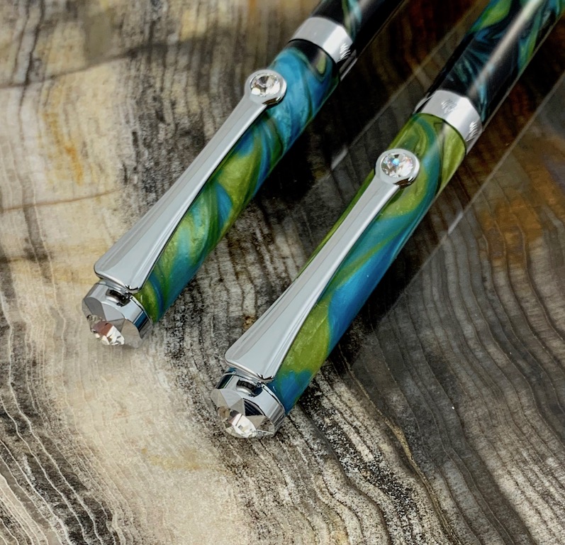

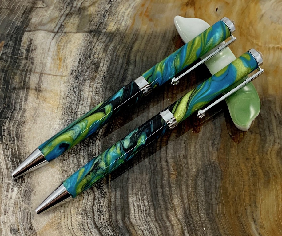

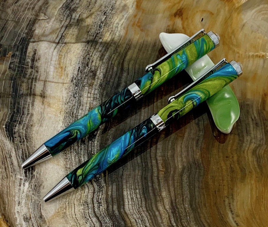

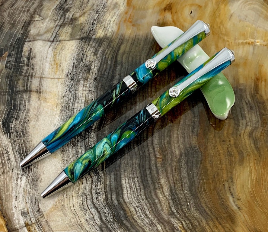

Marla, my wife if you didn't already know, has been working a lot so she asked me to turn a couple Regals for her to give to friends. How could I say no? She has had them stashed for a while and William Wood-write no longer sells them. They are sold in the US under the name Zoe if you want some. The blanks are polyester resin made by Johnathon Brooks a decade ago and I don't know if he still uses PR. They were hard and if rushed would chip so with care I turned them between centres with a skew, stopping a few times to sharpen. Sanded with 320, 400 and #0000 steel wool, then to the Beall buffing wheels to put the shine on. The upside to the hard material is that it polishes up nicely.
Thank you for the compliments guys.
It is a nice size pen for a lady and I suppose guy 🤷‍♂️🤷‍♀️ that likes some bling 🙂 The tube is 8mm and it finishes out at 10mm/.400 in diameter.
