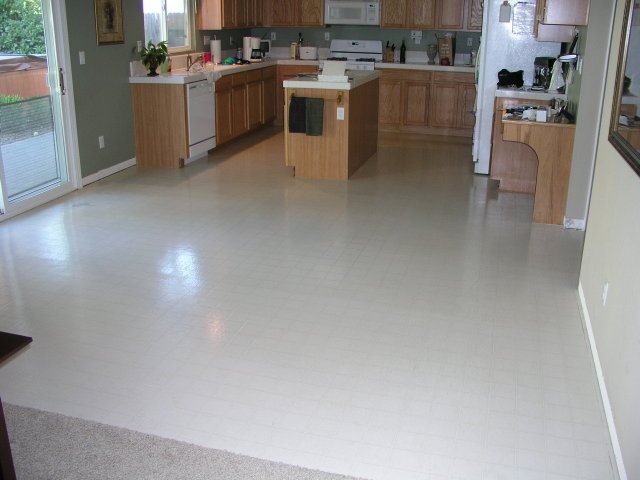

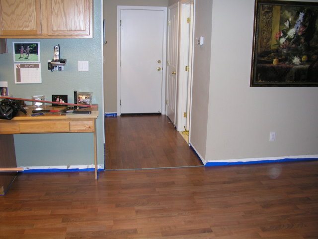

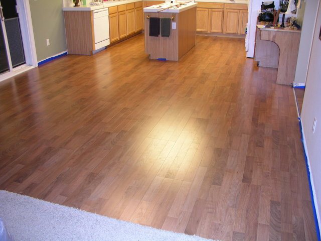

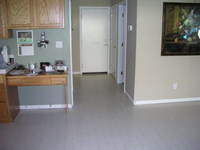

Ok a Lot of Flat work... Real Flat...
My wife decided it was time to put in some laminate flooring in the kitchen area. Two days solid, but I got all of the floor in this evening. Just shy of 400 sqft. Dupont Walnut block. It came out very nice. I am still waiting for all of the trim pieces (Quarter round, carpet reducers, T-moulding, and hard surface reducers) which are ALL on backorder until the 17th.:( The base boards and door casings are all cut, and painted. They will be put in tomorrow. One thing for sure... I am still young, but I hurt more than I used to. Thanks for looking.
Before (Kitchen)...
Before (Hallway)...
After...
After...

Thats the flattest flat work I have ever seen! Looks like you did a great job and I bet you dulled a few saw blades on that stuff. I wish I had done ours in a darker color, we chose Rose Ash. It's very light and shows every speck of dirt and dust.

The floor looks good, but why did you change directions for the hallway? The flooring needs to run perpindicular (sp?) to the floor joists to prevent lifting, sagging and squeeking. Now if your floor is concrete, then you don't have much to worry about!

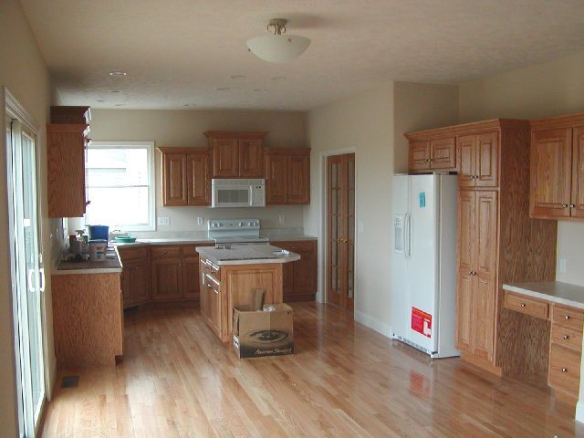

I was really stunned at the similarities between our kitchens (pic below for you to see hom much alike our tastes must be!).
Nice work on your's. I redid all the hardwood floors in the old house before moving to our current home - and it was time consuming but very satisfying once it was in.

The subfloor is concrete. Since the flooring is not glued or locked, it is common to change directions at hallways and what not. It makes the room flow a little more and the manufactuer suggests that a room of the size of ours be broken at a hallway. Now that the strip are all in it looks nice.
As for making my own, I will likely have to do that in two places as there is nothjing available.

Very similar Roger. I like the nice big window there though.
