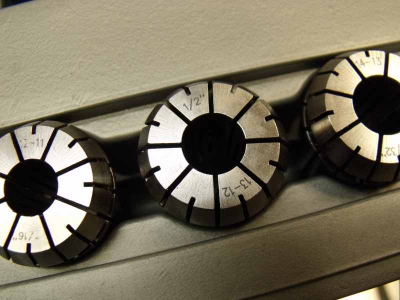

I buy everything in metric too, but as collets are 'variable' whether they are metric, imperial or whatever, it shouldn't make a difference should it?
I just took a pic of my ER32 set and they are marked in mm and fraction. :wink:
As I remember from previous conversations about this issue, these collets have a gripping range of about 1/16th of an inch. Therefore, the available sets of metric collets have no gaps, but the imperial ones did have a couple gaps.

Mack the ER series collets were developed for the machine industry and are the same no matter what the end use. The difference is in the quality and source of manufacture. They all fit in any of the myriad of holders used in industry including the collet chucks for our lathes.
