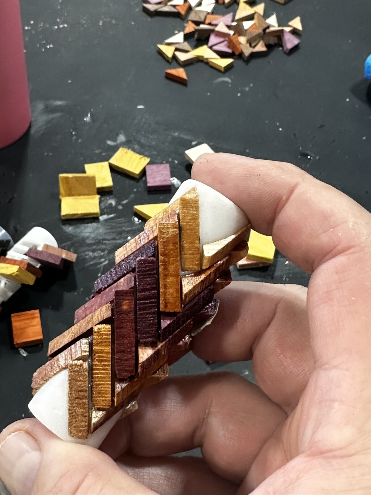

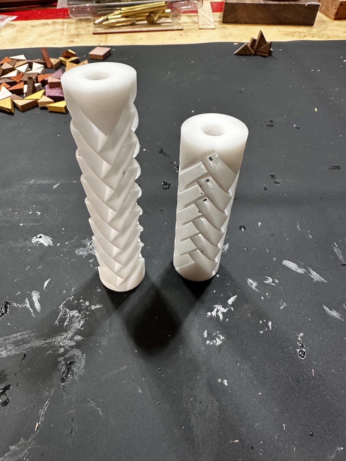

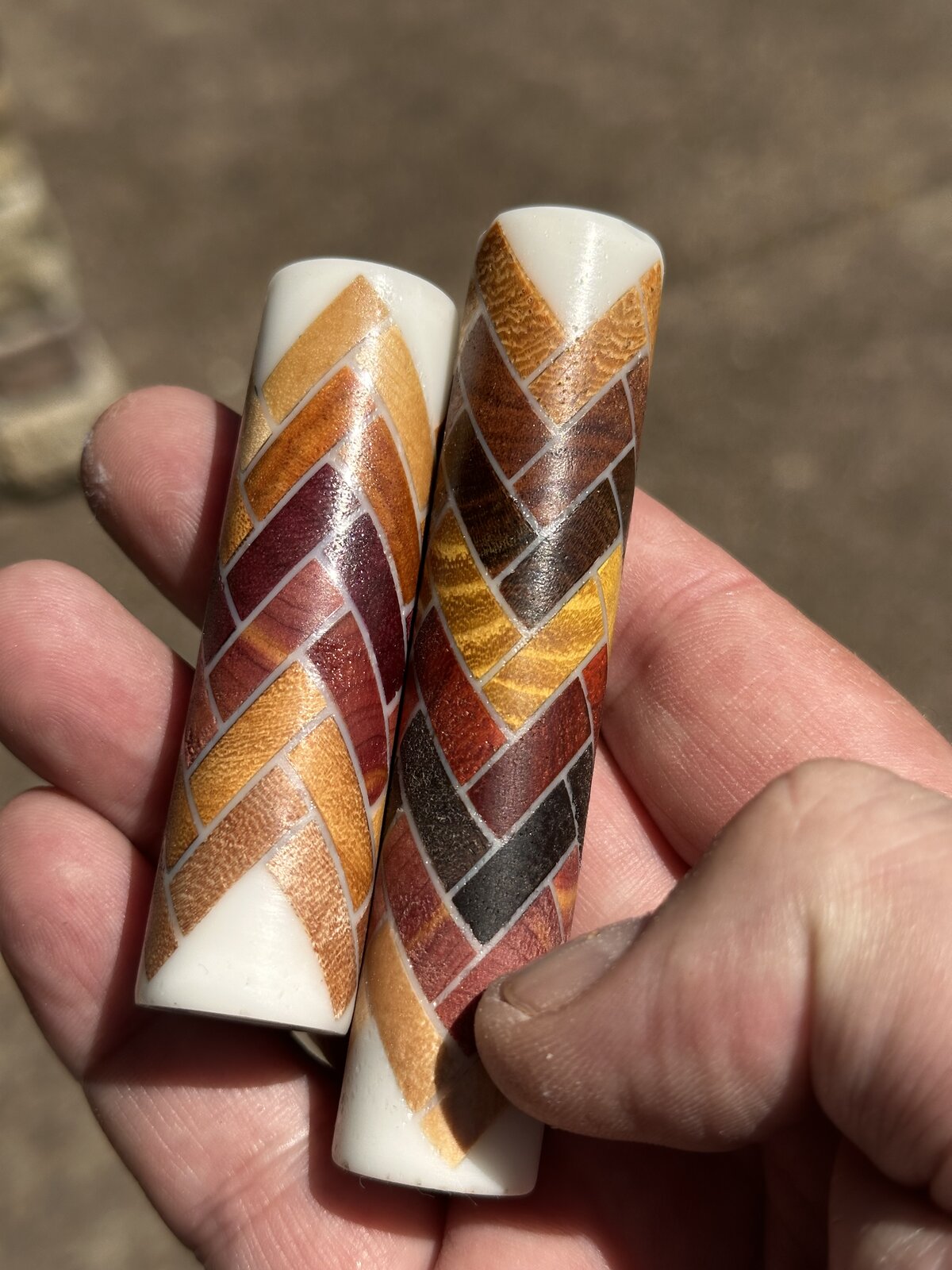

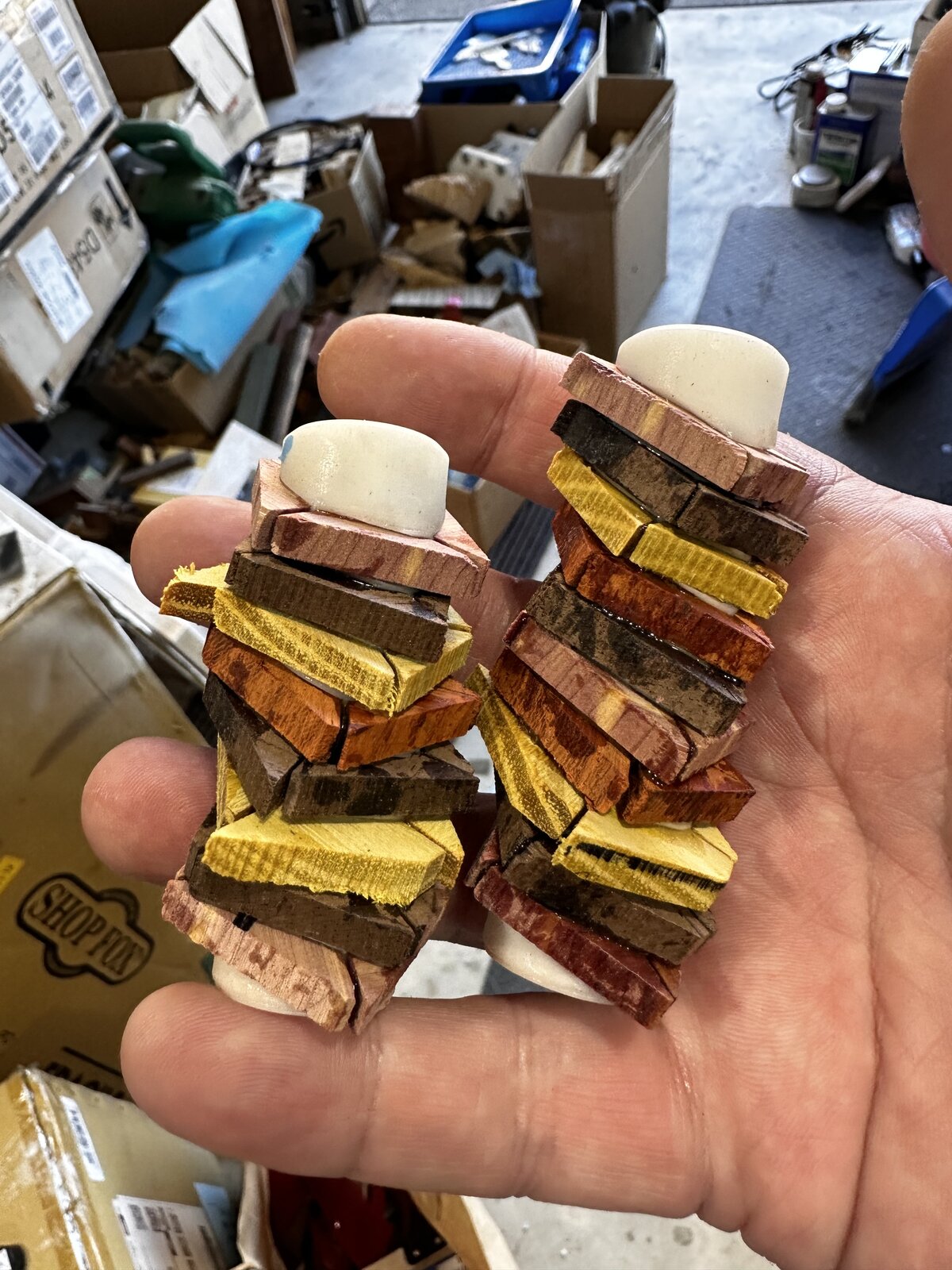

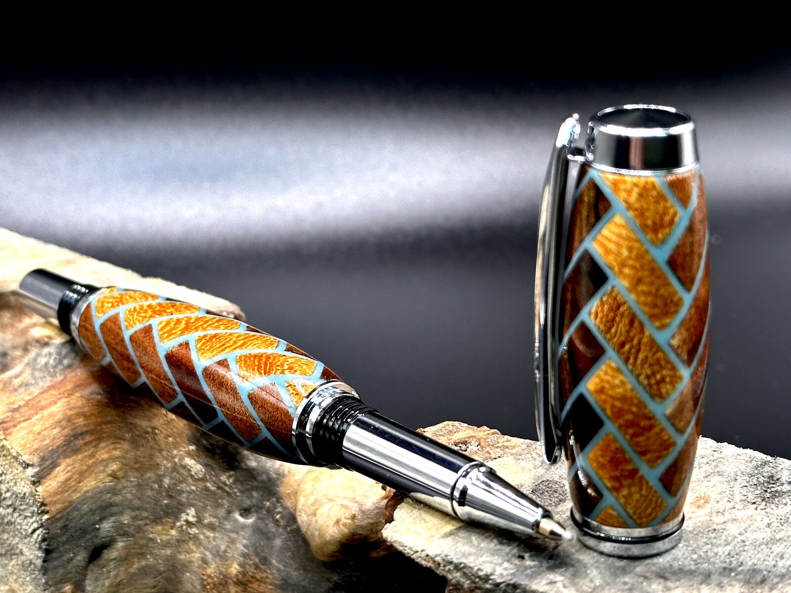

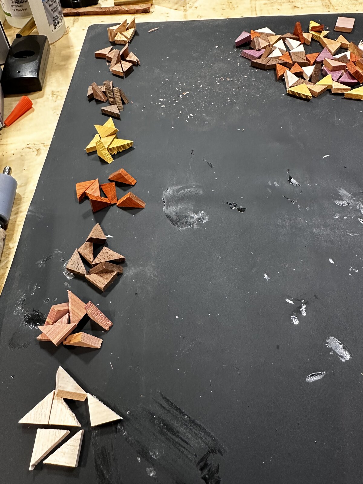

I love herringbone pens, specially the 360 ones, but not necessarily the process of making them, so I designed a method to make them using a 3D printed core (what I call a skeleton) in which I add the wood segments. Aside of making the process much simpler (without considering the design of the skeleton) the waste is significantly smaller. Let me know what you think!
I am adding some pictures of the process and the results.
Cheers

Excellent. Great idea. I majestic 360 herringbone blanks the "old fashioned way". Lots of work and lots of waste but I too love the results.

Wow. That is mind blowing. Beautiful work. Thanks for posting this!

One more thing, the beauty of this process is that you don need to be precise in cutting the segments aside of course of the thickness. But the the shape can be a triangle or rectangle as long as there are one 90 deg angle ;)

May want to consider marketing that... really really nice!

What material are you printing with? After gluing in the wood, is there anything you need to do with the printed portion to before turning? How much are you asking for the cores?

It is a UV resign material (abs like). I insert the segments and then I apply thing CA to the full blank. Super easy to assemble! Then I turn it between center (the cores have concentric holes for it. I am selling a pair (for a kit similar to the junior series size) for $15 plush shipping. Hope this help!

What are the diameter and lengths of the two pieces?
