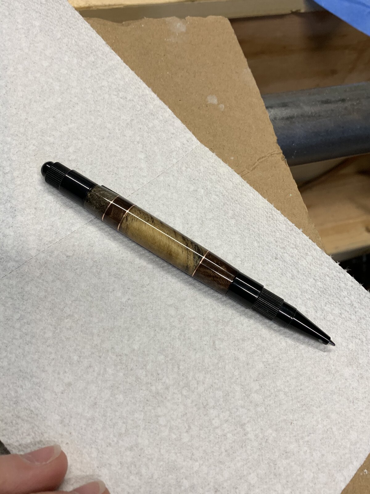

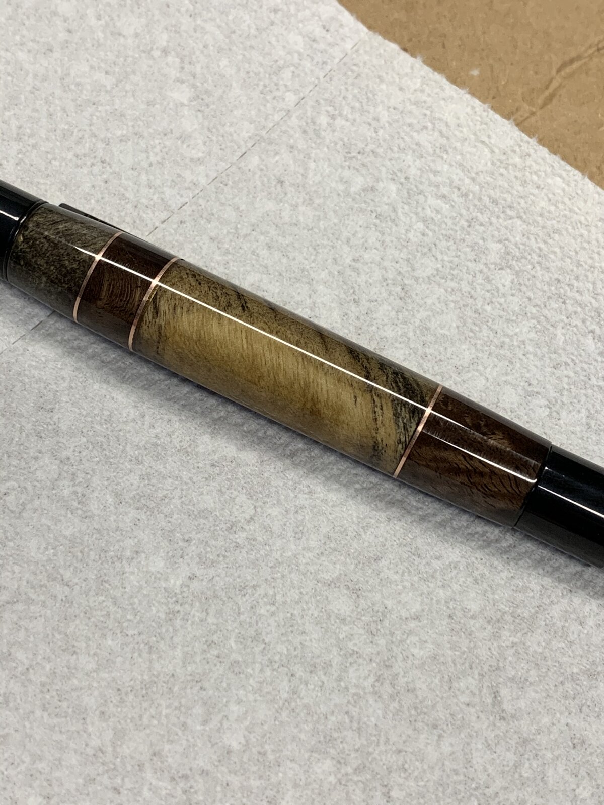

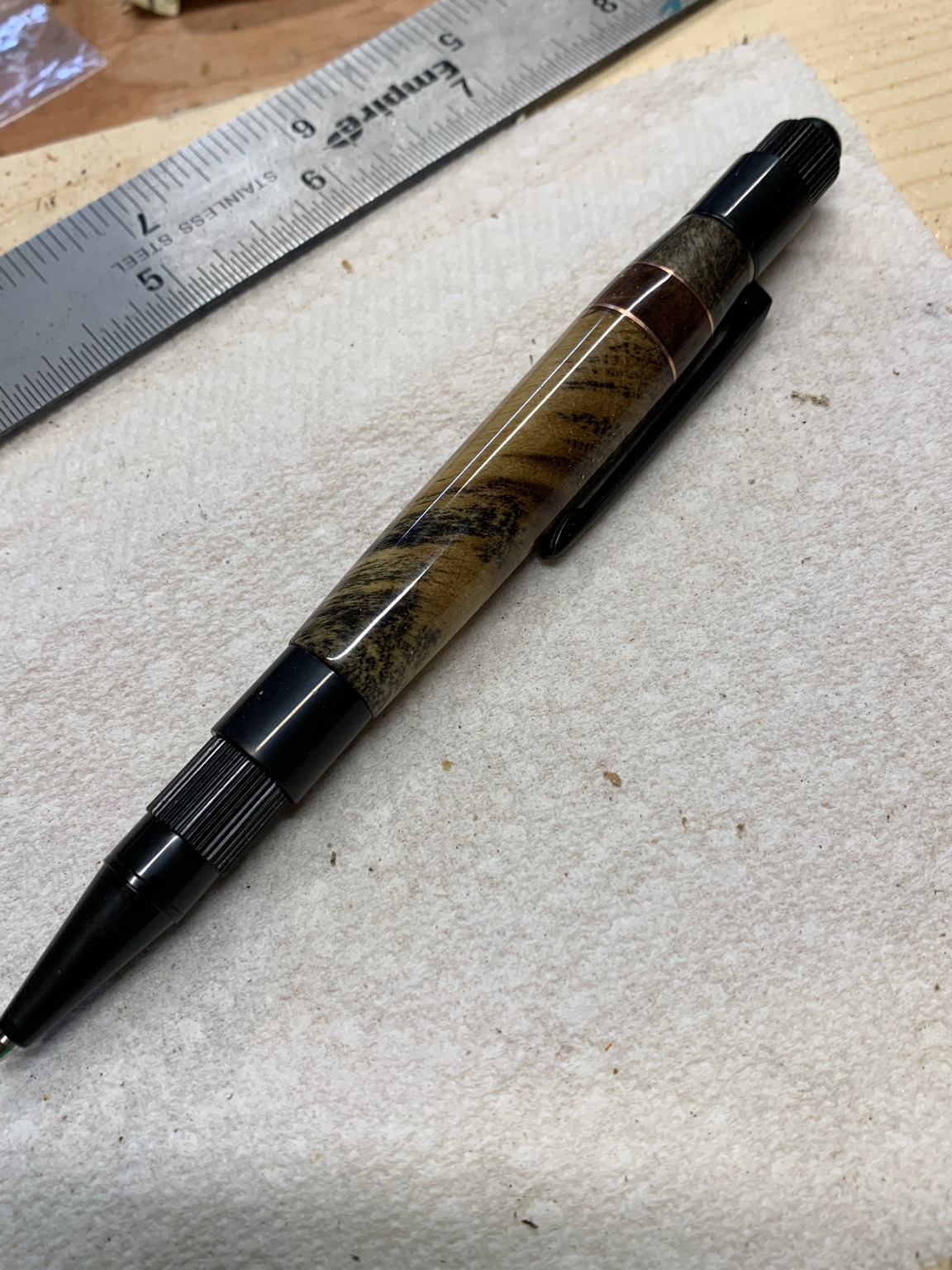

I was reading a thread on what to use between segments- CA or Epoxy. I really wanted to try something. Being 102 degrees outside... Well, it didn’t stop me.
I had asked an old friend if he preferred a click or twist pen (hoping he would go for a twist since I had more kits)! He said click of course. Most times he only has one hand free. He owns a restaurant and it makes sense.
So, I had two Stratus kits- one with a tube. I chose a nice buckeye burl chunk. As I was placing the tube in the CA bonded and 1/3 of the tube was sticking out. I move quickly during this process... but I’m sure the heat had something too do with it as well.

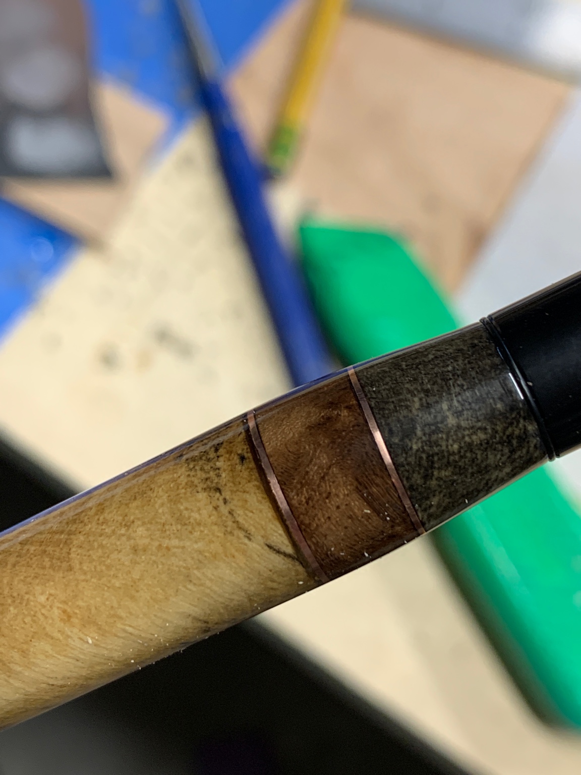

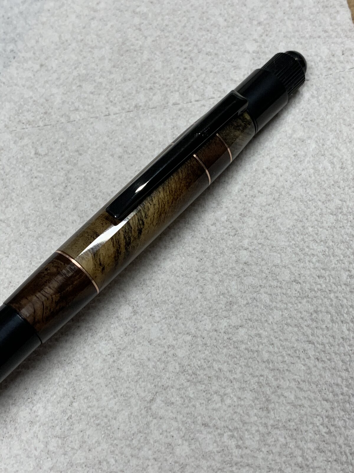

That’s when I thought about the thread and decided to make the pen segmented. Lemons into lemonade.
Needless to say... next time I use metal to wood I will try epoxy. (And a cooler day) More time, less rush. Less heat, better choices.

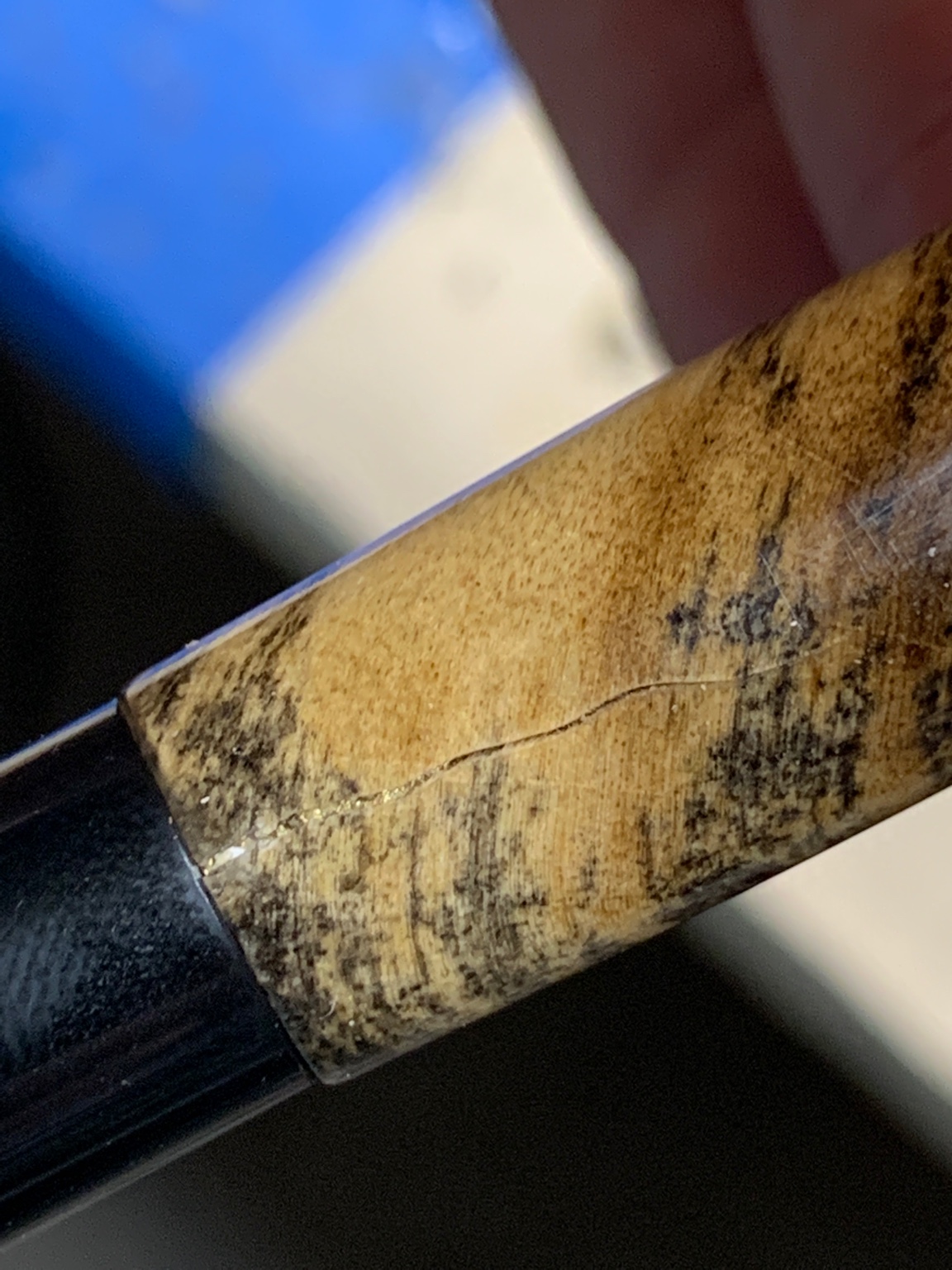

This pen ended up cracking by the nib because I wasn’t paying attention. I pressed it in crooked. It was my carelessness.
mark james
IAP Collection, Curator
Sep 6, 2012
10,087
Medina, Ohio
I have done the exact same things on a few occasions - both the tube glue-in issues as well as cracking the blank. I use a chamfering tool on both ends and then a metal tube cleaning brush and this helps. Also, some kits are simply too tight of a fit and I file some components for an easier fit.
However, I really like what you did with the segmenting. 👍 (My preference is epoxy for all tube glue ups).

Been there more times than I care to admit. Are you planning on saving it by replacing the cracked end with another segment? It certainly looks worth saving...

While at work I was thinking about. I could dismantle the pen and make a new segment. So, I may add one more copper ring and another piece of walnut burl

Thanks and you’re welcome! it’s a really nice pen. I ordered a assembly/disassembly press. So, I’ll segment the crack and make sure I’m paying attention!

Nice segmenting work. Have you considered Dremeling the crack and filling it with something? Copper perhaps, to pick up the bands of the segmenting? Lemonade from lemons?
