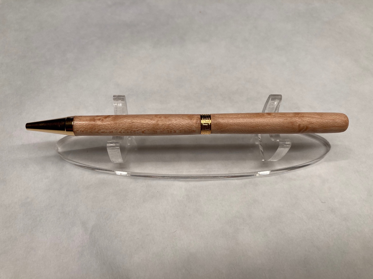

Experimenting with different style pens and finishes. I Picked up a couple of pin mandrels and made my first closed end pens. Three different finishes.

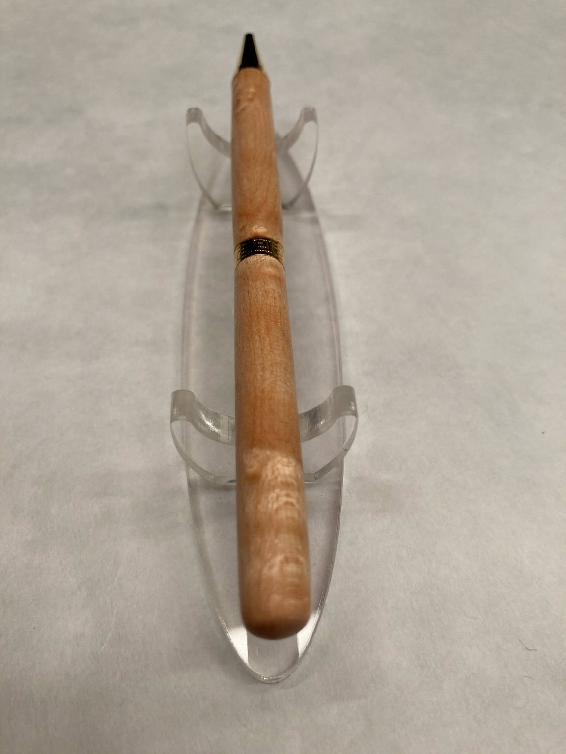

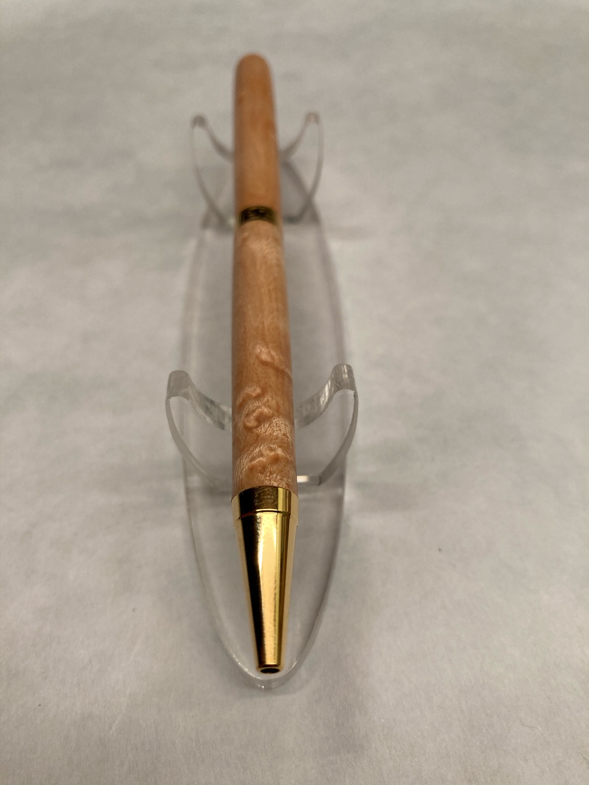

First is a slimline in birds eye maple. Finished with three coats of tru oil.

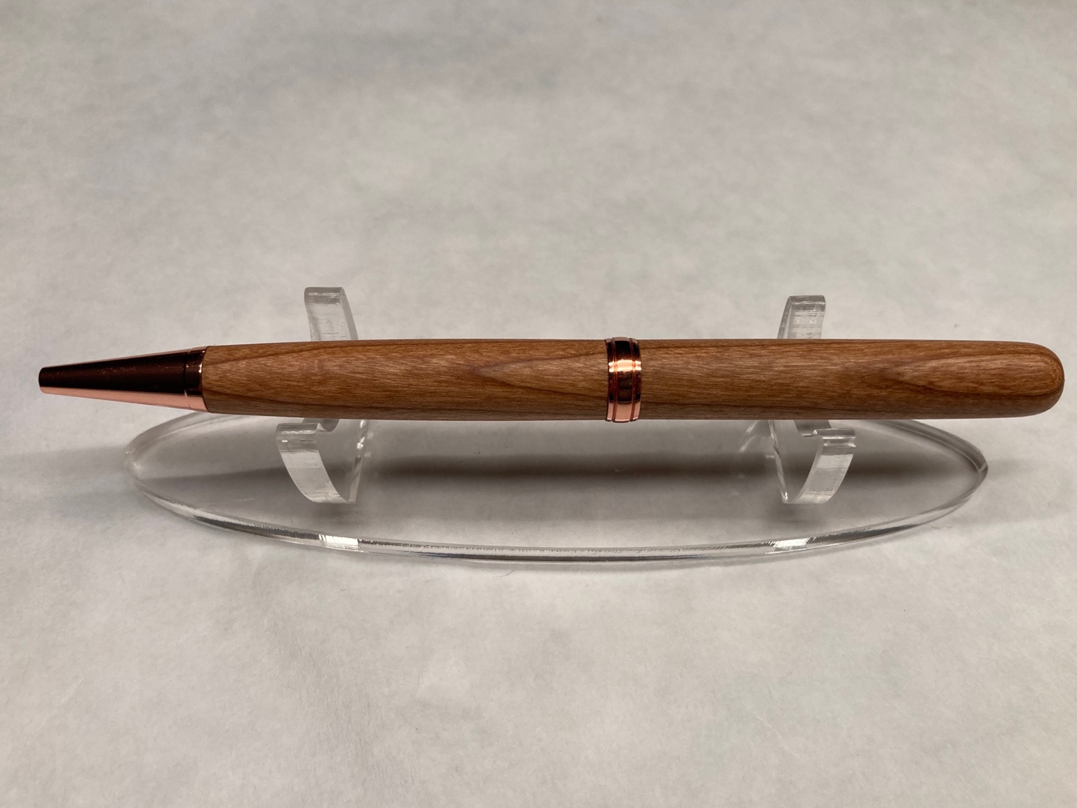

Second is a comfort kit in cherry. Finished with OB shine juice.

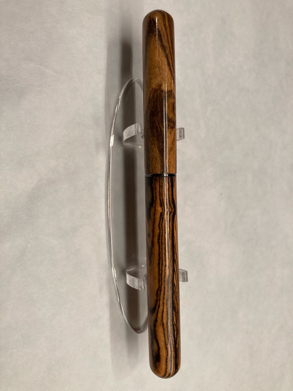

Third is a jr gent closed end pen kit. Dressed in bocote. And finished with glu boost. I struggled a bit with the finish on and near the ends. Sanded through and had to strip it and re finish.
