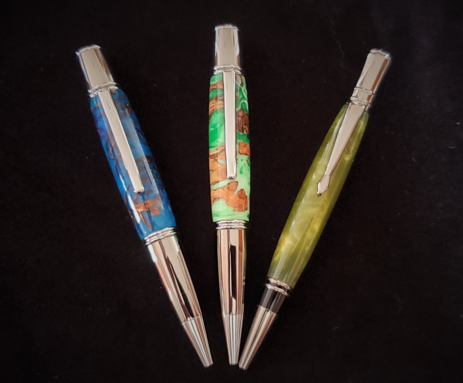

I never had a gal (or guy) want olive green (but Exotics had it and I made it - Rhino). The gatsby grandes (I was never a gatsby guy, but these grandes are meaty and I like the traditional transmission) were finished with Mercury Flex CA. The blue one looks cloudy; that is just my inability to take a decent picture :-).

I am guessing that is the equivalent to the Sierra Vista kit?? Looks like they turned out well and am sure they will be well received.
Thank you. I only heard heard of the Vista yesterday in one of your posts. This has a 3/8ths tube. I am not sure of the other similarities. I bought about 10 from Ed. I wish the more pens had more "meat".
