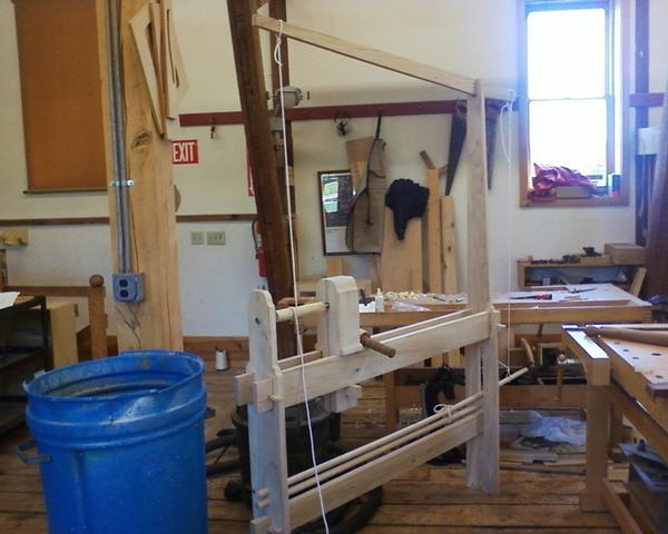

Hi guys, me, and my teacher Ernie have a 18th century turning shop set up at the local fair to educate the public on period wodworking.
I'm halfway through the fair and finally got some pics of our display and pole lathes.
This is me on my new pole lathe

WOW! That's really cool Evan! I would be interested in seeing the whole setup of that lathe... How does the shaft spin? I see a string wrapped around the stock and up then the same one running in front of you...
This would be interesting to see as I've never seen one before or how they turned back then...

well, it turns between 2 dead centers, and I have to either grease or wax them to reduce friction. it is powered by 2 spring poles mounted under the lathe which are attached to a walking beam overhead which holds one end of the cord you see in the pic. that cord is wrapped around the workpiece one to 3 times around the workpiece and runs to a treadle that is run by foot.
the pic shows the lathe before I finished the trestle feet and footrest

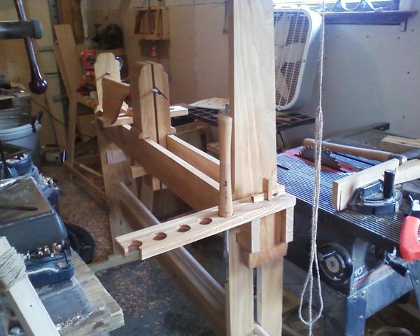

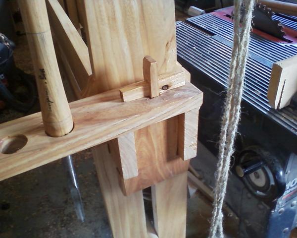

I just finished up an upgrade to the pole lathe. It's a tool rack that mounts to the tailstock end of the lathe with a wedge system that matches the rest of the lathe.
