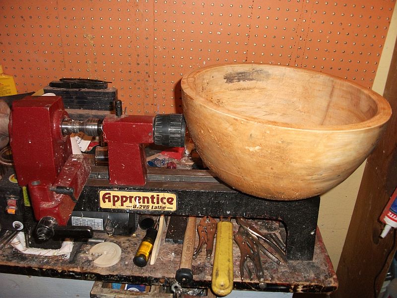

Hi fellas, I started today off with a nice big bowl ready for its second turning.After tureing it back up I proceeded to do a couple finishing passes with my big scraper.Fist couple went ok then BAM!After I got up I looked over the peice to see what happed.The piece sucked in my scraper,bound up and snapped the tenon.

Here is the culprit of todays action.

Well I was half right then. A conventional scraper will get you in trouble very quickly. I've seen people let the handle go below the cutting edge and get away with it, but only near the bottom. Near the rim is a danger zone with a conventional scraper, since it will self feed. I'd suggest only shear scraping or a negative rake scraper there. You need a poster on the wall, "I had been turning a bowl for quite a while, but I started to wonder why it was getting bigger? Then it hit me!"
