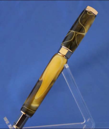

Sorry I did not explain this well. I will use a Qtip and from one end (generally the middles) paint the white and go about half way up the blank (maybe a little farther). Let that dry over night. Then from the other side I use black paint and go the white and over lap. I try not to be perfect because I don't want a line - more a vignette. Hope this help.
Here is a better shot of the pen from the video (sorry about the image quality - screen snapshot). Black on the outside end white in the middle. The blank is a generic yellow blank.
Here is a shot from the video of the original blank ...
