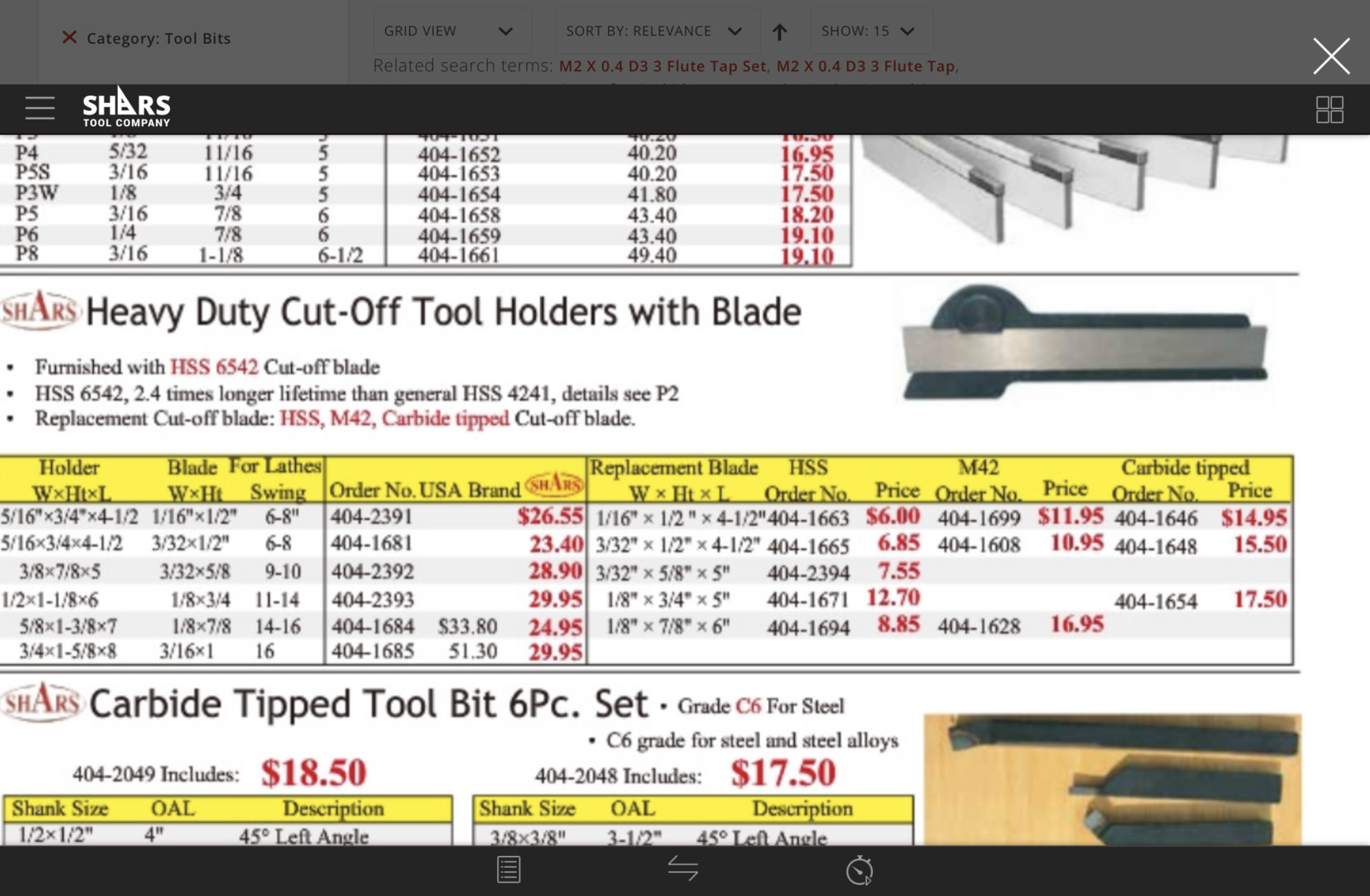

Shars tools has a carbide tipped blade. Make your own holder. Page 68 in on line catalogue. Part 404-1646. Shars.com

Thanks Bill and Bruce I may look into this. I always can make a holder. That is not a problem. Just would have to see how the angle can be used as a parting tool
