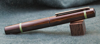

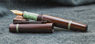

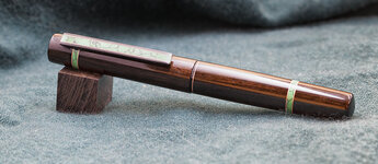

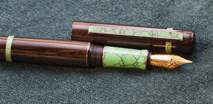

Here are the pictures for my entry to the Bash kitless entry this year.
For this fountain pen, I used some ebony for the body and cap (I thought it was Indian ebony but looking at the color it might be mun ebony), ebonite for the threaded bits. trustone variscite for the section and inserts, and 32 gauge copper for the various inlays. The parts I didn't make are the nib triplet (Jowo#6 gold plated). The finish is Gluboost CA. The threads are M13x0.8 triple start for the cap/body and M10x1 for the body/section.

It's a beautiful pen Fred. Care to tell us about the clip?
The clip was built with a similar approach as in my Summer Extravaganza entry last August. The band is part of the cap from the beginning, it gets turned and polished with the rest of the cap. Then drill a mortise (about the width of the clip) in which I will glue the clip's tenon. The clip started as a 6x6mm piece of ebony and I dug a 3x3mm groove in the center of one of the face (in this case the grove was the full-length of the clip). In this groove, I glued in a baguette of the variscite surrounded by copper. Once the glue had set for a while, the clip gets shaped by cutting away the "excess" ebony (bandsaw, scraper, file, sandpaper,..) and leaving a tenon at the place where it will be glued to the clip. More fine sanding, Glueboost finish, repeat, until it looks good enough to me. Initially, that tenon is about 4mm and is used to hold the piece while shaping it, and gets sanded to about 1.5mm before gluing it in the mortise. The last thing I did before gluing it was to build a small dome at the other end of the clip (using UV-cured resin) to match the height of the clip. Does that make sense? I didn't take pictures of this one but I have other prototypes I can take pictures of.
