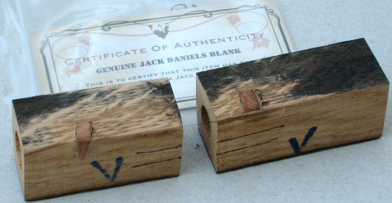

Hi all, I just got around to having a look at starting a JD pen, when drilling the blanks I noticed some lumps under the charcoal and crud coating.

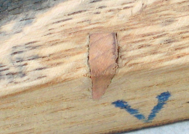

I sanded them back a bit and these were revealed. They seem to be on the surface that would have been the outside of the keg.
Do they use wooden nails to hold the hoops in place maybe ?

I think, it is a defect of barrel's staves. There was a knot in wood, barrel makers cut if off an replace with plug.
You may leave it as "charming detail".

I will soak with CA as I am turning, to help the wedges stay in place, they will make a nice feature I hope.

I knocked apart a French wine barrel a couple years ago and there were pegs driven through the top and bottom edges into the staves. There may have been some between the pieces of the tops and bottoms too, to keep them aligned but I can't remember for sure. The hoops were held with short "T" nails driven with nail gun of some kind through the hoops. Hard to pull out. There are going to be variations in the construction from place to place and at various times so the barrel your blanks came from will be different than the one I have.

If the plugs are under the charcoal, they were on the inside of the keg. The inside of the barrel is what gets fired to produce the chared effect.
Barrel makers cut out knots and bark inclussions and replace with hardwood wedges. Bark or knots could effect the flavor of the contents. Plus, the wedge insures the barrel will not leak through the old knot hole. The wedge is driven in tight, then the curve of the stave once the barrel is made makes the wedge an even tighter fit.

Thanks for the responces Guys, so the mystery is solved for me, wedges to fill knotholes and bark inclusions.
I thought they were on the outer face, due to being on the outside of the curve. There seemed to be charred bits on both faces, so I am not real sure on that.
These blanks also came from Timberbits.
