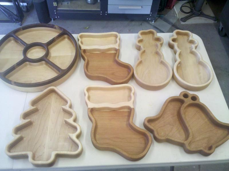

Here is a sample of some of the 18 candy or chip trays I made (well still working on the last 3) for Christmas presents this year.
Next year I hope to be good enough with the pens, i'll give pens, and boxes. But I think I'm going to start in July. :wink:

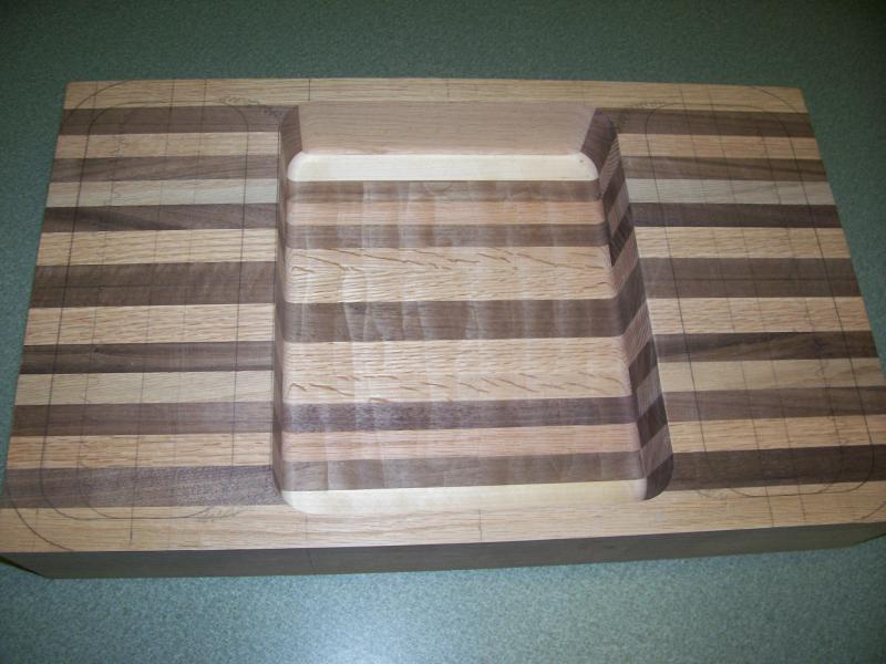

I wish I knew how you made those - they're amazing!
Thanks:
I glue up the blanks with what ever wood they are going to be made of, and use router templates to cut the inside first I hog most of the material out with a forstner bit, then use my router with a bowl bit and finish the inside, then scribe the outside shape, band saw the outside, and sand with spindle sander. Then route the radius on the top and botom edges with the router table then finish sand. I use walnut oil, and wax for the finish.

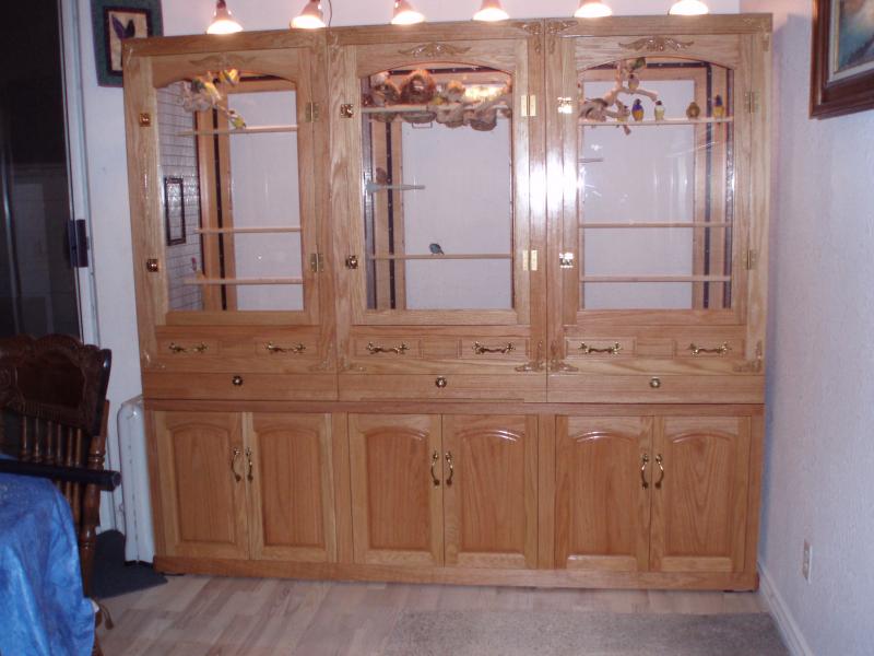

Another project
This is the project that got me started in woodworking about four years ago. My wife raises and breeds Finches, and she wanted a cage that looked like it belonged in the house, so this is what I made her.
I had never done raised panel doors before, or anything big out of wood, this took a couple of years to finish, as I did it all in my spare time while working a full time job, I did all the metal work myself, (retired tool & die maker) made the frames for the wire mesh from scratch, etc. The unit has three seperate cages; wire mesh on the sides top and bottom, and acrylic on front and back doors.

Nice. Did you make the templates yourself or is there somewhere with an assortment of them?

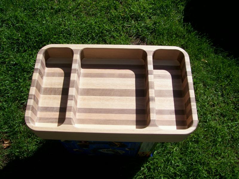

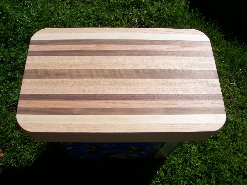

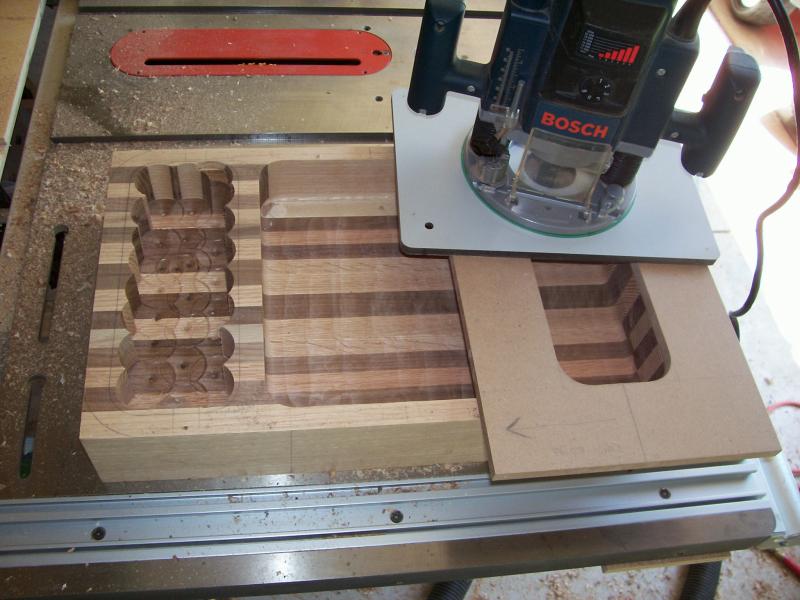

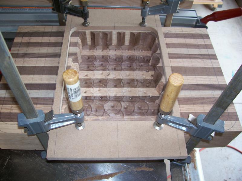

CHICAGOHAND
Apr 1, 2007
350
SUGAR GROVE, ILLINOIS, USA.
Nice work. I have used the same system. The only dislike is the sanding on the inside.
Anyone have any tips????????

JD99-
Can you tell me where you got the patterns for the Xmas pieces?
Thanks
I ordered them from Eagle, I now have them all except the santa hat, I also have the regular round set (chip tray), and the heart set for Val. Day.
I started with the set from CMT, but I like the ones from Eagle because they are acrylic, and I can use double sided tape, when I used the double sided tape on the mdf ones from CMT, it started tearing the mdf up with every use. The acrylic doesn't have that issue.

How are you dealing with sanding the inside???
It's a Pain in the A... the bottoms I sand with the 2" daisy edge sanding disc, and a 1" disc, the sides Inside & Out I sand by hand, and the bottom is normal sanding.
The trick is to use a good sharp bowl bit and keep it moving so you don't burn the wood; then there is less sanding, I'm on my second set of bits.
I use both the 3/4" and the 1 1/4" the only thing with the 3/4" is you can't use the bit extension because it's biger then the bit (I just kept sticking the bit out further and be careful).
If you do the tree you will need to use the 3/4" bit the 1 1/4" is a bit too much for the tight radiuses; it will work but it's white knuckle routing. :eek:
