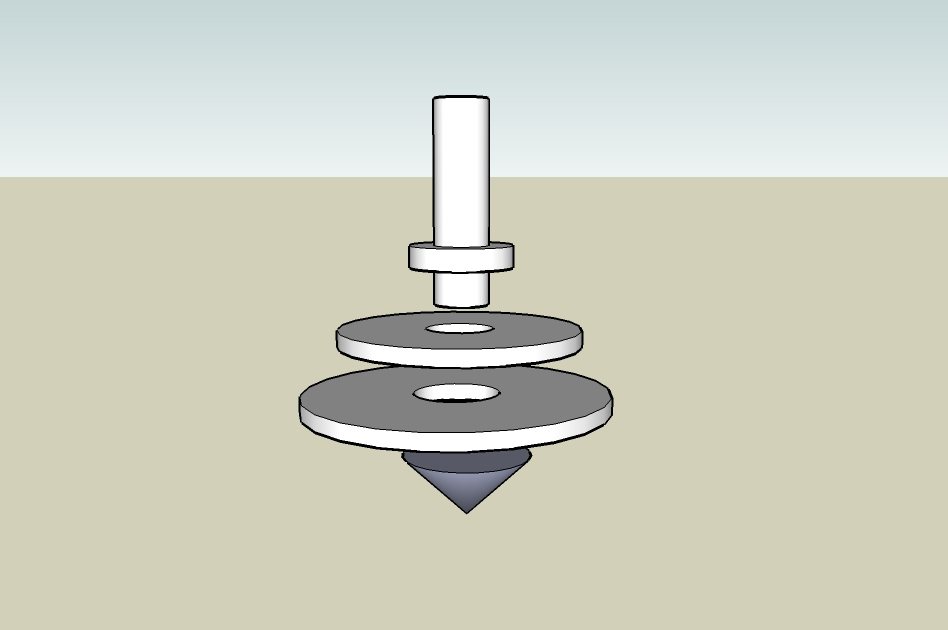

I am thinking a finial with a wider area near the bottom that has one insert, a point that has the other, and a couple concentric rings for the flywheel portion of the top. A very rough sketch is below.
