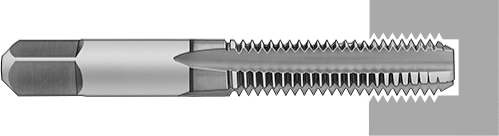

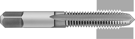

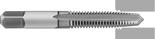

Is there anything way to determine the double and triple leads if not obviously stamped on the tap or die? Is there a way to determine whether the tap is a Norma, bottoming, or starting?

From the McMaster-Carr web site:
starter.png starter tap
through.png through or normal tap
bottoming.png bottoming tap
Not sure about how to distinguish a double or triple start.

Here it is:
http://www.newmantools.com/taps/taptech.htm
[FONT=HELVETICA, VERDANA, ARIAL][SIZE=-1]The kind of hole to be tapped has much to do with the style of tap that's best suited. Some holes go all the way through. Others, while not throughholes, still are relatively deep. Some are quite shallow, little deeper than diameter. Each of these three kinds of holes through, deep-bottoming blind, and shallow bottoming, has a tap or group of taps best suited to requirements.
Taper Taps have 7 to 10 thread chamfers to distribute cutting action over many teeth and the taper also acts as a guide in starting.
Plug Taps, with a chamfer over four threads, is most widely used in through holes and where there is sufficient room at the bottom in blind holes.
Bottoming Taps are made with just enough chamfer for starting in the hole, only 1 to 2 half threads. As the name implies, it is designed to thread blind holes to the bottom.
And also Wikipedia:
[/SIZE][/FONT]
Bottoming tap or plug tap. The tap illustrated in the top of the image has a continuous cutting edge with almost no taper — between 1 and 1.5 threads of taper is typical. This feature enables a bottoming tap to cut threads to the bottom of a blind hole.
Tap and die - Wikipedia, the free encyclopedia
https://en.wikipedia.org/wiki/Tap_and_die
