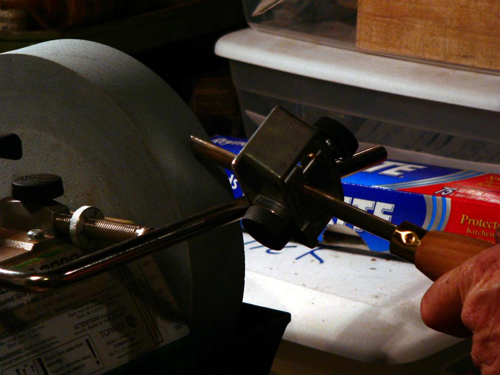

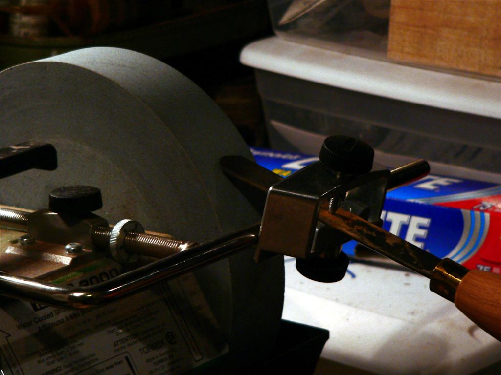

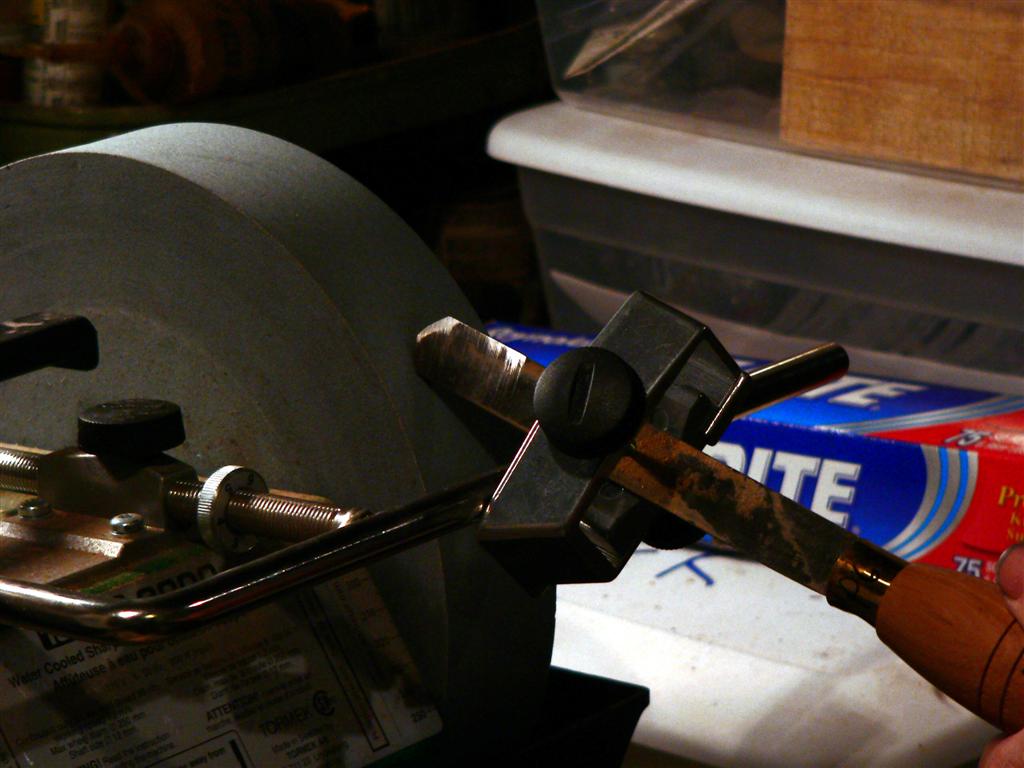

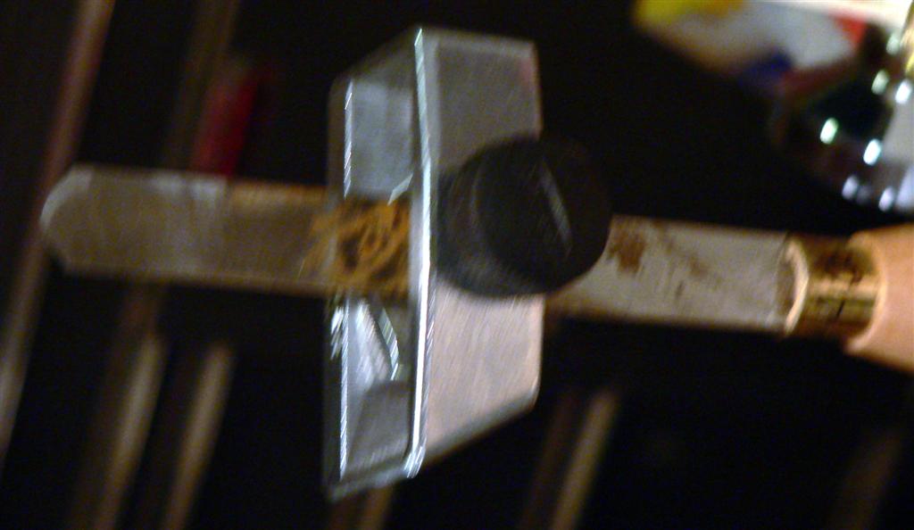

OK here are the pics to help explain
Here is the spindle master in the jig(sorry for the blurry photo)
Next at the grinder
Left
Right
I hope that clears up what I was trying to describe.
BTW my spindlemaster is not rusty, it just has wood dust all over it from the bowls I was turning earlier. [:I]
