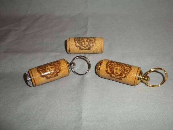

I was messing around with another project on my incredibly unorganized workbench and corks from that project walked across the bench and sat down next to some Pill Holder Keychains (CSUSA Deluxe Pill Holder - Woodturners Catalog - Woodworking tools and supplies specializing in woodturning. )
the wandering corks are an almost exact fit for the tubes on this kit! Drill, ease the corners, CA finish, press and done. I bought a box of corks on Ebay, culled it for ones with cool designs/pictures, then sold the remainder on Ebay for what I paid!
I now keep a tray of these near the register in my booth and can't keep them in stock at $30 a pop. If you do wine shows, these absolutely kill.
Kits with group buy, approx $4; cork, about $0.10; total time, 15 minutes?.... works on just about any business model! (even if you buy the whole bottle of "Two Buck Chuck", your cost is only about $6!, and you have an excuse to drink more wine!)

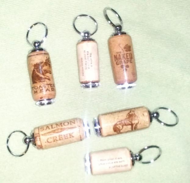

got a little time to make a few more
latest batch.... the ones you can't read are quotes from philosophers about wine (unknown Portuguese winery) one side has the quote in Portuguese, English on the opposite. Just an idea of what kinds of corks are available!

They look great Jon!
I tried a few myself over the weekend using corks from some of the local NY wineries. The people I have showed them to think they are great! Thanks for the great tip!

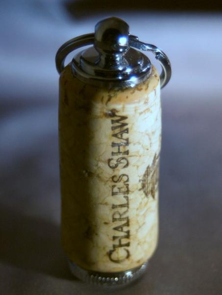

Well Jon,
I did have a box of wine corks and I was wondering what I could do with them. Saw this post and said HEY! I have some of the key rings too! Out to the garage I go and start rummaging through my stash and an hour later TA DA!
I chucked them up in my Barracuda 4 jaw and drilled them with a forstner bit.
Made a nice true hole snug enough I almost didn't need to glue the tubes.
Thanks for rattling my marbles and showing me a really cool idea. These will make awesome gifts for my friends and family wine drinkers.
