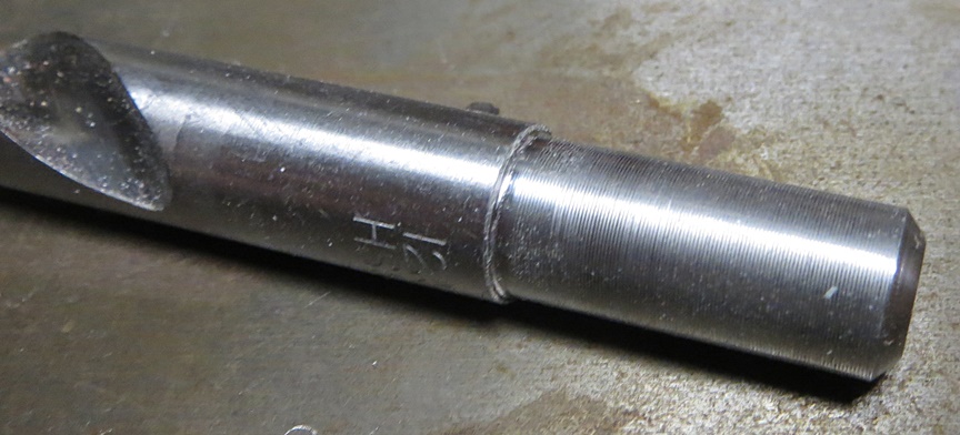

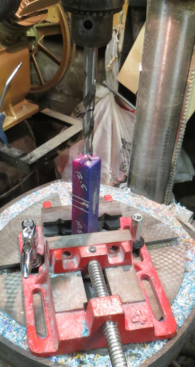

I'm having a weird problem with one drill bit. The chuck keeps loosening when I use it. It's a 12.5mm brad point bit, reduced shank. I'm using it in a full size drill press with a 5/8" chuck, tightened with a key. This morning I had to tighten it several times as I drilled 2" into an acrylic blank. This doesn't happen with any other bits, not even a 9/16" brad point, or a 10.5mm bit from the same manufacturer. Any ideas?

Jim that is a stepped collar on there so you need to be sure that the quill is locking down on the thinner section all the way. Also whenever using a keyed chuck and this is an old timer's trick, always tighten down on at least 2 positions on the chuck. This ensures it locks squarely. This goes for drills drill presses chucks on the lathe and so forth. That has stuck with me throughout my career in the electrical field where we use all kinds of drill motors and devices that require keys.
I would also check that the bit is straight. There maybe a bend in there and the whipping action is causing the loosening.

Make sure the chuck jaws are not touching the shoulder on the drill bit as you tighten. Keep a small gap between the shoulder and the jaws so the shoulder doesn't prevent you getting the bit fully tightened.

I've never heard of tightening the chuck in each of the three holes, but I'll try that next time. I also measured the shank to make sure it's not tapered. Right at the shoulder, it measures 0.437". But right above that, and all the way to the end of the cut down shank, it measures 0.434". Next time, I'll make sure to leave a gap between the shoulder and shank when I chuck it up.

That's most likely your problem. It should be perfectly straight. Rather than having contact the whole length of the chuck you're really only clamping onto the drill in one spot, at the .437". Drill is probably running out as well.
I've drilled 10s of thousands of holes and dealt with countless problems. (21 years as a machinist)
I'd get a new drill and try it out. At work if I saw a shank with a finish like that I'd chuck it into the trash and get a new one.
