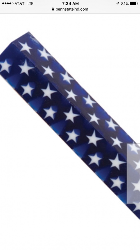

To anyone who has used these blanks, just wondering what is the best color to reverse paint the blank with? Thanks for any suggestions.

Mine were not opaque and I made a cigar pen (s), I used light blue. Maybe yours are more opaque.

done several, depends on how much meat is left between the blank and tube..if you're using a tube..match them up with the red/white blanks
I have not had any problem with it being plenty opaque. But as a rule, I do paint the tubes white..imo helps the stars stay bright, just in case.

Have you tried PSI. Aside from star blanks they have star inlay kits.
I have had star blanks that were dark and worked out fine. Others were light and the tube/glue showed through. I wanted to trash them.

I have turned a number of these blanks. I use a dark blue testers paint. That most closely matches the color of the blue in the blank. It has never had an effect on the stars and turned out great each time. Just my 2 cents.
