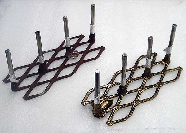

Also be sure that you have good contact between the casing and the rack you hang them on. The better the contact, the better the charge. The better the charge, the better the coverage of powder. Below is a picture a just a couple racks I've built. As you can see I use aluminum foil at the bottom so the neck of the casing slips down over a taper so as to act as a plug and to help with electrical contact. I also drape a small piece of foil over the top of the post so that the drilled primer end will also be plugged and have added contact. Down fall to the foil as opposed to silicone tape or plugs is that sometimes it gets pc'ed to the casing but does come off easily. I periodically have to to clean/gring an area for the charging clamp.

I am still working on build my racks that's one of the things I am working on today. I am thinking that Wet Black and Chrome are going to be the two coatings I am going to use. Is that 1/4 rod that you are useing???

Yes, 1/4" rod. Some stainless, some cold rolled. Hot rolled expanded for the bottoms. Look around for chrome powder. Most fall pc's short and look a bit on the faux side. I will be brush plating in a few months as part of a Goldwing restoration/rebuild I'm doing. Figured I'd try some casings then, both regular and black.

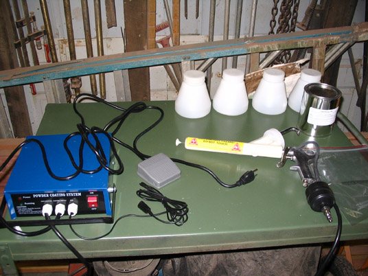

My system is here-----I still need some stuff from town but it's getting closer---I am going to build a small shoting area just for casings---I am thinking---Big cardboard box to contain the overspray.

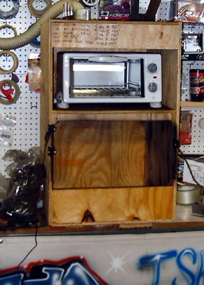

Here is mine. What you don't see on the back side is the evac fan from a power vent furnace to get rid of any vapors coming out of the oven during baking. Vented outside.
