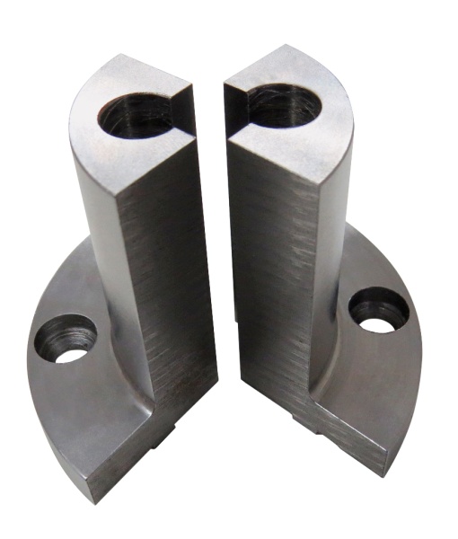

Nova Pen Plus Jaws
LagniappeRob
May 29, 2012
866
New Orleans, LA
Added smaller image as an attachment, the one from their website was huge

Just a couple of cautionary notes:
1. They are made to fit on the tek-na-tools chucks, Supernova and G-3. There is a ridge line that runs around the jaw plate that makes the fit on other chucks problematic.
2. Note that there is only one hole in the jaws for the screw. The Nova chucks all are made to accomodate two screws per jaw. This introduces a potential problem with securely holding the jaws to the chuck.
3. the length of the jaws (necessary to accomodate the pen blank), combined with the single screw hole can intoduce some issues when drilling. Mainly, not a secure enough hold on the blank, which can make your holes less precise than you generally want.
All in, these issues can be overcome, but wanted you to know some things to watch for.
LagniappeRob
May 29, 2012
866
New Orleans, LA
Marc,
Do you have a set? Are these cautions from experience? #1 is obvious and stated on the page.
For 2/3 (really the same issue): There's no picture of it straight on, so I was curious if it was 2 or 4 screw holes as well. I have mine in hand tomorrow. I have another Nova chuck with only 2 holes but the jaws are in the way on that one. This one the 3rd and 4th holes should be pretty close to where the long round hole in the jaws are - so I wondered if they aren't there. I specifically went looking for a straight on picture of one and couldn't find one. That said, my existing 2 screw jaws hold fine but aren't this long.
EDIT - Just called Nova to ask. These jaws have 2 screws EACH - 4 screws total. The long hole down the jaw is for the 2nd screw in each jaw. So 2 & 3 are non-issues.

From their site...
Key Points: The latest Chuck accessory from NOVA, under limited edition BETA release pending a full release later in the year. Stocks are strictly limited for this BETA release, with only 80 jaws available, first come, first served. This jaw set will fit on any NOVA chuck. A test report is included with every jaw to get customer feedback. The normal full two year warranty still applies to this BETA release.

Wow, did I screw that up. Nova also makes a pin jaw set (JSPIN) that has the one screw per jaw and will fit any Nova chuck. The pen jaw set is as you described.
There may still be issues with the pen jaws not fitting other chucks.
I wondered what that strange hole was for, at the top end of the jaws...! :rolleyes: It is for the second machine screw. I guess you install the screw by reaching down through this hole, with a long Allan key.
I have the pin jaw set, and it works fine for drilling blanks. If I didn't already have it, I'd definately buy this new set.

I don't know if I'd saw "fine". It works ok - usually. A few times I've taken as long or longer to setup drilling long holes (like realistic cigars). I have the PSI for pen blanks, and it did well for a while but one of the jaws has taken a lean to the outside. I haven't taken it apart to see what's going on. Looking at these I think these will be my go to (hopefully).
Yes, I'd agree with that, Rob.
I've learned that when drilling in the NOVA pin jaws, the blank must be either perfectly square or round along its length. I typically round them, before drilling. The more 'unsquare' or 'unround' the blank is, the more likely that it may not be turning 'true' in the pin jaws. In other words, the ends of the blank may be turning in a small oval, and will cause 'wobble' on the bit as it advances into the end.
When you get it right, it drills perfectly smoothly. If the blank is not true, and improperly locked in the jaws, you get wobble. (This may also be the case with this new jaw set.)
You mean jaws like this?
Single screws combined with the quarter circle arch on the bottom of the jaw holds it in place fairly well. The only movement you will have is rotational and that depends on what you are drilling.

My set shipped out on Thursday. I think these will be a great addition to my pin jaw set. I have had a few times that I wished that I had only the 2 points of hit. Mostly with a blank that is not square. These jaws will fix that issue.

I've Had a set of these for over a year now, they are good for drilling to fit tubes but needs to have a good square blank otherswise hole is not centred correctly. I believe they fit all technatool chucks, certainly the Nova, Supernova and G3, they also fit Sorby's patriot chuck. I use for holding 95% of square blanks and keep mine permanently attached to a G3, I would say a worthwhile investment at £25:00.
