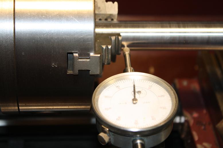

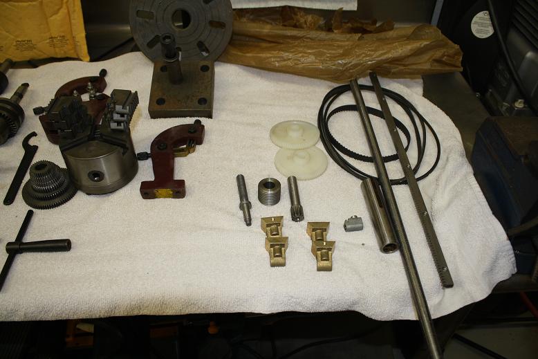

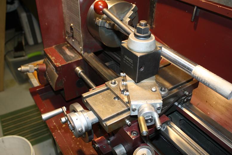

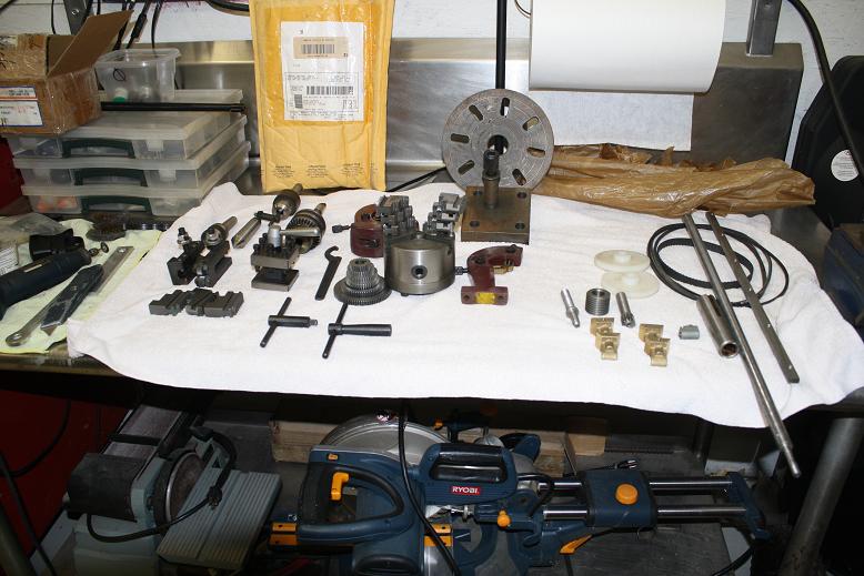

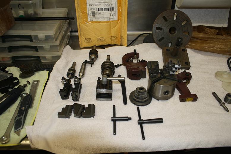

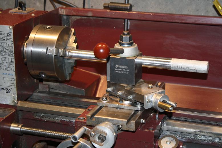

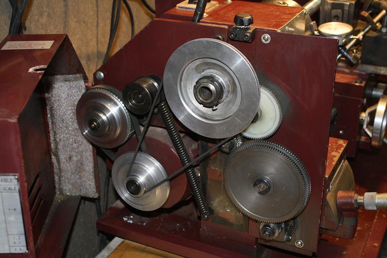

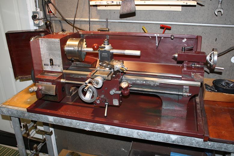

pictures of the lathe. I would really like to know from you metal lathe guru's whether or not this is a good deal. Also, here is part of the email sent from the guy describing the details.

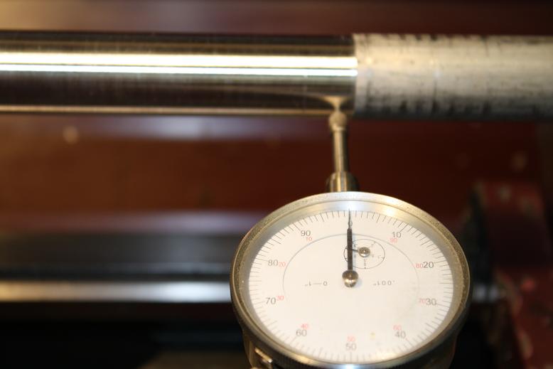

"On the ones with the dial indicator I used a know true bar about 14 in long and chucked it up without any special care. As you can see from one end to the other it is almost dead nut.
The parts on the right of the one picture are all new spare parts that I bought when I bought the lathe. I have never had to replace anything but the Half nuts as the original ones were pot metal. I thought the replacements would be too so I ordered three sets but I bought them from Jet and they were bronze. Haven't had to replace them again but they are there if you would ever need them.

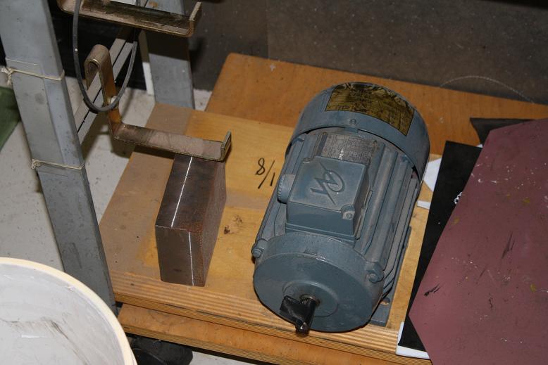

HF sent me a new motor as the one that came with it growled when I first turned it on. When I went to install it I found a loose wire on the start cap and it ran fine after I crimped it back on and has ever since but there again it's there if you would ever need it.
The bench is homemade but very sturdy. "

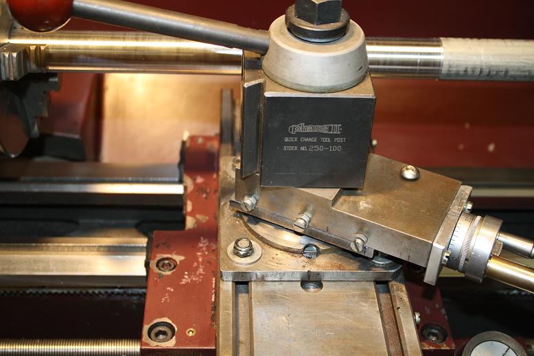

I will add to the discussion that these lathes from HF, Grizzly, need some touch-ups and enhancements to improve the rigidity, accuracy, and quality of the lathe. The scraping normally needs to be done. This is the difference between a lathe under $1000, and a lathe that sells for $10,000. The Quick Change Tool Post makes it a breeze to adjust the tool height. He has added a four screw mounting plate for the compound. This makes the compound more rigid and is a must-do for 9x20 lathes.

Seamus, I have the Jet version SAME lathe, mine was used when I got it 10 years ago and was about 5 or 6 years old and you can not believe what I put that thing through I replaced the headstock bearings 2 years ago.
Hard to believe the stress that turning Square Stainless Steel does to stuff, I've used Harbor Freight parts to replace stuff like gibs, cross slide screws, and lead screw . trust me the Harbor freight 9x20 is same machine as the 1800.00 Jet BN 920. The stand for either one is a piece of crap though , Build a Strong bench, the only weak thing on it is threading, it's a pain in the bum. Really if the guy has done the work he says, it's a heck of a buy. also the Phase II QCTP is way stronger than the one from A2Z, I know Tim Goldstein and his stuff for Sherline equipment is first rate, but his piston driven tool post is just a little bit weak.

My bigest problem is, if i'm gonna make this kind of investment in a lathe, i dont want to find out down the road that i should have gone with something different, or worst, learn that i should have spent an extra hundred dollar bill and bought "x" lathe instead

3) his runout "demonstration" with a 14 inch bar stuck in a three jaw scroll chuck with built-in factory spindle runout probably greater that what he's "demonstrating" is ridiculous. Since you can't improve runout what's important is parallelism of the spindle axis to the saddle bed ways and he did not demonstrate that.

bitshird and randyrls made related comments about what the guy said he did and how well he did it. I'd visit the guy and take your own prüfdorn and dial indicator showing tenths and check it out. It may purr at you.
