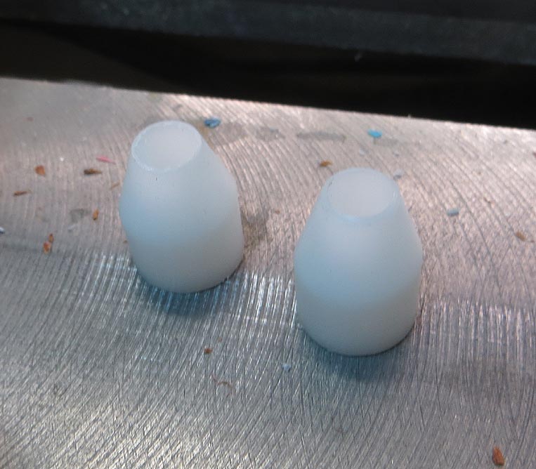

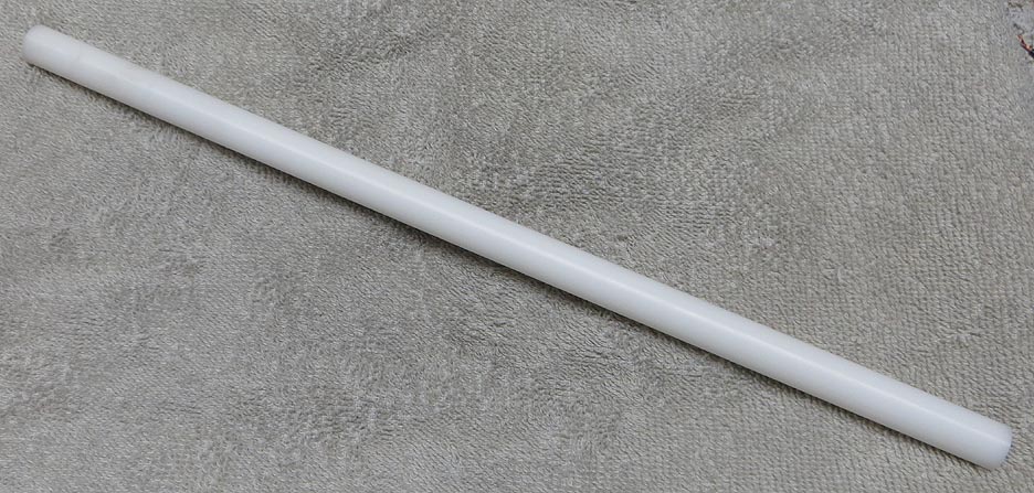

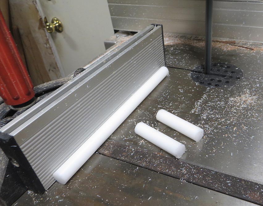

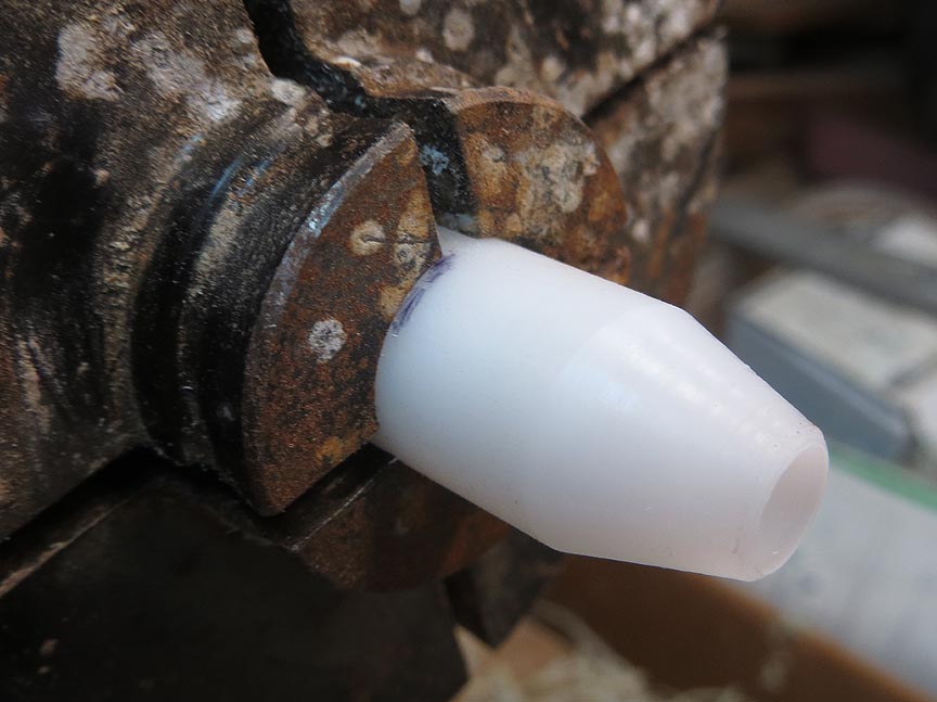

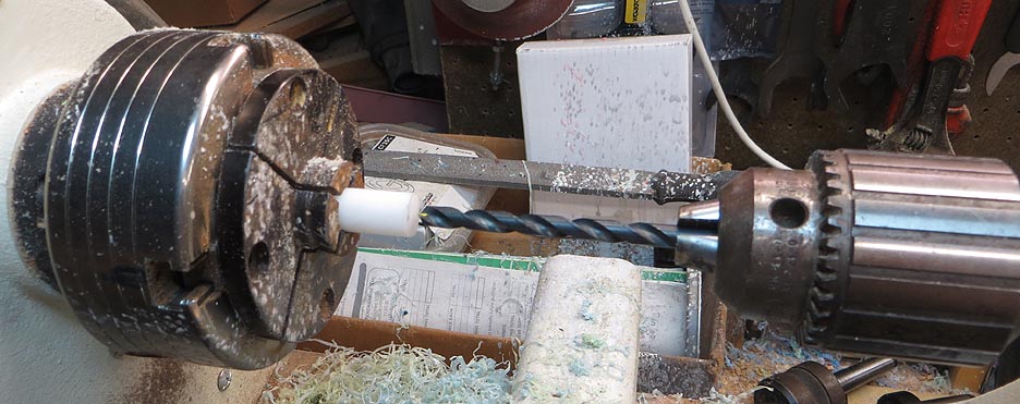

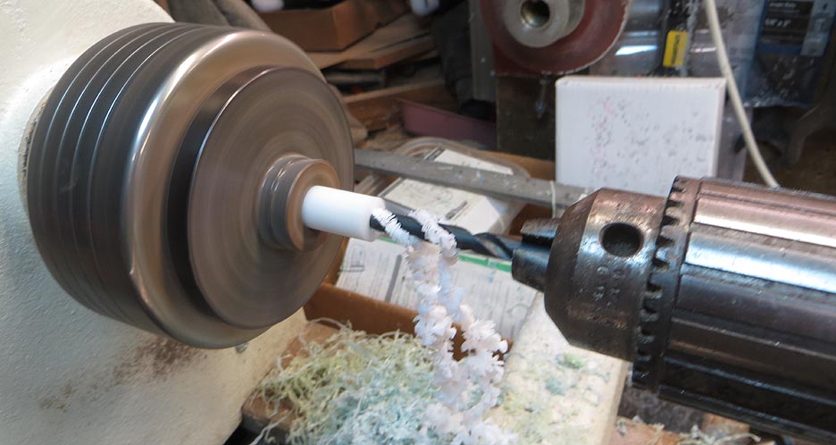

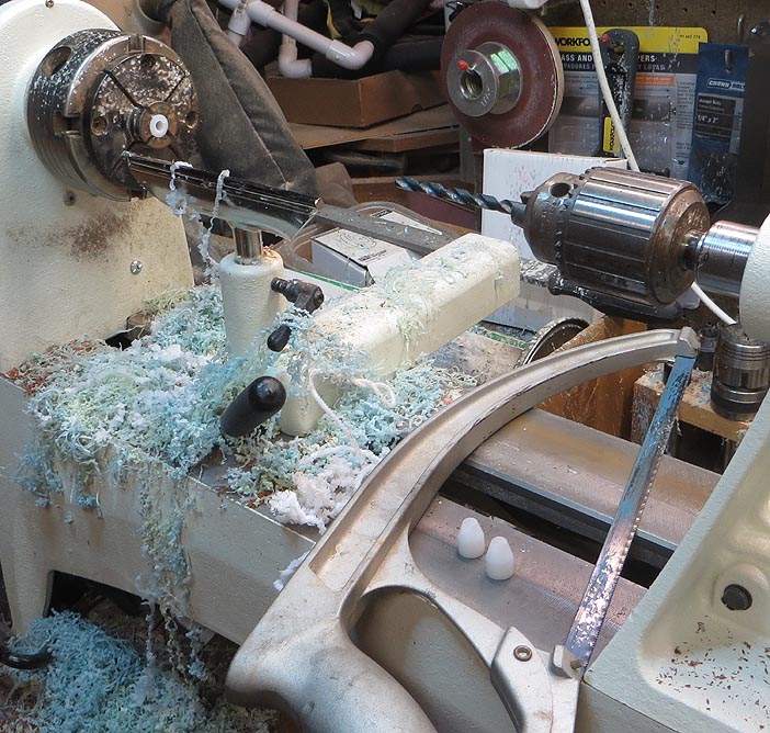

I want to try CA finishes, but was afraid of the bushings getting glued to the blank. So I decided to make some Delrin bushings. I got a piece of 1/2" Delrin rod from my local plastics supplier. Mounting pieces of the rod in a chuck, I drilled them through with a letter D drill bit. Then cut a taper with a skew, and cut them off. I think they're going to work well.

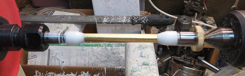

Actually, I will be using these with a mandrel.

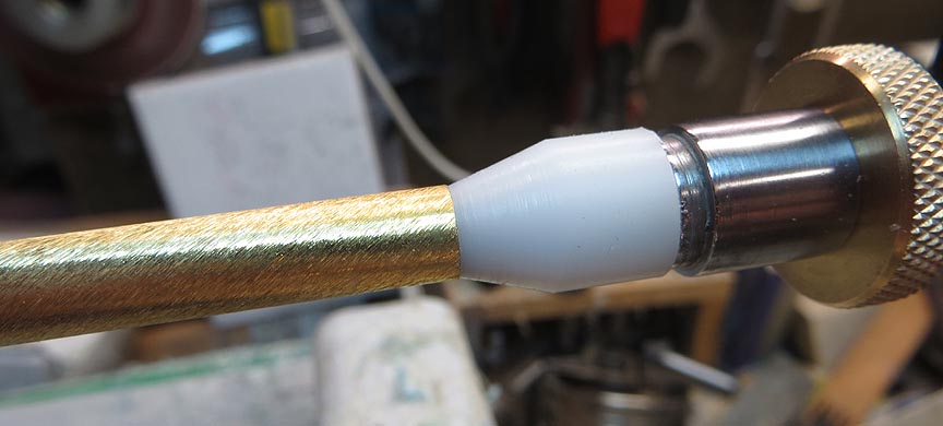

Skie, you're slipping buddy, the brass nut was the mandrel giveaway. I'm not sure what that bushing is on the tailstock side though.

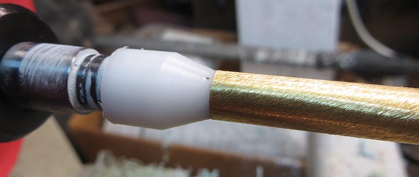

Mmmm ... perhaps that's true, I didn't look at the pictures closely enough ...
The title said TBC bushings, though, so I assumed he actually meant Turn Between Centers.
