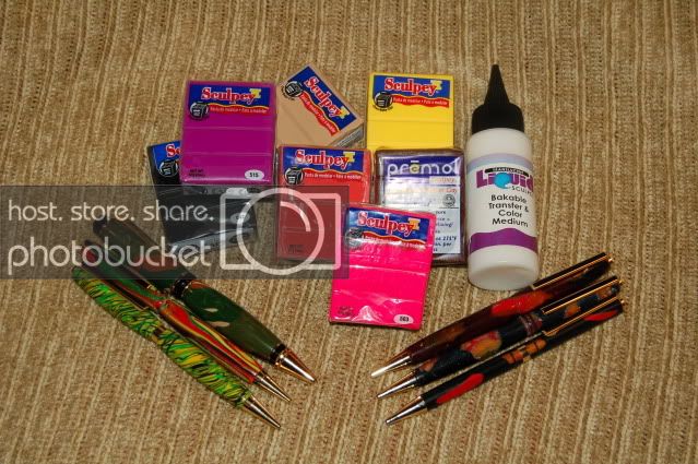

Hi guys I heard alot about pens from poly so i thought i would give it a try...wow nice easy media to work with I am sold....Took a short drive to michaels today and they had all 2 oz makes on for 2 for $4.00, I thought that was not to bad when it is hard to find aroud here... I used a full block of yellow and a quarter block of black and was able to make 6 half blanks...thanx for the view..

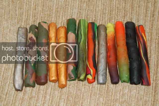

Skeeter -- great start! Zander --here's the basic product used for polymer clay pens. All of these products are from Michaels (I used to teach painting classes there). Sculpey and Premo both work fine, I just wouldn't recommend mixing brands on the same project as they can have different baking temperatures and turn slightly differently on the lathe. You won't need the liquid Sculpey as I was just playing with that for some image application projects.

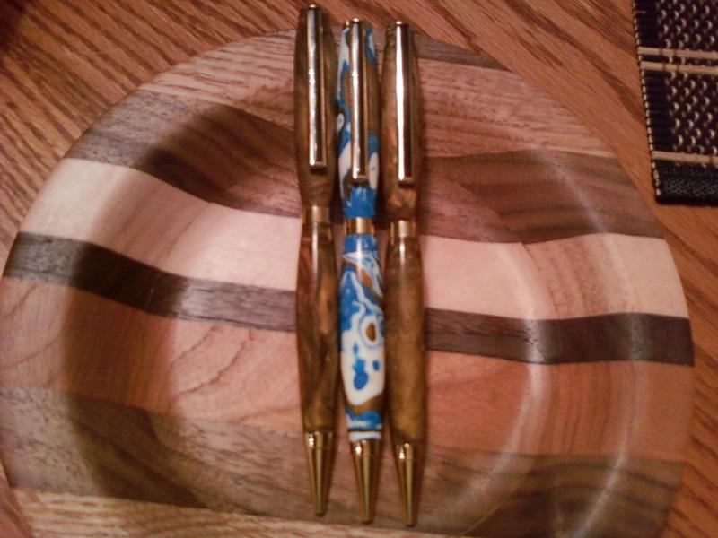

Day 2 with polymer

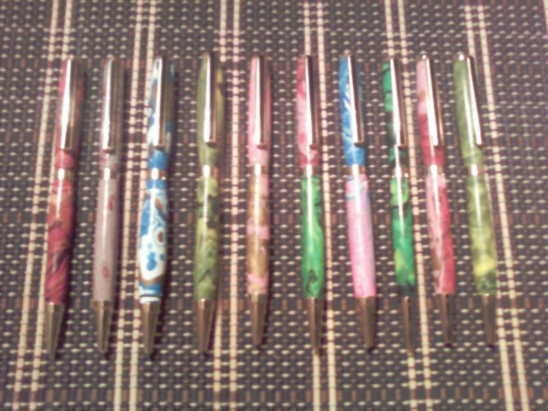

Well here is my second atempt... Had a few blow up on me but heres the survivors:frown:

Thanx paul for posting the product used.... I might add too that this product is non toxic and is great for non dusty shavings and is nice to sand but is a little hard on the sand paper,,,

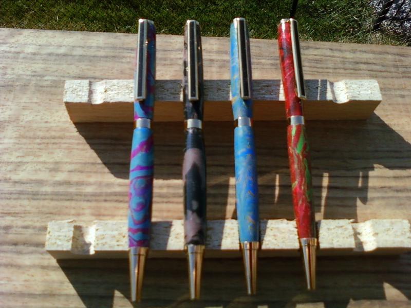

New pens update
well this is what i have been working on with my polymer project ..lol..:biggrin:sorry for the bad pic quality...

They look great .
In some ways this stuff is better the PR since you can build your swirls right into the blank and get effects you can't get with pr no matter what .

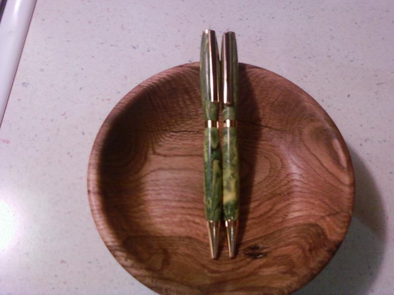

Scott Thanks for starting this thread,I`ve been folowing it with great interest. I`ll send you a bill for the new hobby expense.:biggrin:
Hope you don`t mind but here is my first pc pen after about two other failures.
Comments and recommendations welcome.

Man...... perry that is awesome great choice of colors. It looks lke your having better luck than me..Just got off the phone with my stock broker told him to put all my money into the polymer clay companys i feel their sales are going to increase.....LOL :rolleyes:
