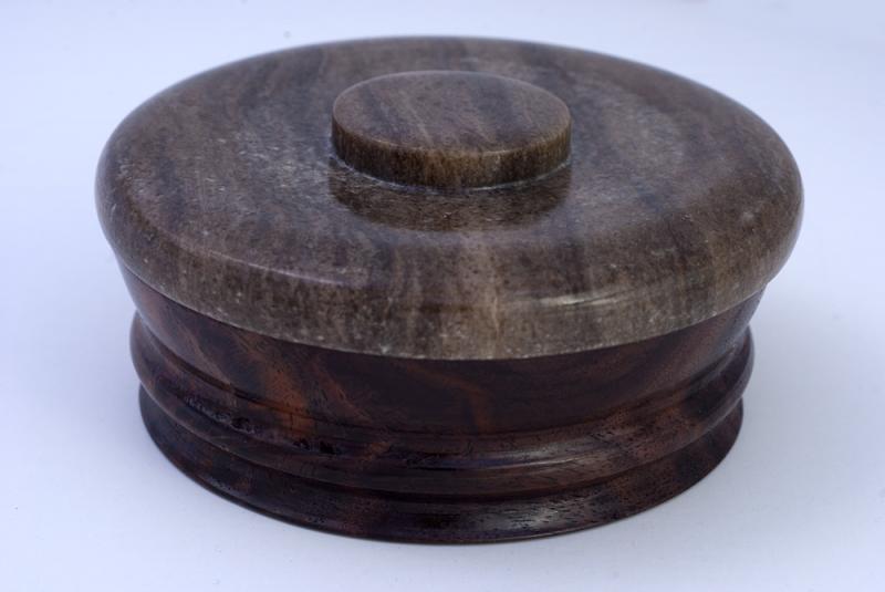

Walnut and alabaster.
It started out with alabaster glued to the rim of the bowl (and much taller!) but the alabaster blew out, taking a chunk of walnut with it. So it's a bit short. The opening is about 4" across. Crappy spray poly finish.
I made this for my wife... She makes her own toothpaste and has been using baby jars to keep it in. I wanted her to have something nicer...

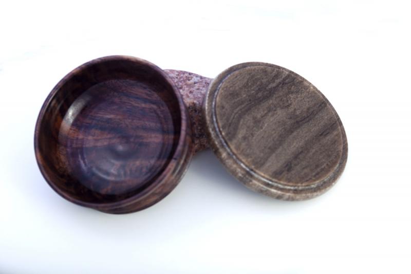

Forgot the open pic. Couldn't get an angle on something that big in my silo, so it's a bit out of focus. I'll work on better pics later if I get a roundtoit.

I was nervous... I made the lid a kind of sloppy fit, hoping the finish would fill the difference. I figured with my luck I'd either make the finish too thick for the parts to fit, or so thin it flops around. Happily I got lucky! :D

Nice project, will be interesting to see how the finish holds up to long term contact with the toothpaste. Out of curiosity why make her own toothpaste?

As for durability, it's not as harsh as my toothpaste. The inside of the bowl has 10 coats of poly. The outside and the lid just have 3 each. I think the wood itself would work fine without the finish except for the fact that I made the bottom VERY thin.

If the finish doesn't do the trick, you can build up the fit with CA. I would carefully wipe on a couple of coats around the tenon on the lid until it fits snug. You can sand it and polish it up as well.
