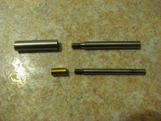

I have two different size pen mill heads..
one takes 3/16" shank, the other 1/4" shank.
So, the idea (read boredom) was to make a pilot with one head,
and two shanks. They are interchangeable. The brass bushing mates the smaller shank into a counterbore in the end of the pilot. The threads are
tapped way deep into the pilot, below the counterbore.
Pretty sure I have not seen this crazy idea before.:biggrin:
Thanks for checking it out!

Hank, I wouldn't count on it, it was a fair bit of time.. probably not
cost effective. :)
But it was a challenge to figure out, which was what I was really after!
