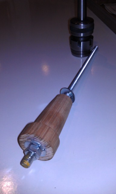

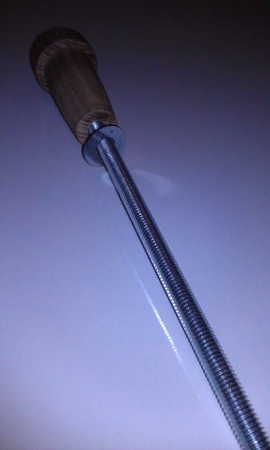

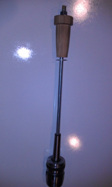

What I did to solve this problem was make a drawbar -- simply a length of threaded rod that passes through the headstock and screws into the tail end of the Morse taper on the collet chuck.
On the outboard side of the headstock, I put a threaded handle.
