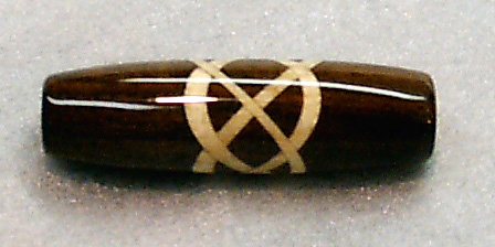

Cozee.....Not regarding your finish (which looks terrific) but I have made a few Celtic Knot laminations....None as good as the one you show here. I use a sled to cut at 45 degree angles, and the inserted wood is the same thickness as my tablesaw blade. All of mine came out ok, but NOT symetrical like yours is....Any suggestions would be appreciated.
Also, can you recommend a way to clamp pieces of blank when you do the glue up? Hard to clamp pieces at 45 degree angles...Thanks..Oscar

To answer your clamping question, here's a quick and dirty scanned image of an Atlas I'm working on. The cocobolo and acrylic were clamped using two 6" Bessey Uni-clamps set at 90° to each other, with pressure in the direction of the arrows. Wax paper was used to keep the glue from getting my clamps in worse shape than they are, and the pieces were cut over-size so I could sand the blank to the right dimensions. I've learned not to get too complicated with the glue-ups...just take more time and steps to get your eventual design finished.
