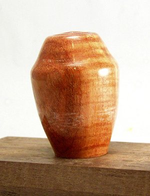

I have been using CA/BLO for pens and generally like it, have just started using plexi, and am not sure yet. I decided to do this direct comparison on these carob wood bottle stoppers. Easier to make than pens. Bearing in mind that these were not necessarily from the same log or even the same tree, the results were fairly instructive. The first one was finished to 600 grit, then plexi. Finish off with Novus plastic polishes.
You can see the nice high shine, it has a wet look to it, but the grain is pretty light, without much "pop" to it.

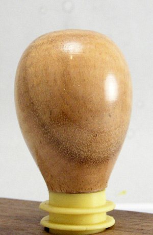

The next one
was CA/BLO . I put on the BLO, then follow with medium CA. Much prettier grain, but a bit softer looking, as expected.

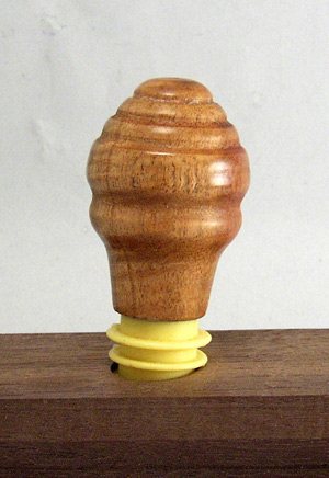

What about some combination of the two, BLO/CA to pop the grain, plexi to give a shine? As Sir Isaac Newton was heard to remark," The theory guides, but the experiment decides." Right on, Sir Isaac!., So I made one more, using that method, again finished with the Novus system.
Ignore, please, for the moment, the white spots where the plexi got too thick ( I will rework this, it doesn't satisfy my anal- retentive soul) We got nice grain, with a hint of chatoyance, and an overall amazing plexi shine. The fact that the grain shows so well helps mitigate the plastic look of the plexi (IMO).
Overall, this has been a worthwhile experiment. I plan to further develop it and apply it to pens. It works best on the simpler shapes, the grooves and deep contours are problematic for both of these finishes, but I think it has lots of promise for pens.

Thanks for taking the time to document and write this up, Ron! Very informative. I think the plexi finish holds some real promise for things like cups and bowls, where you'd want something you can wipe out easily. I'll be curious to see how the Plexi-over-BLO finish holds up over time, and whether the BLO causes adhesion problems for the plexi. Please understand, I'm not trying to knock your finish or your idea - I really like that last one, and it's getting more-and-more tempting to try plexi as a finish.
thewishman
Mar 9, 2006
8,183
Reynoldsburg, Ohio, USA.
Jim, come over to the plexi side
Ron, thanks for the side-by-side comparison. I am a confirmed plexi finisher, but have wished for a way to pop some grains. The combination of the BLO and plexi looks good.
Chris
terrymiller
Oct 13, 2005
317
Germany
I have used BLO with plexi on certain woods with no problems. I just make sure to buff the blank until the BLO is totally drie then apply the plexi as always.
