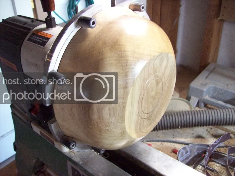

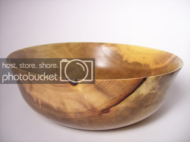

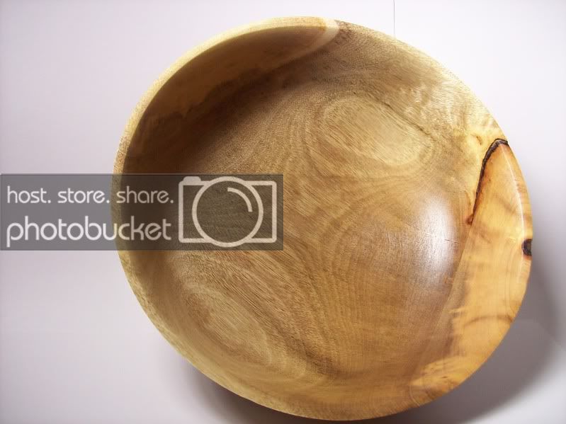

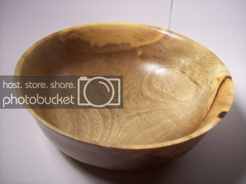

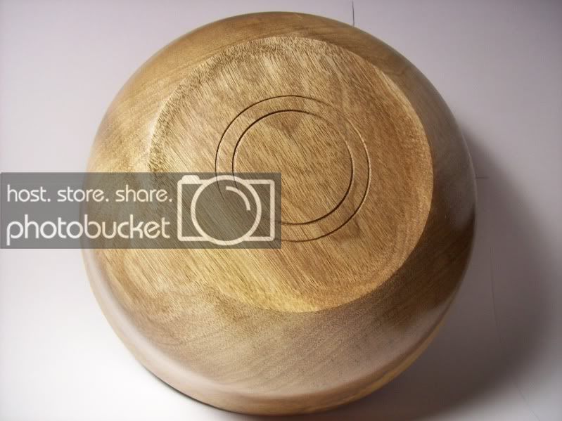

This is bowl #4 for me and the first one with NO CATCHES.
I took this as proof that I had turned it, in case my luck didn't hold and I dropped it on the way to it's oil bath.
It measures 7 3/4 wide x 2 1/2 high
C&C alway welcome and needed. I would like to get better at this. Thanks. I've got a dried chunk of walnut waiting for me this weekend...

Nice chunk of wood Pete. Same question as Jon, how might you keep the knot from dropping out or cracking along the grain there? I am a self taught pen turner and I really want to get into bowl turning myself!
Great job with this and good luck with the Walnut bowl piece. Sharpen those gouges first, and just take your time....

The piece is actually very stable. It had a few cracks from drying too fast but I filled with CA and it turned nicely.
My main issues with bowls in the inside curve. Once I get that everything else is much simpler. I'm still rubbish with the bowl gouge and all the hollowing on this one was done with a scraper. I'm starting to enjoy scraping. Still I'll try the gouge on the next piece.

Beautiful form and execution.
Once you get comfortable with the bowl gouge, making bowls gets a lot easier.
Try to get your paws on any old 8" - 10" logs and make your own bowl blanks! A good way to practice using a bowl gouge. Another cheap bowl blank is to laminate 6 8" long pieces of 2x4 construction studs. You can make a bowl blank for 1$ to practice on that way. They won't look as pretty as this, but the cheap practice is helpful.
