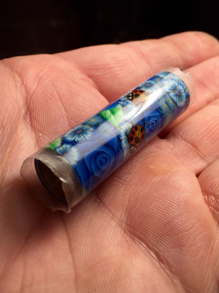

These 'special' bushings you will find Ca will still stick to them. The better and superior choice is to wax the bushings you use. With the right method they will come off like this.
attachment.php
If you remove the tube say after 400 grit and clean up the ends it is way easy to profile the ends to be near perfect every time.

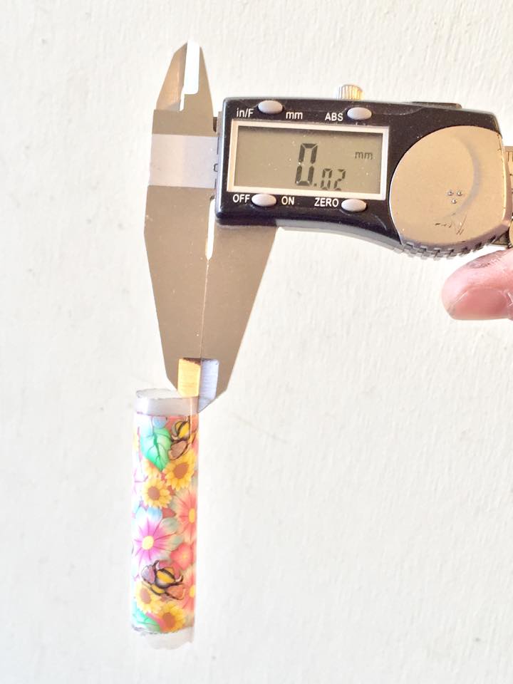

In case anyone is wondering yes you can use the overage on the steel bushing as a guide reference point so you will know exactly how thick your CA is when you are unable to see the blank itself.
attachment.php
Work WITH the equipment not against it. Using delrin is working against the CA.

That only works with a very small subset of the finish arena, which is thin film coverage. If you have any gap filling going on then the game is off without bushings. You NEED that stop gap support to do a good buildup on the end of the tubes.

A good CA finish is flexible and that excess in the photo's I posted can easily be trimmed off. I did a few short vid clips showing how flexible it is.
