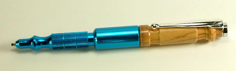

Justin,
Harbor Freight sell a small Air Gun in Aluminium that lends itself to an easy exercise in penmaking. Cheap as chips the knurled area can wind the biro in or out as well as the Slimline mechanism. Like Josephs coat they come in many colours.

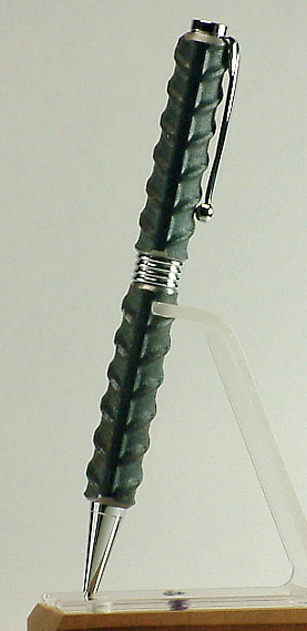

I am a fixated friend of Skippies also and have moments of fantasy such as the Rebar Pen shown as well here. Skippies pen is a ripper,all his pens are.
Kind regards Peter.
