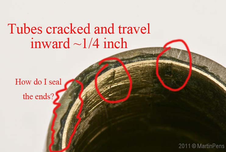

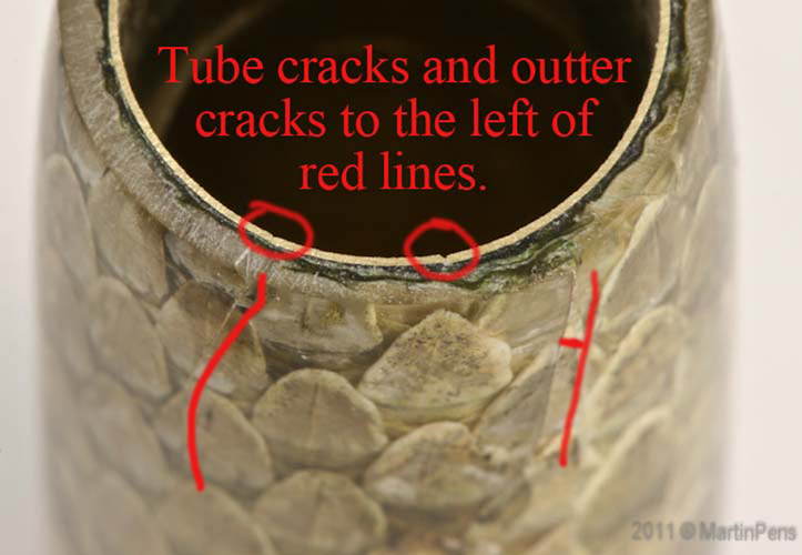

I had a customer return his snakeskin pen. The cap and body tubes had bad cracks. (This was an El Grande kit, which I no longer use do to low quality parts) I disassembled them and took a couple macro shots to highlight what I'm seeing.
This pen was under normal usage - no, he didn't step on it, drop it, run over it or expose it to extreme heat.
I realize that I did not do anything to seal up the ends after trimming the tube. Could this be all it is? I'm noticing that the brass tube itself is actually cracked! :confused: There is also some type of reaction on the brass tubing causing some green buildup.
Any thoughts/solutions would be appreciated.
Martin

The El Grande is a favorite of mine but we can discuss that later.:biggrin:The amount of material left on the tubes of the El Grande is very very thin. The amount of resin over the skin is even less. Because of the small thickness I either don't make the El Grande with snake skin blanks. Turning into the skin is often a problem with the El Grande. I don't think sealing would have helped. Parting off the end 1/8 inch and adding wooden bands may help but then the pen looks like a mistake was made and the wooden bands were used to cover or hide the fault....oops band. The only way I will make an El Grande with snake skin is to turn the blank oversize and round over the ends to the pen parts.
The reaction with the green is one of the reasons I paint the tubes so the skin is not touching the brass.
Good luck.
