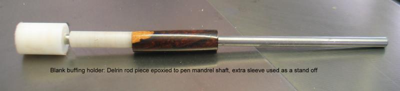

Not actually using, but here's the thing I use for buffing when I can find it :). Usually find it only after I've flung a blank across the room and cracked it while trying to hold between my fingers :redface:.

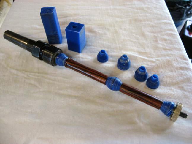

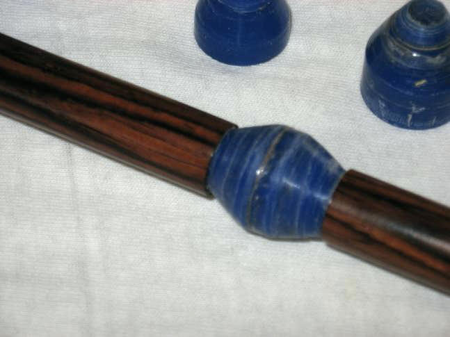

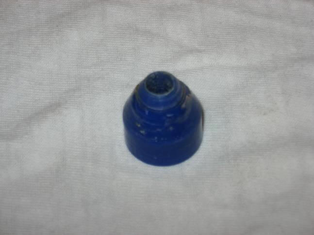

UHMW Buffing
I use UHMW Bushings on the mandrel. I'll get aroud to making a dedicated one someday.
How to make. Take a 3/4" x3/4" x"1 1/2" block of UHMW and drill length wise thee same diameter as you mandrel. For a snug fight mine was 1/4". Mount on your mandrel and turn 4 cones.
A big advantage is that the tube ends are expose for buffing (see 2d pic). The 3/4" cone will work for slimlines up to perfume atomizers. I also use these for finishing. The CA doesnt penetrate and chips off or do a quick soak in acetone. Mine are due for a cleaning.:redface:

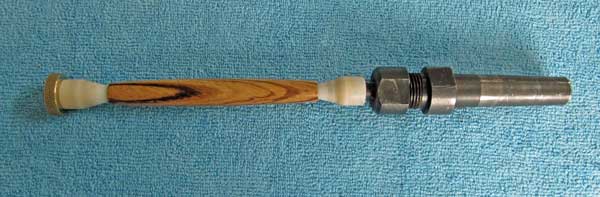

I use my old mandrel with a set of Eliminator bushings from johnnyCNC. I have it set for the longest blank that I use and just add spacers for the shorter blanks. I also use the same set up for applying CA finishes.
