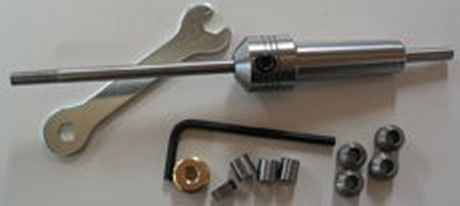

Hi everyone,
I was shopping for a adjustable mandrel for a friend of mine when I come across a particular shop where I saw this "unusual" to me anyway adjustable mandrel that it seems to have been design with a better balance/design and vibration free from not having square nuts turning at high speeds.

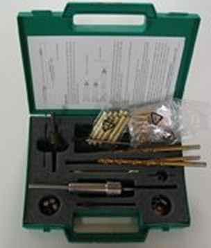

I also believe (from the pics as I'm waiting to receive 2 of these I order) that this nice set comes with metal conical finishing bushes (Delrin type design) for TBC type work or at least allowing the CA finish the done without using the original kit bushings voiding the bushes glue-ups with the barrels, often a problem.
Looking at it, I notice immediately the very "ergonomic" design which only can be an advantage. I have also been told that these mandrels are made in the UK, which surprised me not being made in China..!
I have also been told that this mandrels have been available in Australia for about 2 years but I have never seen any mention to it, either on any Aussie sites or here, where so many Aussies are members. If made in the UK, it surprised me that has not been any mention of it by any of our UK friends/members...!!!:confused:
With all this said, I'm not going to be totally surprised if someone tells me that, these have been shown and discussed numerous time, nevertheless I am not aware of such, otherwise I wouldn't be writing this post, huh...???:biggrin:
The Price here is AU$42.00 + freight, I wonder if anyone here have heard or seen these...!!!
PS: Drill bits, brass tubes and pen kits shown on the second pic are not part of the mandrel kit but a promotional option from the supplier...!

That is an interesting concept. Kind of like an milling end-mill holder. The hex set screw probably has a brass slug under it to keep the mandrel from being scored by the end of the set screw.
Come to think of it, you probably could use an end-mill holder. End-mill holders are about $20-$40, and it doesn't look like 1/4" size is common. A larger size and a split sleeve could make up the difference in diameter.

This looks interesting. But, for not many more dollars one could purchase a collet chuck that would do the things that this gadget does AND many more.
I like this idea. Perhaps the reason not so many know much about it is the price. I like it A LOT!!!! But the "do all" advantage of the collet chuck would make me pass.

George, I have one of those mandrels, picked it up at the melbourne wood show this year. It is a different design to anything I have seen before, but it works very well.

I think it is. Manufactured by the British firm Planet. As a pen mandrel it's exactly the same as the following: http://www.theturnersworkshop.co.uk/store/view_product.php?pid=22&cat_id=23&prod_id=50
The difference with the simple mandrel is that the "professional" set offers "extra" (with a 135%... extra cost) a trimming tool, 3 drills + 5 slimline pen kits.
The initial purpose of the conical bushes is to turn bigger pen kits when specific bushes are missing.
Hope that helps. If somebody needs more information about those mandrels, in Europe we use the likes more than 10 years ago.
A last thing after checking prices. The Australian price is simply unbeatable! The UK shop mentionned above sells the same kit @ $Au 67. In Belgium one can find it @ $Au 106,57 (79,01 €). Here (a bit scrolling): http://www.willyvanhoutte.be/fr/catalog/show_cat/1252

The only problem with that design I found was if the hole is even slightly larger than the shaft the hex screw pushed the shaft to one side resulting in the shaft being slightly off center at the drive end.. Worked ok most of the time but...

The 3 adjustable mandrels I have are exactly like the one from your link and they are good, no doubt but I like the design of this new (to me) style and if made properly, which I'm expecting to be, reason why I'm paying more than twice as much to get the UK made one instead of the Chinese made one.

George, I think I misunderstood. By rereading the thread, I realized that the mandrel you bought is the standard mandrel. Well, if this is the case the price of $Au 42 matches the price here in Belgium. In the UK, it's a bit cheaper but with shipping costs to Australia I think you paid a fair price.
As for the mandrel itself I'm satisfied and I think you'll be too.

I have 2 of these, both the MT1 and MT2 version. Had the MT1 from day 1 of penturning, and the MT2 for a couple of months.
Both work perfectly well, and the conical bushing are a stroke of genius for finishing cigars, sierras etc. Just too small for the Jr.Gent upper barrels!! Have been using them for a couple for apply finishes as it lets the finish go over the edge and not clog the bushings!
The mandrels are size as a normal 'A' size mandrel, so take the normal 7mm slimline tubes with no bushes! If you can get it for $40 thats a good price, as its around £40 here in the UK!
