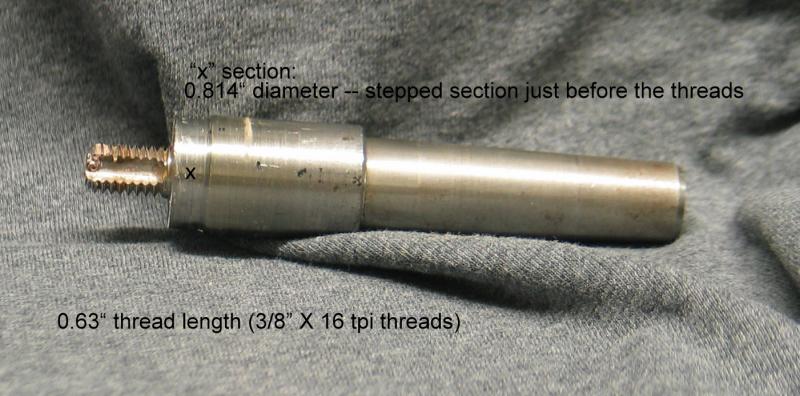

I am planning on making a few bottle stoppers for Christmas and am going to make the mandrel for my lathe and am wondering if anyone can give me the specs for it....
mainly the big diameter before the threads and the length of the threads...

Photo shows requested dimensions on the stopper mandrel I purchased from Ruth Niles...
Edit to add: FWIW, I measured the large diameter of one of Ruth's #301 SS stoppers as 0.81".

btw jim, is that also a tap for the threads built in cause that would be a great idea.....
