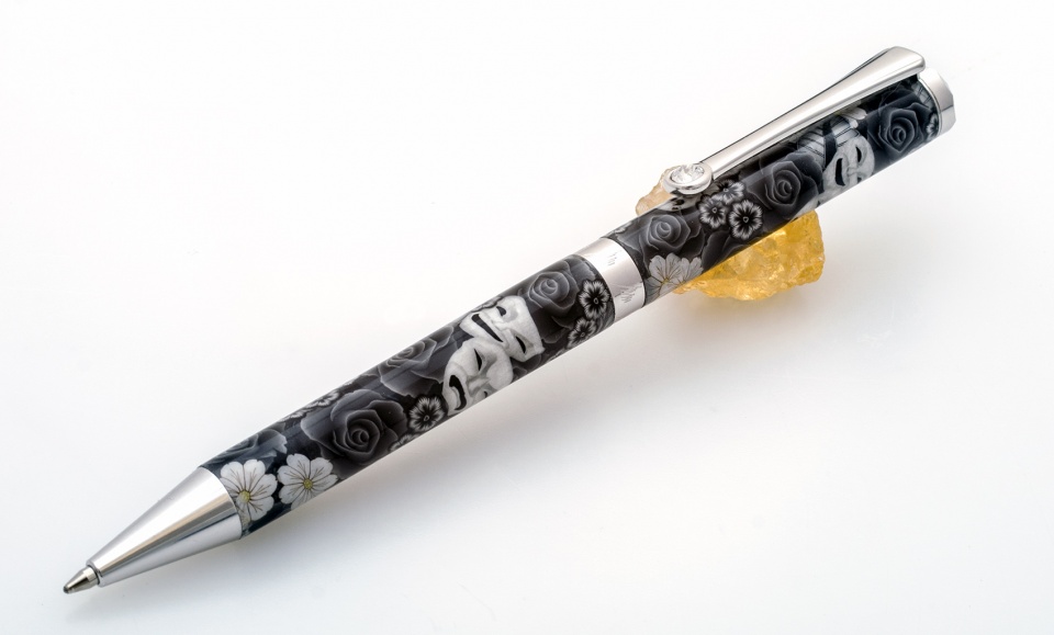

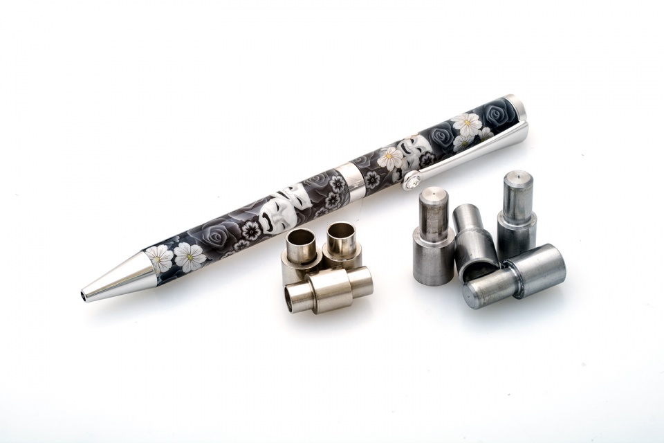

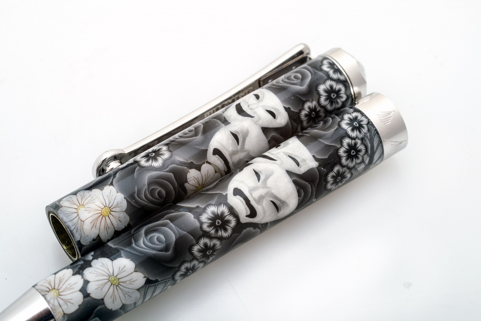

This is the 'Zoe' kit from Richard DeArment and R&B Crafts
The kit is made by Dayacom and called the Diana, the plating is rhodium.

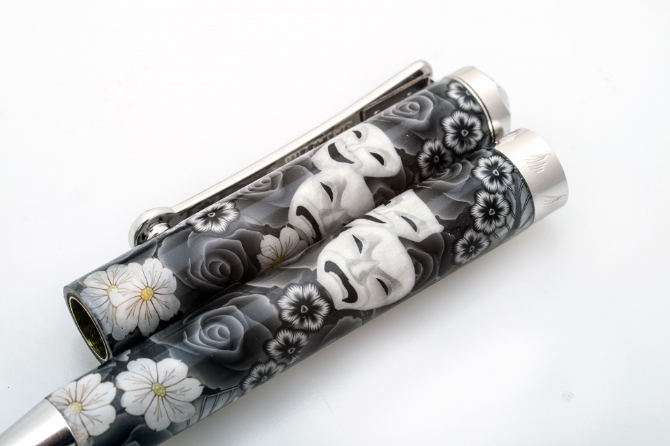

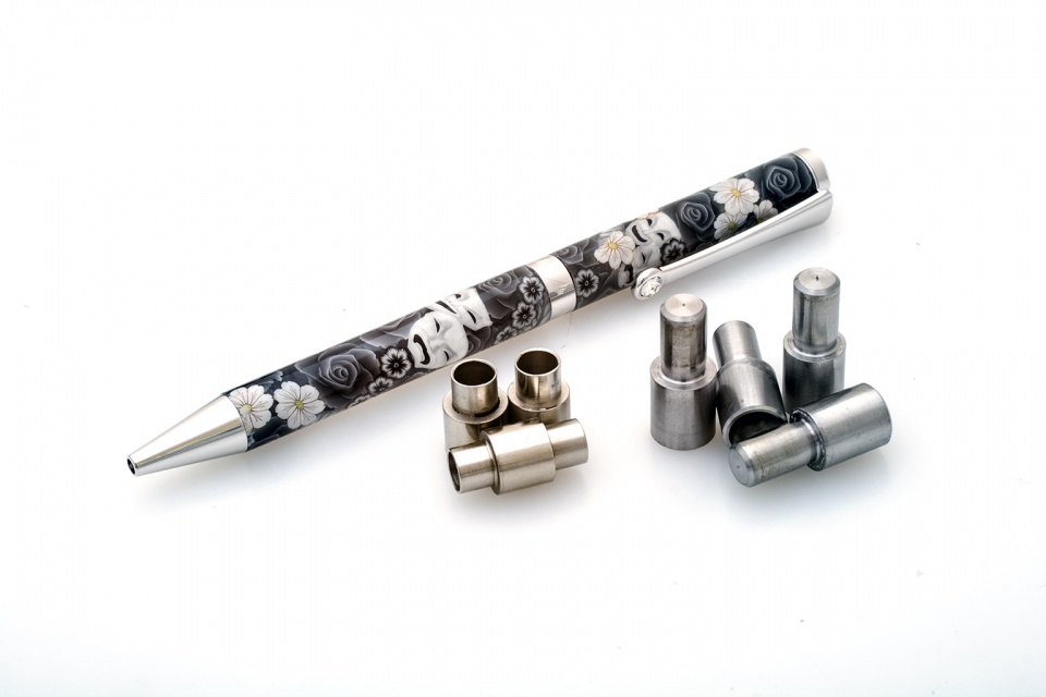

Many may be aware that I despise factory bushings and I had TBC bushings made by Brian Nikitas. Yes the bushings are USED in the photo. I also included factory bushings (left) and TBC bushings (right) for compare.
attachment.php

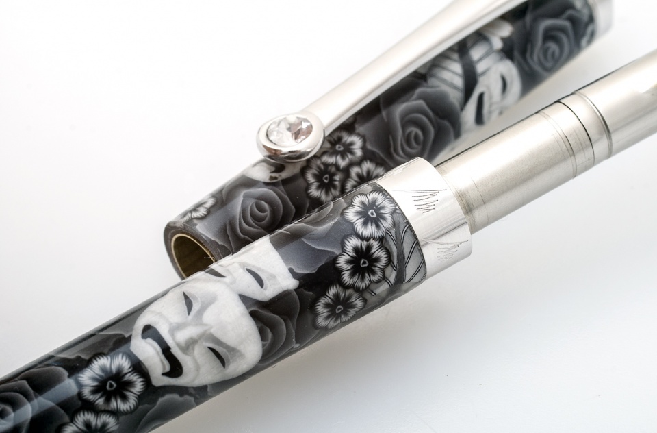

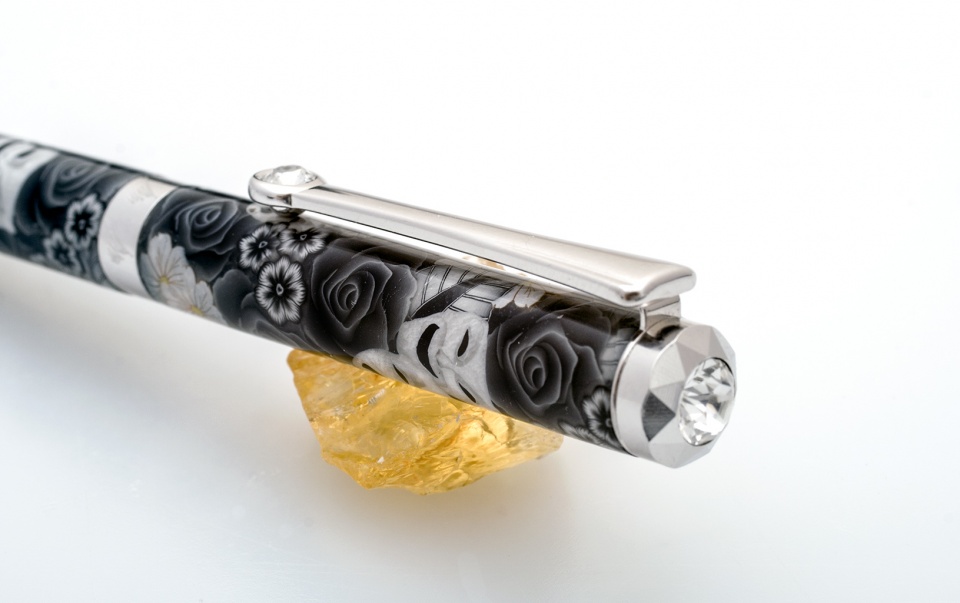

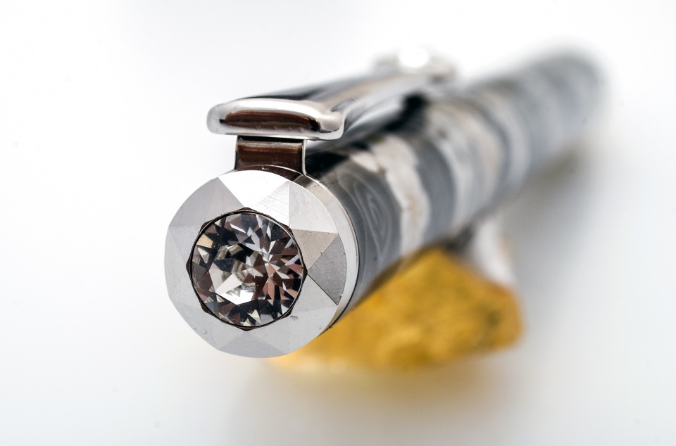

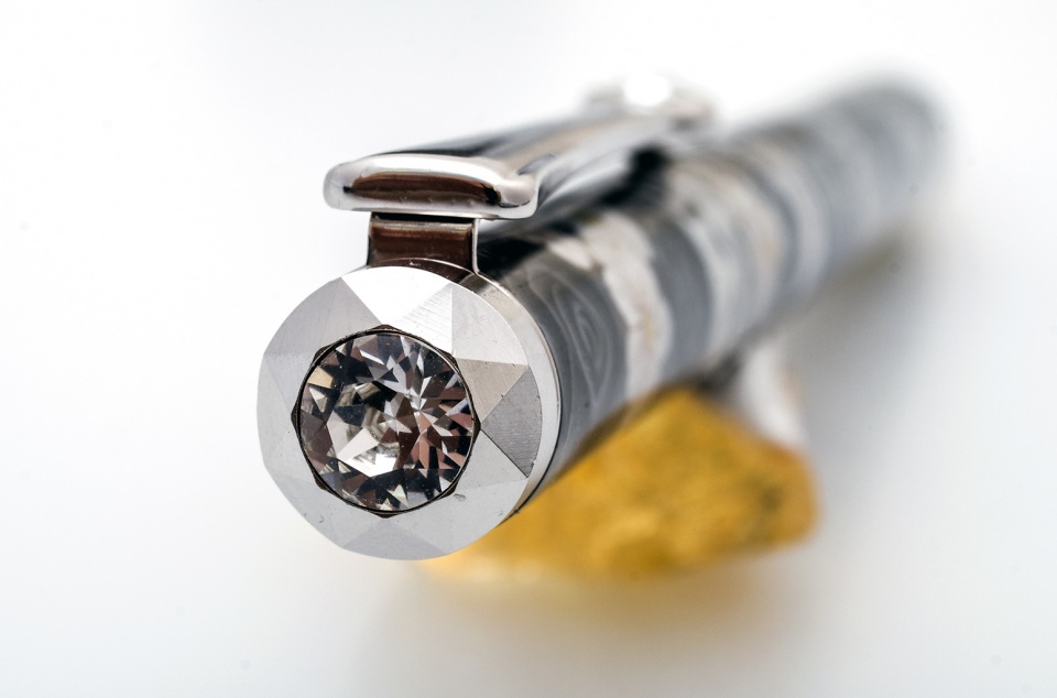

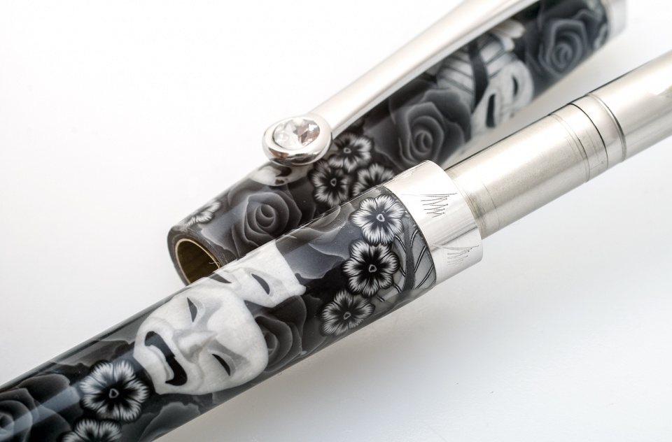

The end cap is similar to the venus. It features swarovski stones on the clip and the cap.
attachment.php
attachment.php

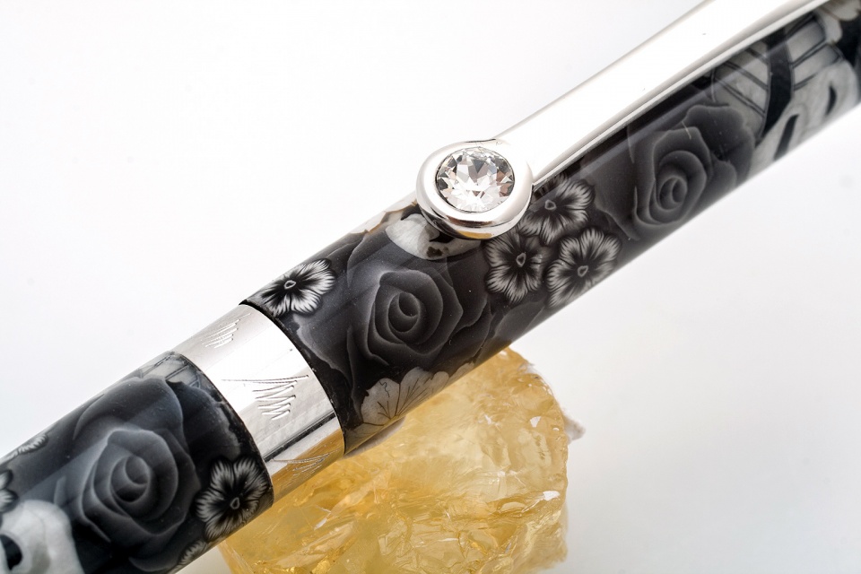

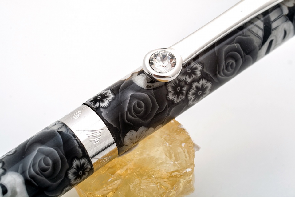

The center band is engraved
attachment.php
attachment.php

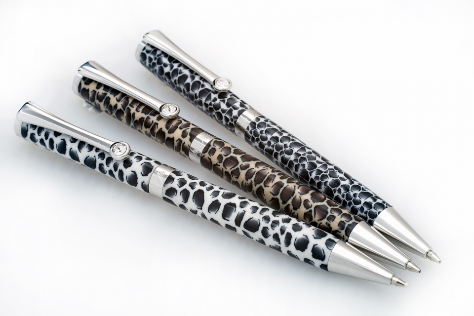

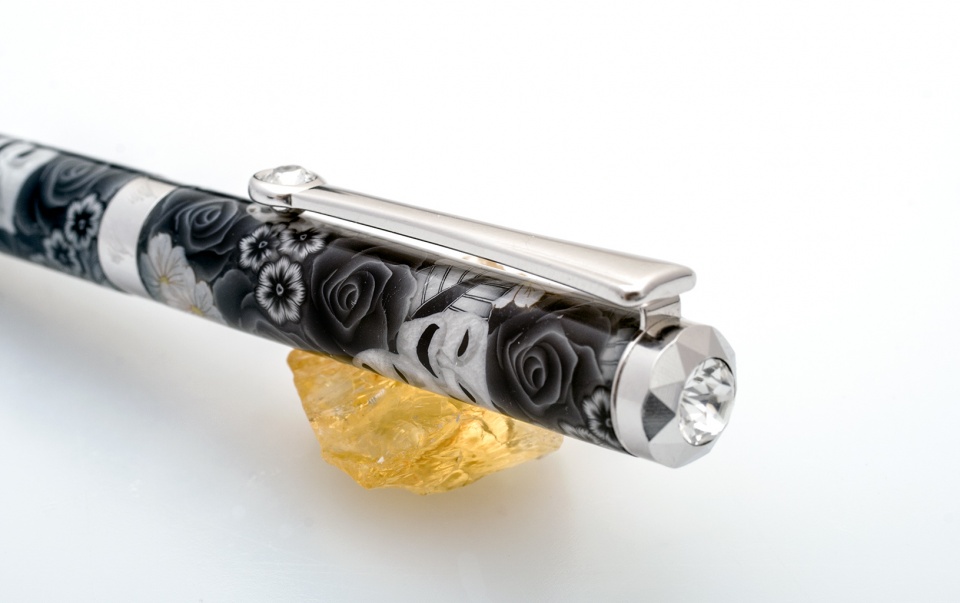

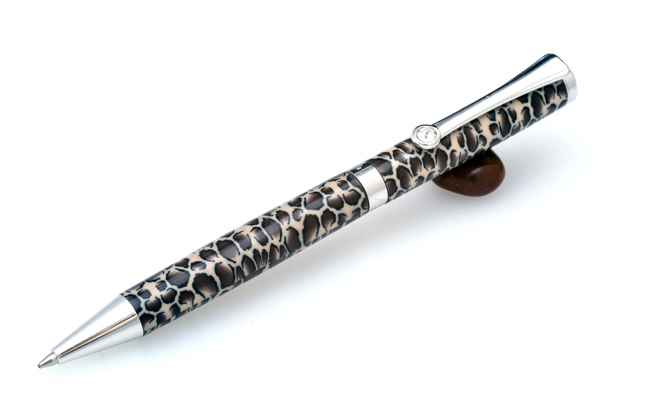

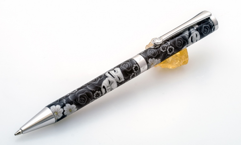

Few notes on the kit:
*) The lower tube is *LONGER* than the upper tube.
*) The drill size needed for blanks is 8mm or 5/16"
*) Uses a Parker refill.
*) The blank was provided by Toni Ransfield and in Polymer Clay.
attachment.php

Loose yes but be aware the finial and nib bushings are different sizes. Finial = 10.47mm the nib = 10mm.
Yes the bushing size is:
0.412 x 0.289 (Cap)
0.412 x 0.289 (Center Band)
0.390 x 0.289 (NIB)
