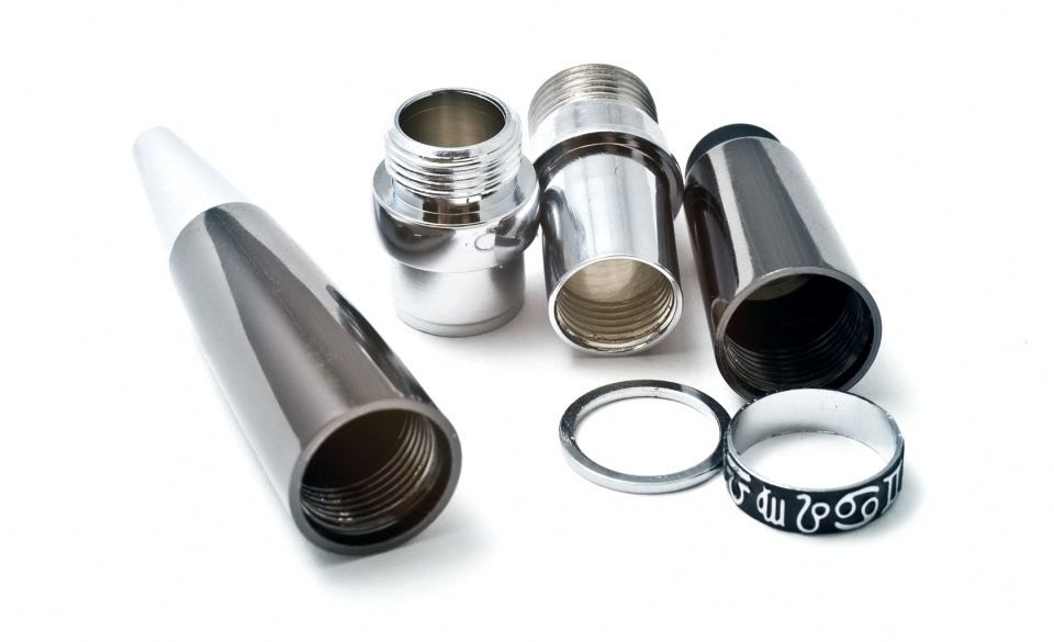

This is one of the items I just obtained from exotics on my last order.
Exotic Blanks :: Pen Kits :: Pen Kits (By Kit Name) :: Zodiac Pen Kits

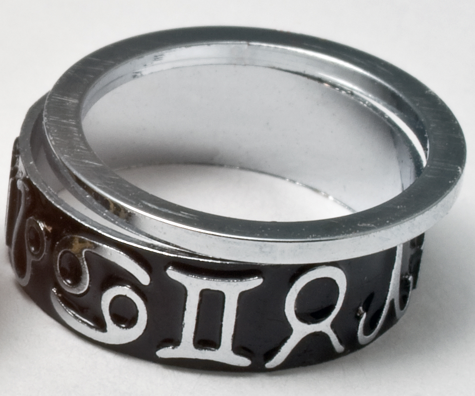

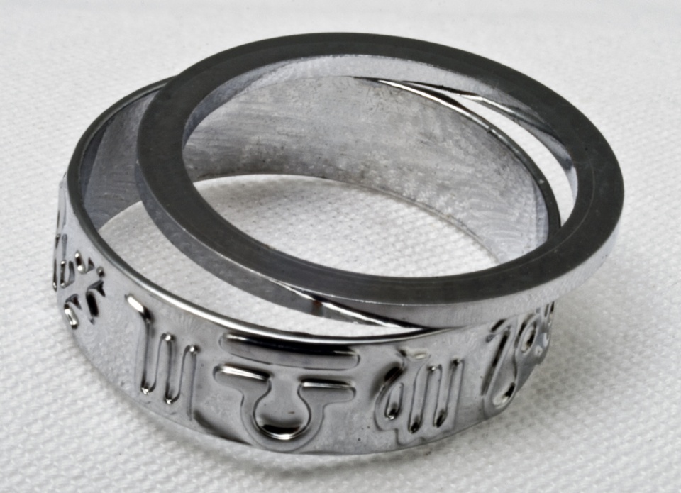

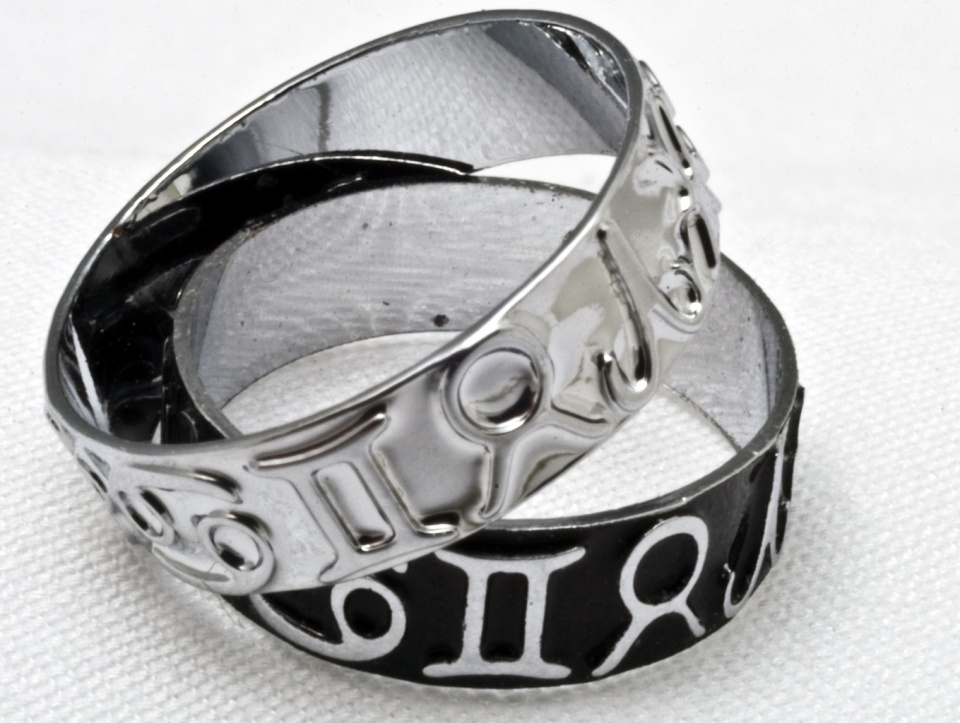

I decided to push some limits and see exactly what I could pull off. I listed the camera settings I used F-stop and shutter speeds, all images are shot at ISO 100 hand holding (no tripod)
attachment.php
Ti-gold with contrast, Ti-gold, gunmetal/chrome.
F/13, 1/125.
attachment.php
gun metal/chrome
F/16, 1/125.

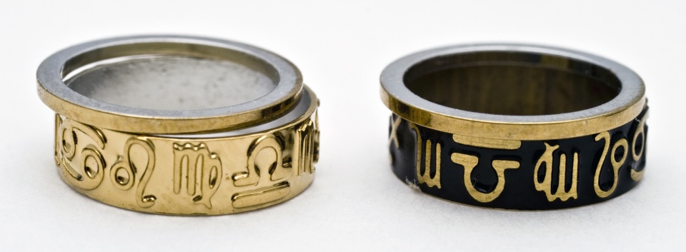

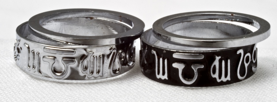

I am really loving these bands. Also everything is screw in and easy to work with, a very good upgrade.

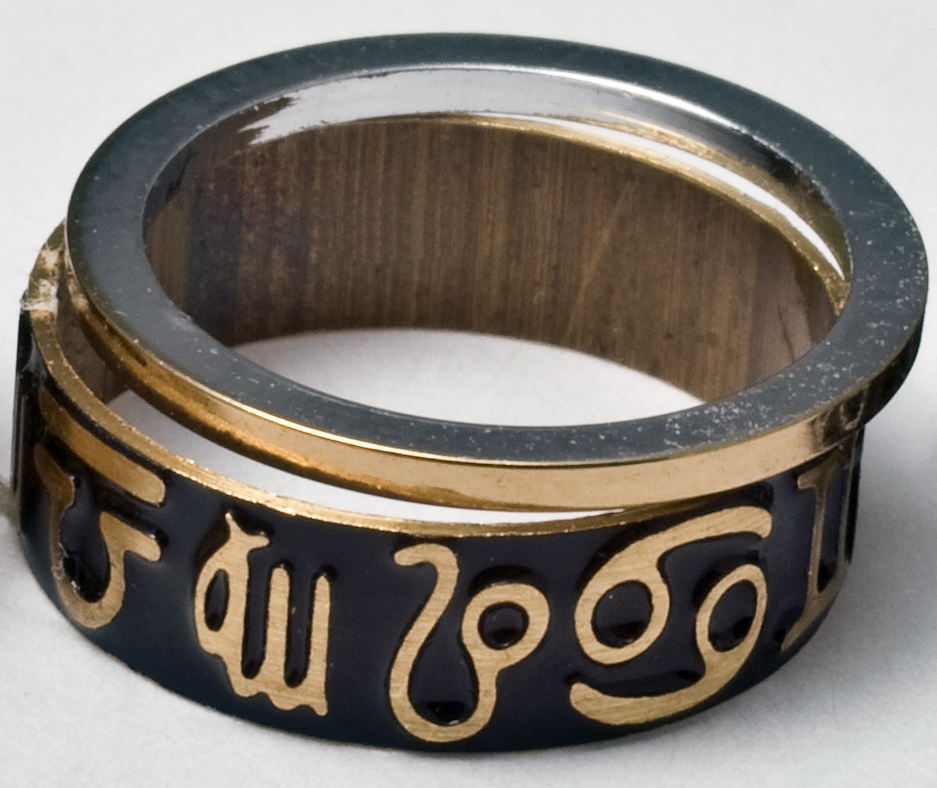

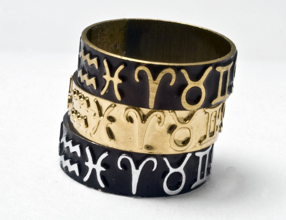

attachment.php
Ti-gold, Ti-gold with contrast, gunmetal/chrome.
F/18, 1/100.
attachment.php
Ti-gold,
Ti-gold with contrast.
F/14, 1/200.

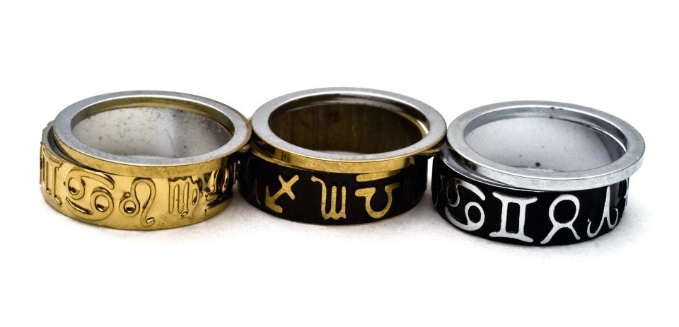

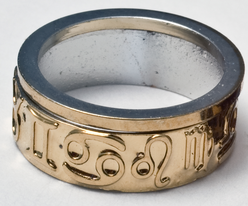

From here down is close to the upper limits of my camera :)
attachment.php
F/40, 1/200.

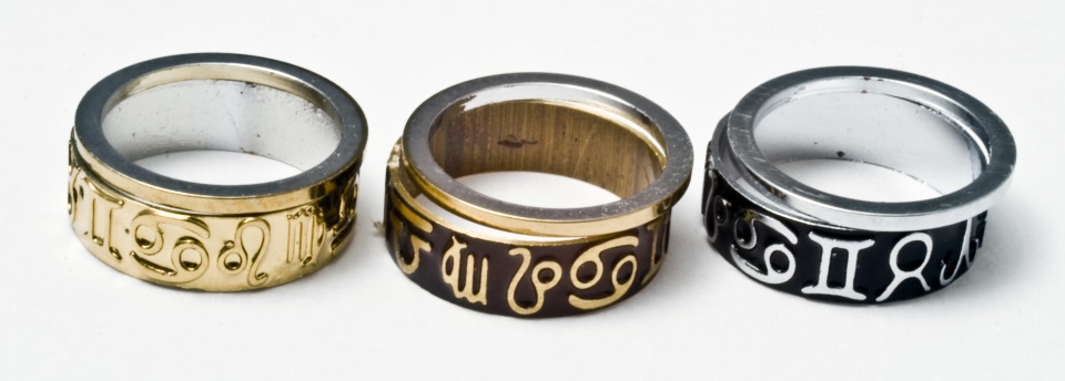

attachment.php
Ti-gold,
gun metal/chrome.
F/40, 1/200.

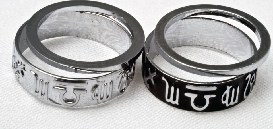

attachment.php
Ti-gold,
F/40, 1/200.
attachment.php
F/40, 1/200
attachment.php
gunmetal/chrome.
F/40, 1/200

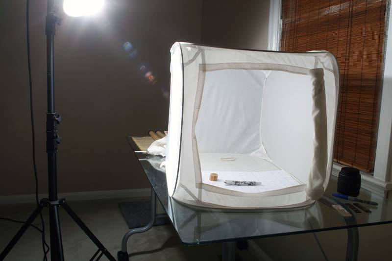

Ed were these shot in a tent???
Lin.
Yes.
The F/40 shots were direct light @ full power. Some of the others were bounce, I think most of these were direct light but not so much full power. The light is a photogenic 500ws monolight hovering inches above the tent.
Photogenic Professional Lighting Equipment - PL1250
These were also shot in my kitchen on the island and not in the photo room.
Very, very nice shots. I was going to guess F-22. You no not mention it but it looks like a Soft box and/or Reflector was used (soft shadows).
Nice work!

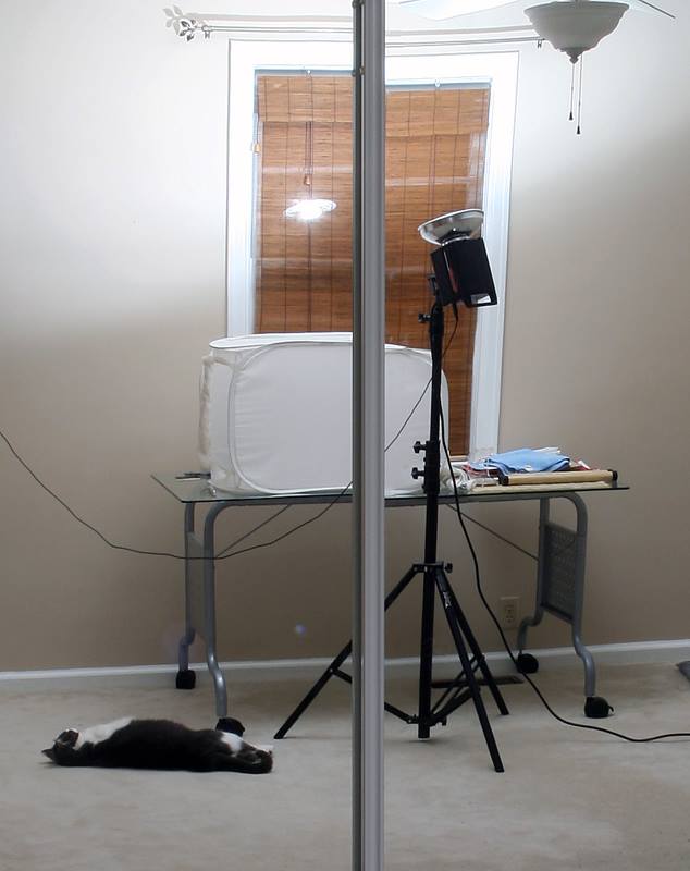

I use a light tent.
attachment.php
I switch between direct lighting
attachment.php
and bounce lighting
attachment.php
The ceiling makes a wonderful reflector in the room, as does the wall color and carpet color.
Also forgot to mention the background is legal sized printer paper.

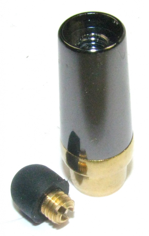

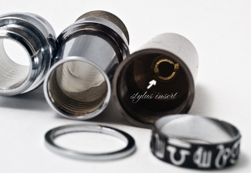

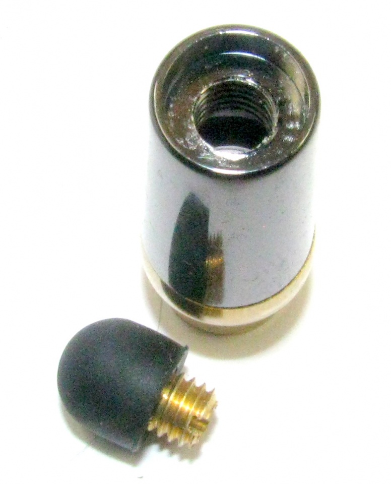

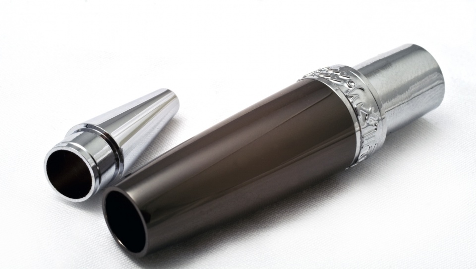

I am not trying to compete with Ed's photographic skills!!!
But I found his question interesting, so I did a little additional disassembly.
Came as a surprise, but a pleasant one!!
SWEET!
So next questions begs: is this compatible with the euro/slimline stylus replacements? :) I am betting yes they are. Also what is the screw thread size?
Light bouncing off the cat makes a big difference!
See the cat think's she's the subject of the photo's.

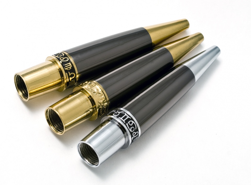

I totally forgot to post these last week :(
attachment.php
attachment.php
attachment.php
attachment.php
attachment.php
I should have used a better background, guess it's on the reshoot list!
