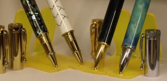

I see Timberbits is a screw cap as csusa is the magnet. Where is the magnets located on the cap??? Are they in the lower half or the upper?? I am looking to modify the cap somewhat. Not sure if I like that faceted cap. Maybe if i seen one up close I would have different thoughts.
The magnet is a ring, located right at the opening of the cap.

Here's a pic to compare the nib ends.
OK Skip is that side by side comparisons of the 2 kits??? I see what you mean about abrupt end and it is exactly where the fingers go to use the pen. I am surprised you did not come up with a new nib:smile::smile: Now you got me thinking even more.
