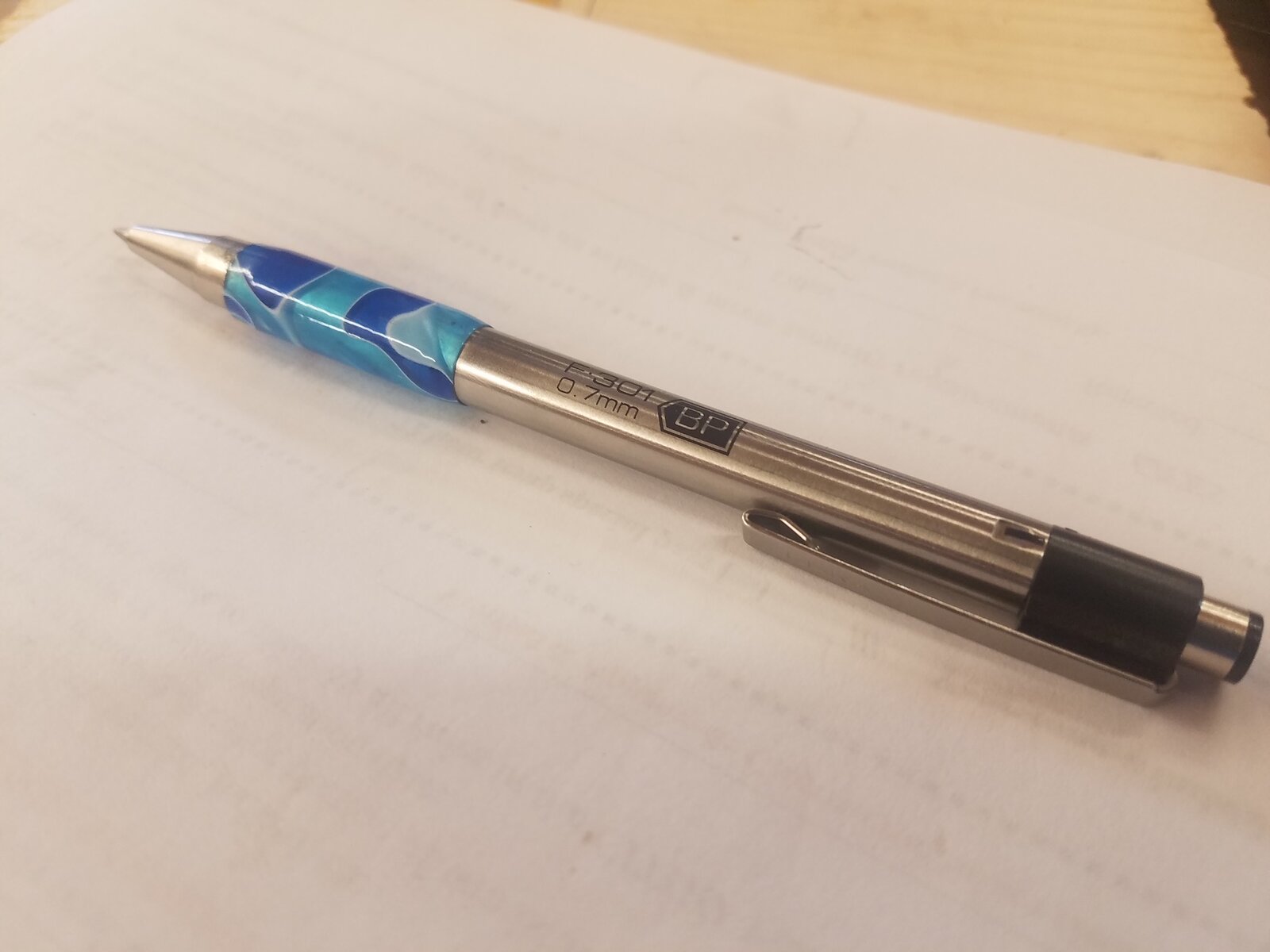

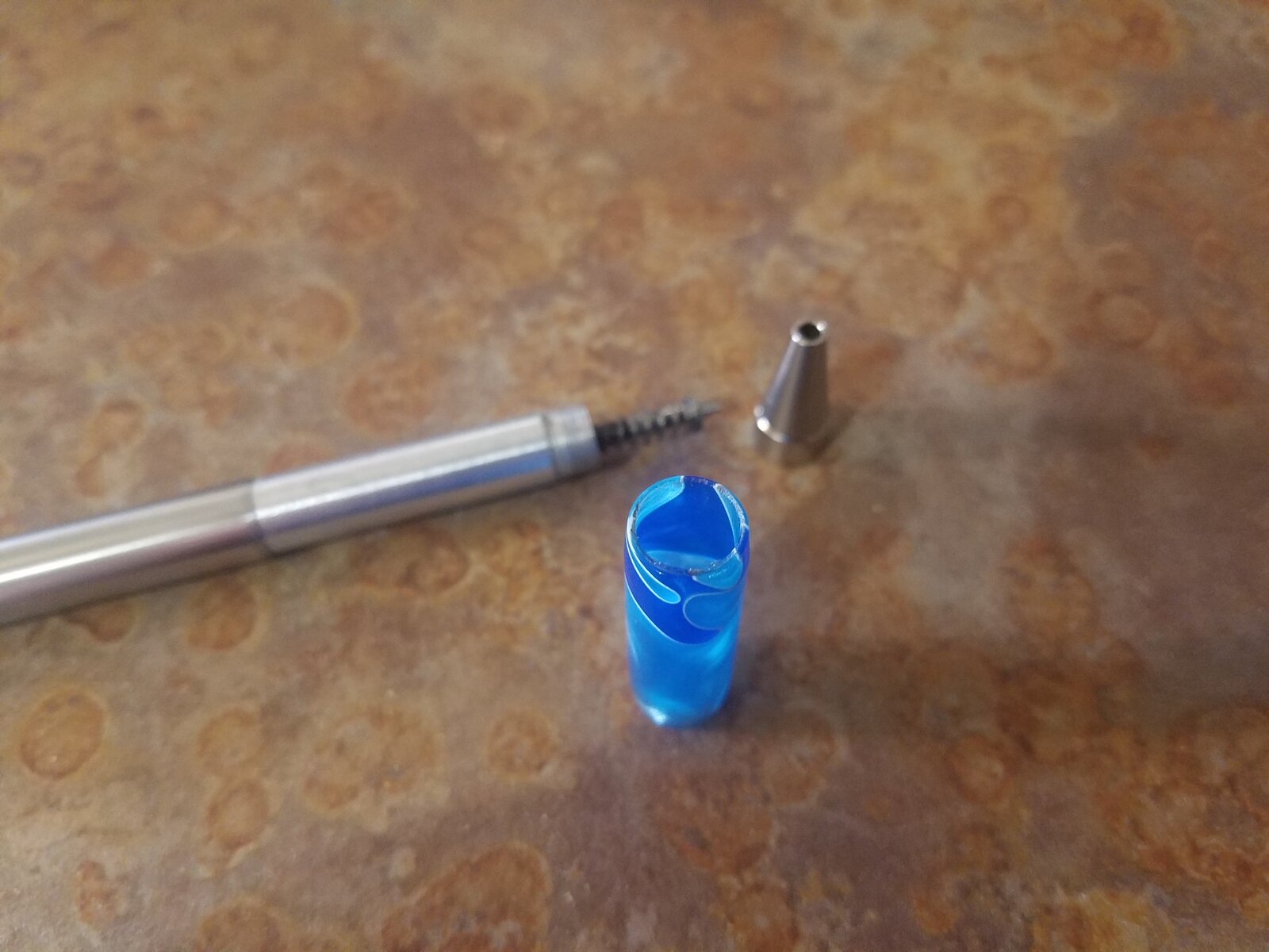

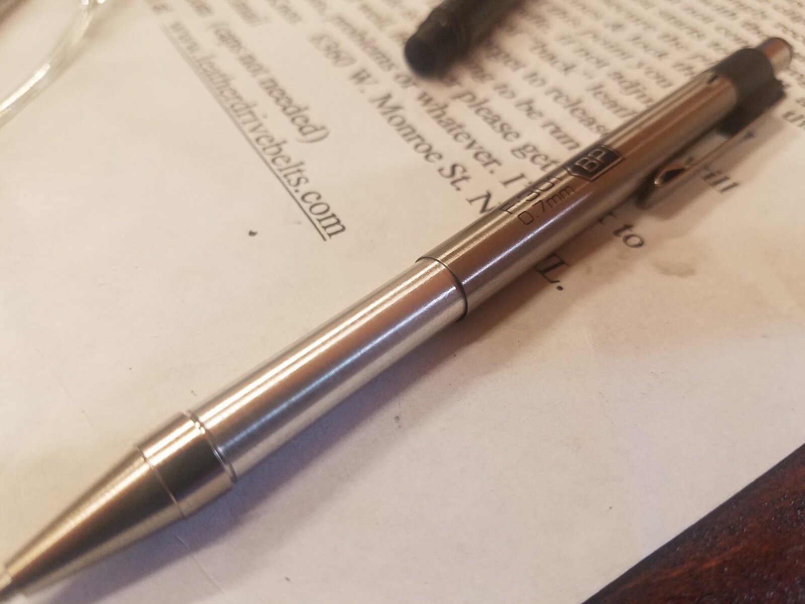

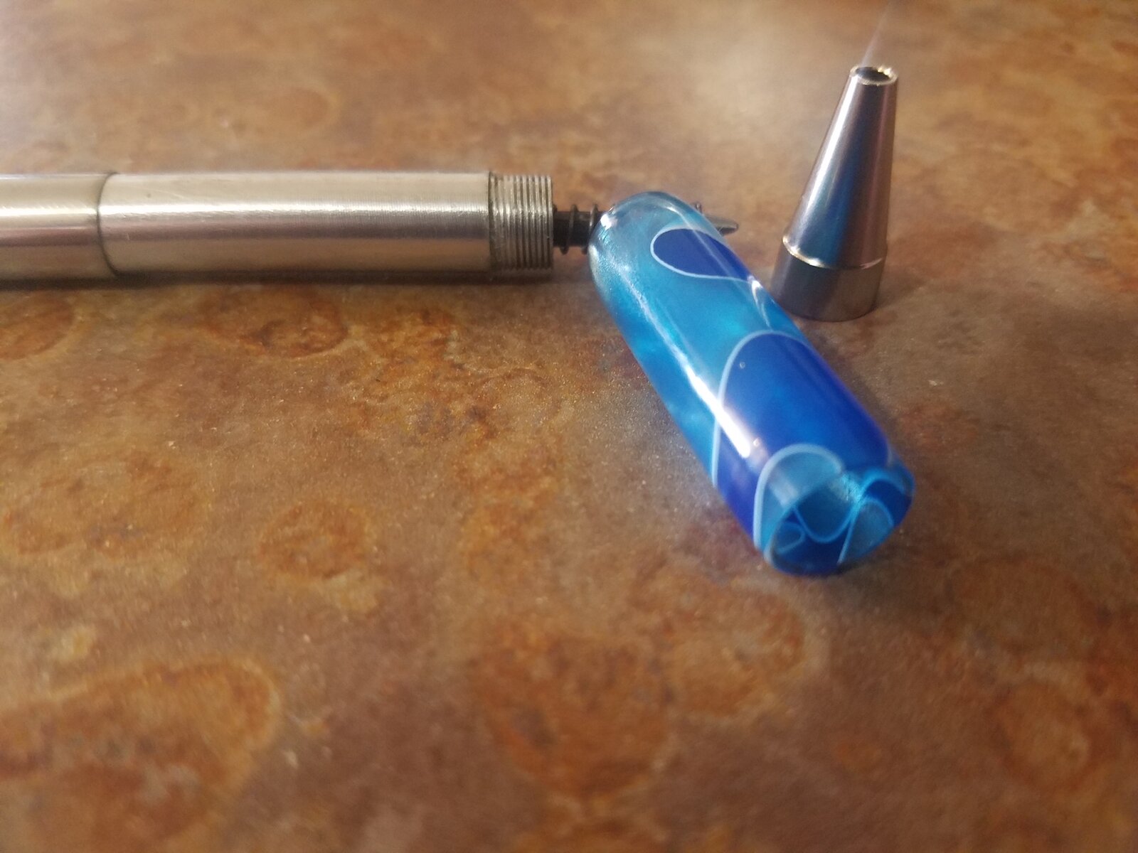

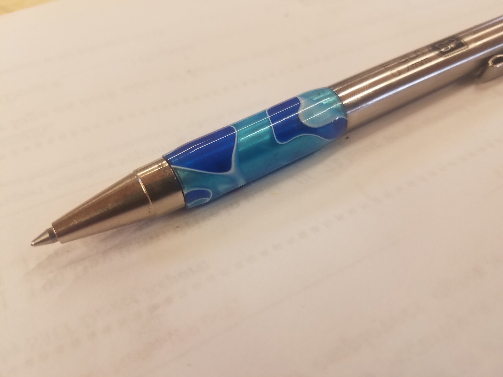

not the F301 but this may help you.
Do a good turn daily!
Don
I cannot remember what the thread pitches were as I made this about five years ago.
