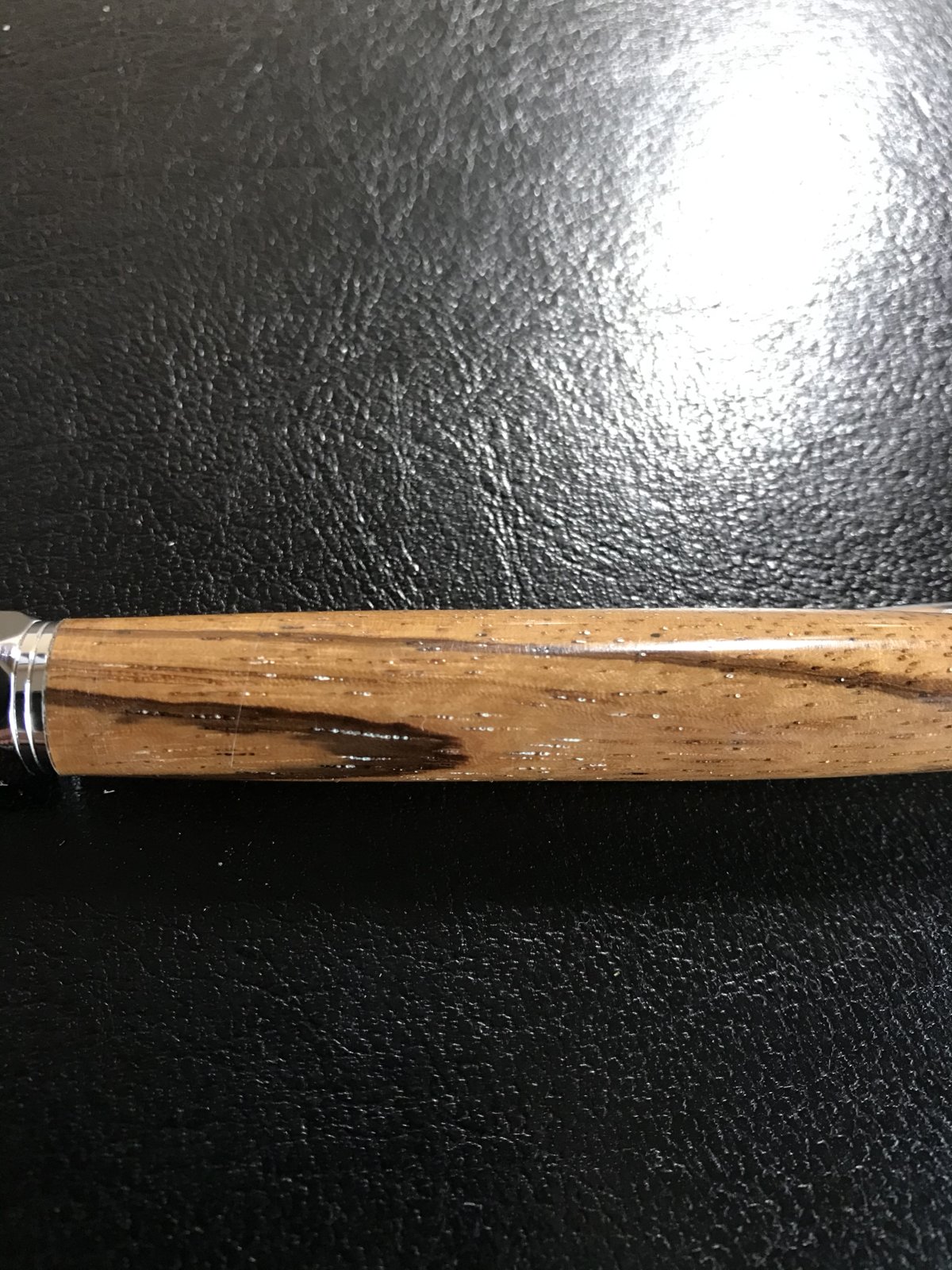

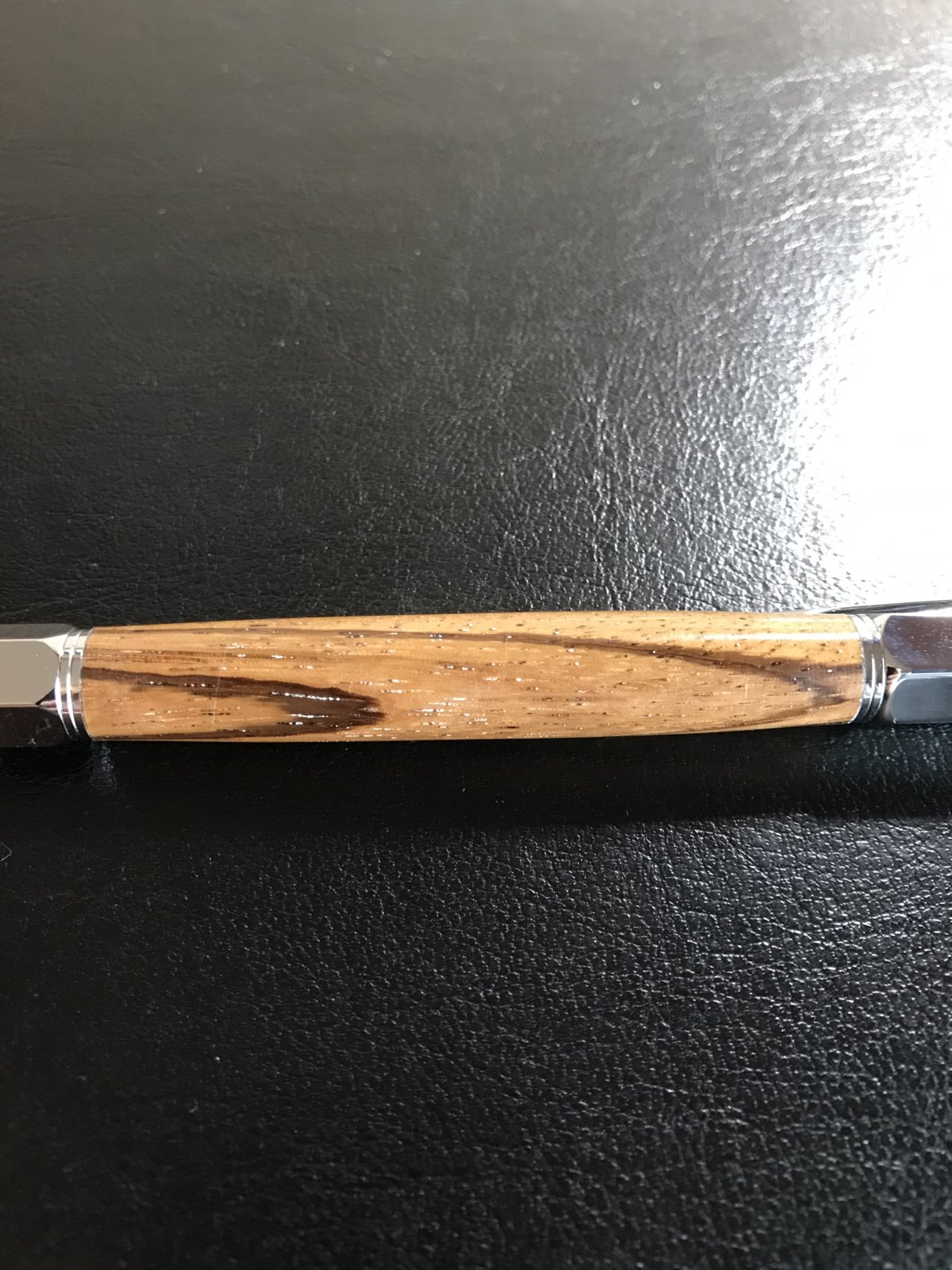

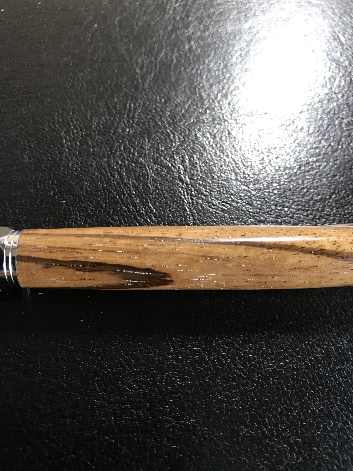

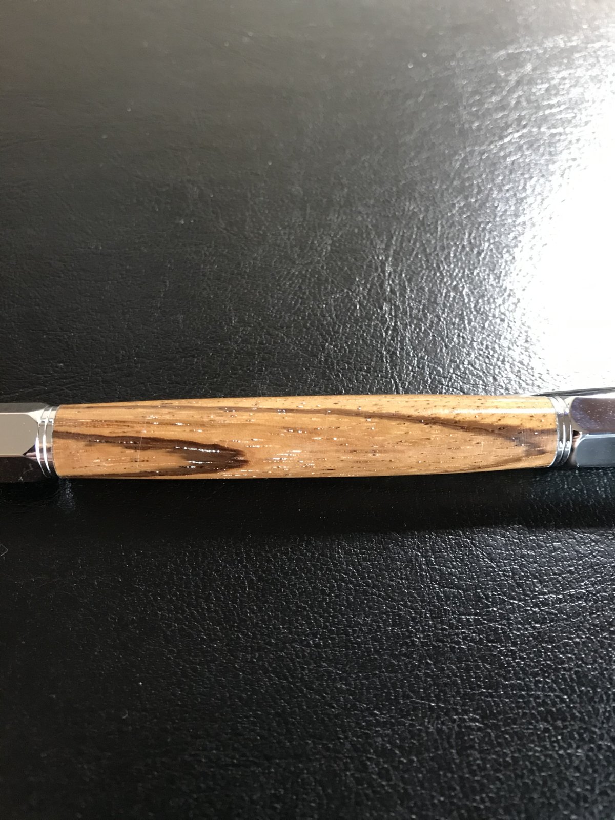

Today I made my first attempts both at turning diagonally cut (unstabilized) zebrawood and applying a CA finish.
To my surprise, though certainly not perfect, the CA part didn't go horribly. The zebrawood on the other hand - even with sharp tools and turning cautiously, the wood still ended up with "pits" in it. I'm sure that's not the right terminology, but basically lots of small areas that are lower than the rest of the wood. At some point during sanding, these must have collected some white dust that eventually got sealed in by the CA.
Is there a trick to turning and finishing this wood (and similar types) to get a more even surface? Any tips and would be much appreciated!

I think it just needed to be cleaned/blown-out better. I would like to hear other opinions.

Happy to report the second attempt came out much better. I can still see the divots, but no white is trapped in them. Also, the wood on this pen is darker and the grain stands out quite a bit more, which I'm assuming is from the BLO.
That said, I did see white streaks after my first coat of thin CA. All I had done prior to that was buffed the BLO (which was only one thin coat applied several days ago) with a paper towel. After applying the first coat of CA I sprayed it with accelerator and noticed the white spots, so I sanded it off at 600 grit and started over (side note: even with sanding the wood maintained a nice glow from the BLO).
Compared to my first crack at diagonal zebrawood, I'm fairly happy with this one with the exception that I was in a hurry and rushed the CA process. I applied 3-4 coats of thin followed by probably 6 of medium, dry sanded at 320 then wet sanded with pads at 800+. The result is more hazy in spots than I'd like, so I'm hoping I can just repeat the sanding process instead of having to remove the CA coat altogether.
