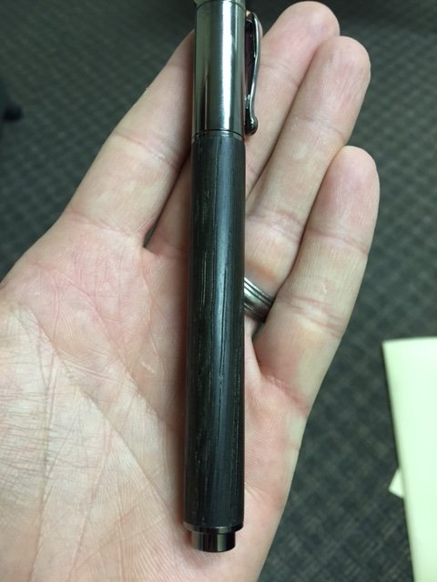

I use pens plus between grits of sanding but none after the last grit then wax. It's the finish I like on bog oak. I prefer it matte.

Very nice. I have a PP. It just doesn't last as long. I will try it on one and try CA on the other. Thanks!
In this case there's really not much to last as it's not really a built up finish - more of a pore filling solution.
You could probably also use a couple coats of thin ca knocked back down and get a similar result.

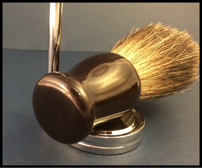

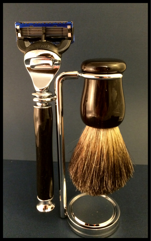

I did a bog oak shaving set with full on built up ca too and I think it came out nice.

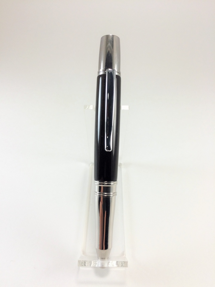

I made one (SPW Liberty) for my son with the following finish:
Sand to 800
Wipe with DNA
One coat of BLO
6 heavy coats of medium CA (EZ Bond)
2 coats of thin CA (EZ Bond)
Used accelerator after each CA application.
sanded again from 400 to 800
4 stage buffing
Plastic polish
Rejex
I was pleased. We will see how mine turns-out and I will post.

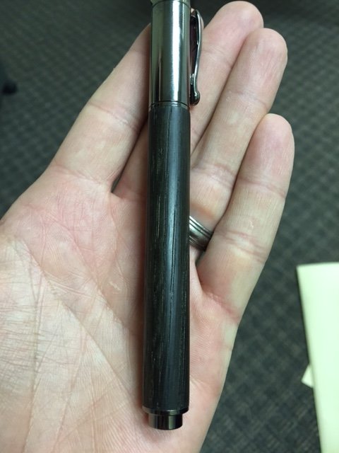

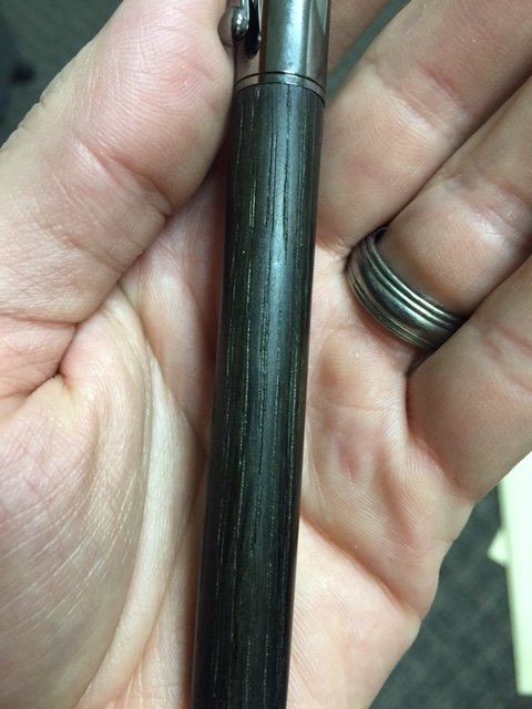

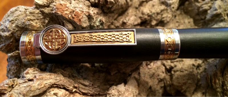

I did an Irish Bog Oak Zen two weeks ago and went with Walnut Oil, sanded lengthwise at each step to be sure the pores were all cleaned out. Laid the oil to it and wrapped a paper towel soaked in walnut oil around it overnight and wiped it off the next night. I really like the look. This was borrowed from Yaroslaw's Ukranian BO pen other than the wrapping the blank overnight, not sure if that made a difference or not.
Here's a quick couple of pics.

Thank you. I will definitely finish similarly. It is survived 2,500 years in a bog, I am sure it will endure a decade or two of handling. It really is something that can be admired and enjoyed with little finish. I guess nature already done most of the work for us.

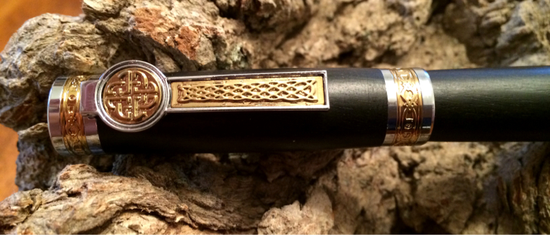

My preferred finish for all pens is CA just because it lasts. My carry pen (about 5 years old) has the plating worn off the metal but the CA finish on the wood is almost like new, other than a few dents from dropping. Here's one of my bog oak pens in CA

Here's the one that I posted in the SOYP:
2 coats BLO
About 8 coats drooled on medium CA
2 coats of thin CA (for good luck LOL).
I used accelerator. CA was EZ Bond.
All dry sanding to 800
Buffing wheels
Meguiars 205
Rejex
