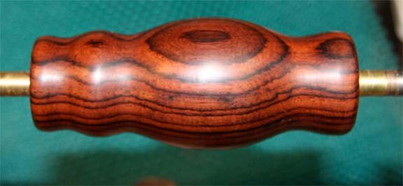

There were three steps that helped me make the transition from "fair and good" to "Sell this one for $100 to $150 or more."
First was changing to use calipers without fail. No more depending on bushings. Calipers for every fit. It didn't take me long to write down measurements and turn/sand/finish to tolerances. Early on, this seemed like overkill as I read of others doing this without fail. Then I realized how rewarding it was to have consistently sized turns.
Second was, patience. After learning to use the calipers, I applied that diligence to other aspects of making the pen. I worked on sanding and CA finishing. After nearly 1 1/2 years of inconsistence in finishes, I made it my goal for about 3 to 4 months to learn how to perfect CA finishes and fix mess ups. My goal was not to make pens, but to master CA finishes. I made some good pens in the process but the goal was mastering CA finishes. This involved the patience to experiment and work until it became second nature.
Third, the mandrel-less system helped me improve on the out of round and also the chipped CA finish that happened with oily woods and bushing separation.
Below are two picts of the same duck call. I deliberately over applied CA and dried it with a hair dryer, creating the frosted look. Below that is the "almost" finished DC without ANY white spots. How did I do that? Practice, practice, practice. I learned how to artificially create white spots and how to get rid of it. Yes, it is OVERKILL, but When it happens, I don't have to start worrying or wait for a dozen different suggestions here to figure out what to do. The worst thing is that I may have to take it off and start over. I accept that too.
But the point is 1. measure, 2. practice & patience - make different steps of "pen making" - a goal that you know inside and out, and 3. use methods and steps that help you out of tough spots. When you do this, all the different aspects of making the near perfect pen fall into place.
Lastly, keep checking here for new ideas and things that can enhance what you are already doing right. WAYNE above gave a GREAT idea for checking the finish. I am going to add a magnifying glass to my small workshop!
The pictures of Problem and Fixed:
