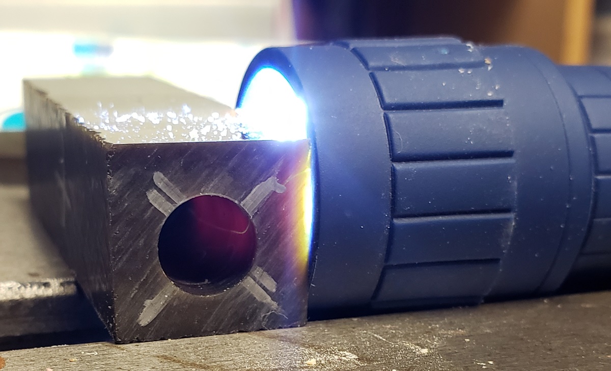

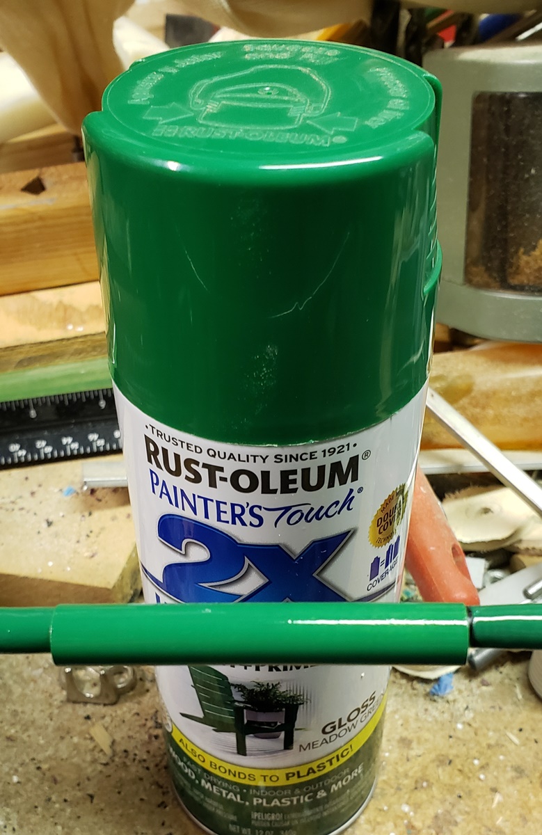

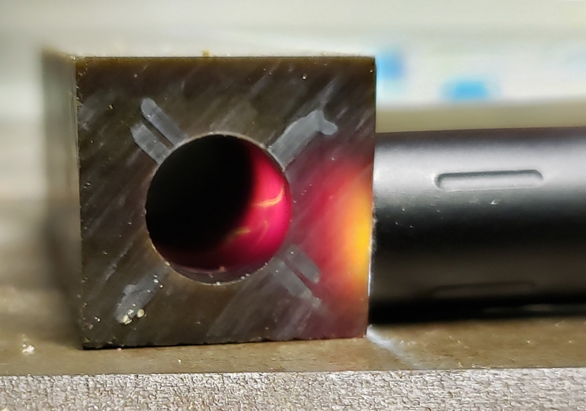

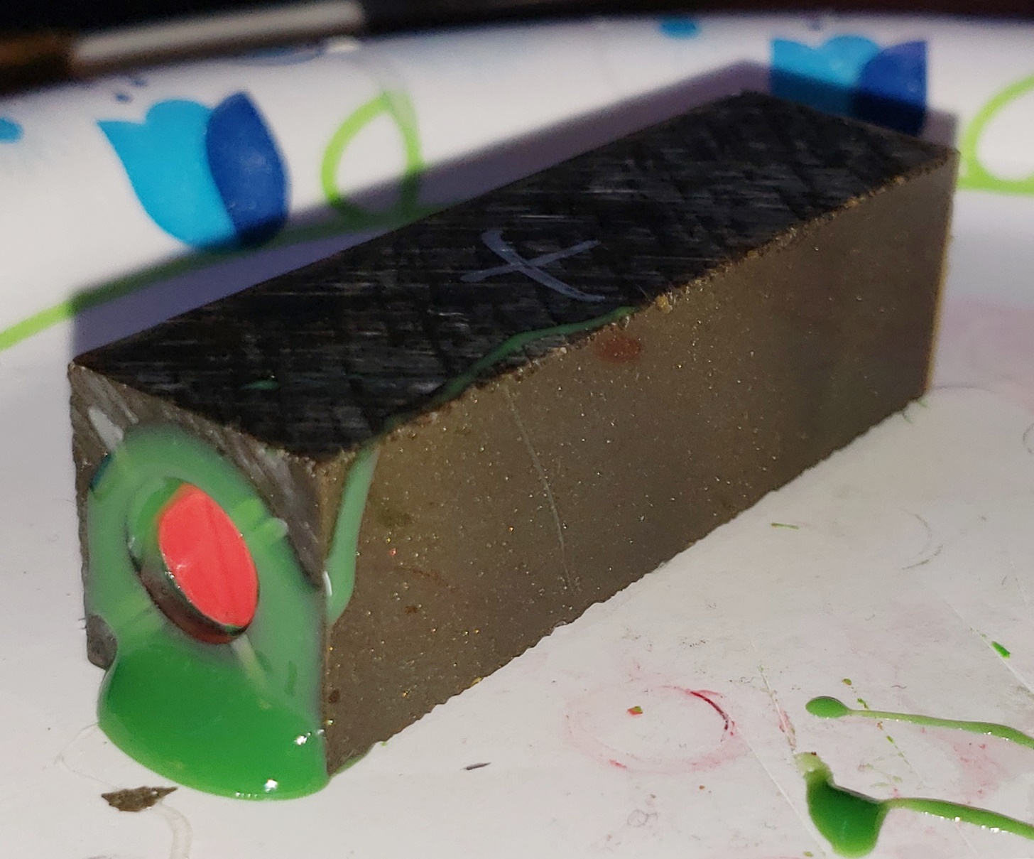

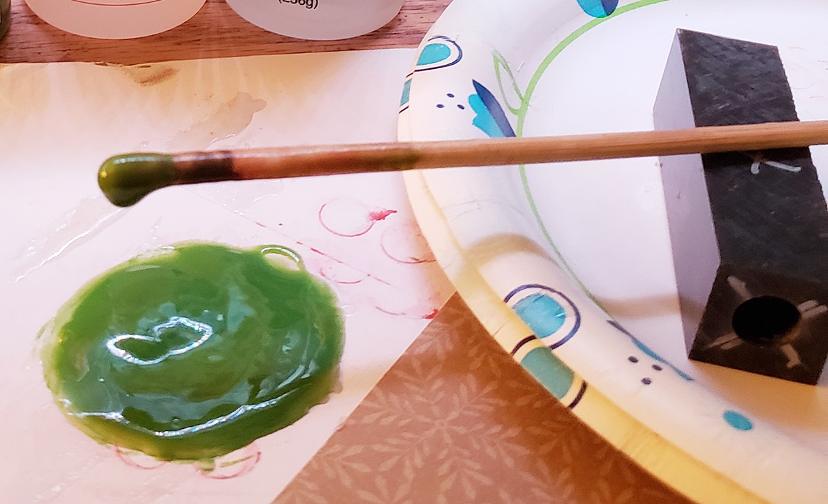

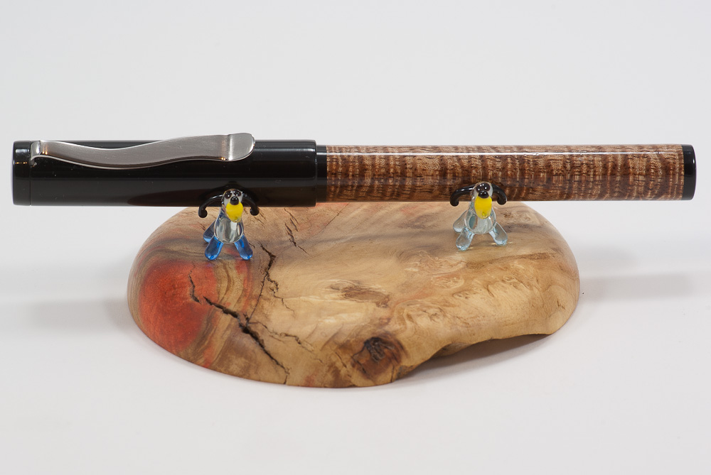

I have this blank arriving today. Did you do any painting of the tube or inside of the hole, or just use the brass tube as-is?
I painted the tube and colored the epoxy. I don't know if it was necessary, the blank is fairly opaque. But I wasn't taking any chances.
Ah, ok thanks - this was very helpful. I ordered 3 of them, so I'm tempted to try one without painting (really just being lazy since I don't have that color paint at the moment). If that doesn't work though I now know exactly what I need!
A lot of it too, depends on the pen kit. Some are turned fairly thin, while some are turned thick. You can tell by the bushings. For instance, the Clip Bolt Action and the Celtic both use 3/8" tubes. But the CBA is turned down to 0.445", while the Celtic is turned to 0.525". Some are even thinner. The Executive is turned to 0.420". The thinner the acrylic, the more chance that the bare brass tube and/or epoxy will show through.
That's a good point. I'm not all that great yet at guesstimating whether or not to paint based on blank material/color + thickness. I turned one of PSI's aromatherapy pens a couple weeks ago (which has slightly larger bushings than the CBA) and the brass tube did show through slightly. I had spray painted the tube white, but some chipped off as I was inserting the tube. However, I was also using a relatively translucent pink/white blank, so perhaps the Cosmic Dark Bronze blank will be more forgiving.

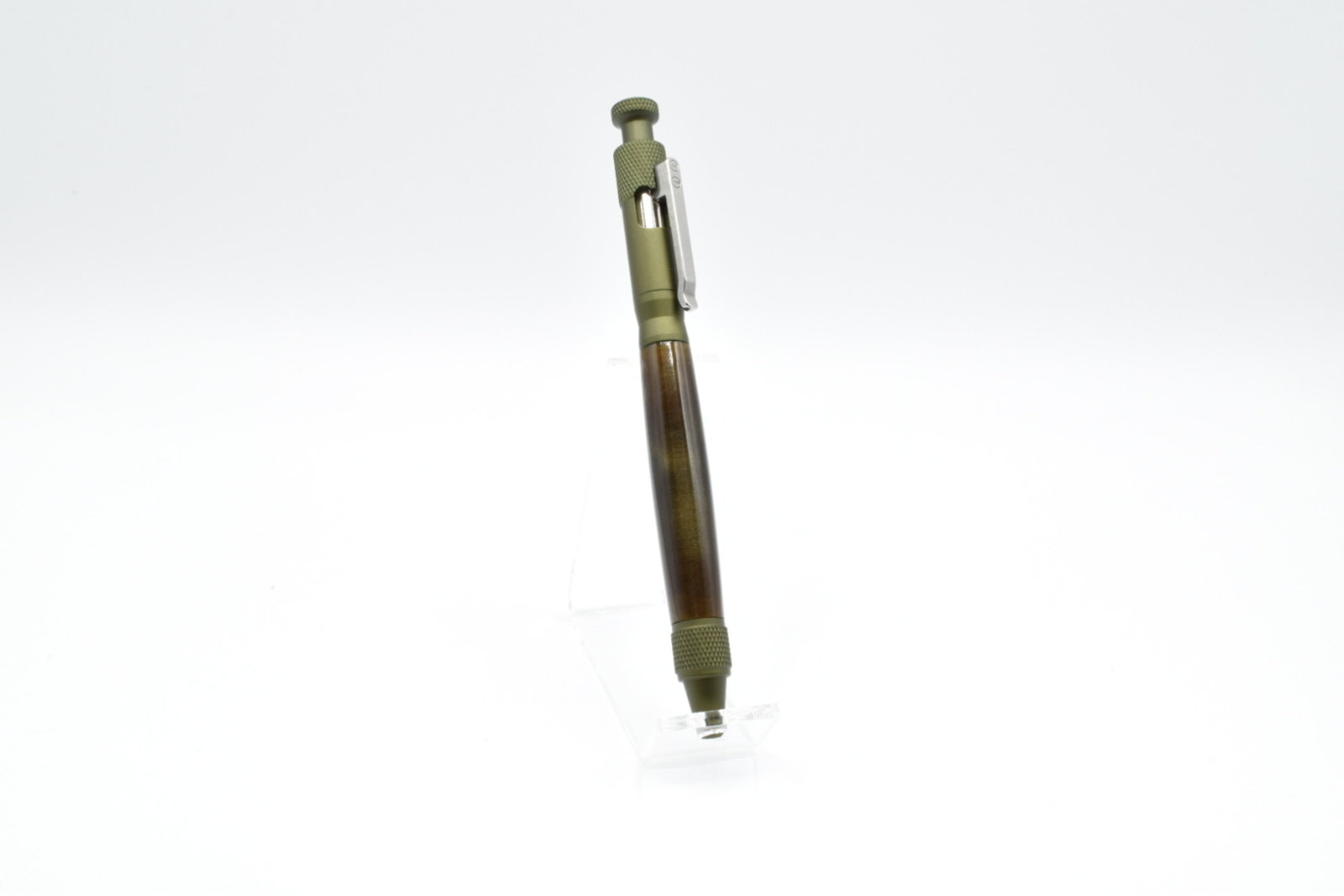

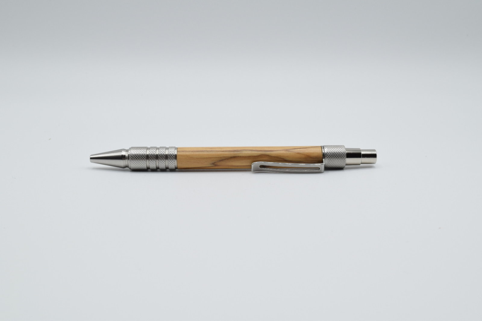

Had a chance to turn the Clip Bolt Action yesterday. I went the lazy route and didn't paint the blank or tube - there's a couple lighter spots where it's thinnest near the bushings, but I'm not unhappy with how it turned out overall.
Also, couldn't help myself and flattened the profile on my EDC olive wood pen I turned last week. I definitely prefer this one flat vs. rounded.

That looks really good. You can't see the tubes or glue, it just looks a tiny bit lighter on the ends.
Thanks..if I shine a light to it I think I can see a dab of glue, but it's very subtle. Still, if I were to turn this again I'd probably opt to paint as you did.
On another note, the blank kept catching no matter how much I tightened my mandrel saver. Took it off and found the tube had come unglued, so it had just been spinning. I figured since the tube looked "pre-scuffed", no need to sand it before applying the CA. Looks like I was wrong! Either that, or I should just make the switch to epoxy. :) Fortunately, was able to re-glue and save the blank.
