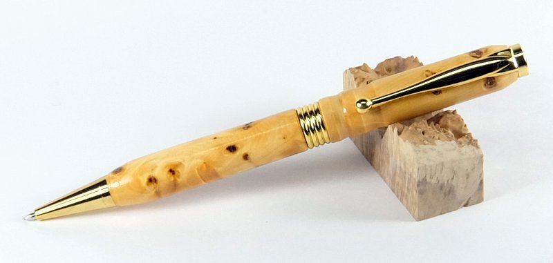

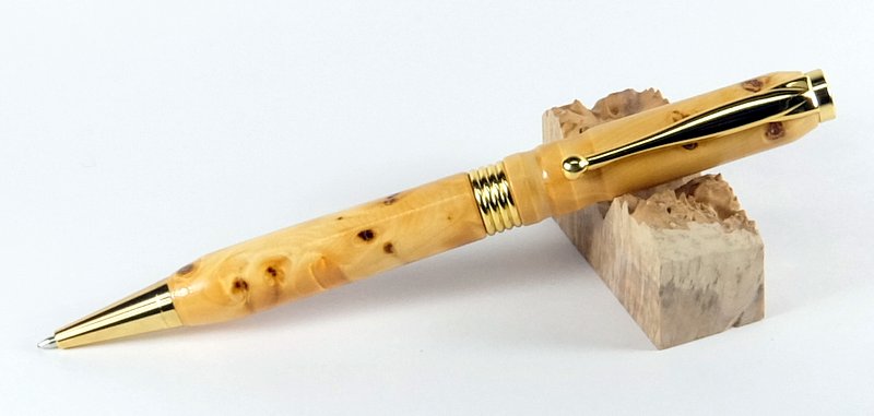

I am a great fan of tripple eee but still give a couple of coats of CA see this pic of a recent pen.
Kind regards Peter.
