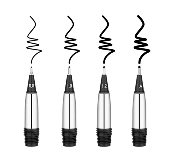

So, I don't know how long ExoticBlanks has had these, but I noticed them yesterday when I was ordering some refills for some pens I recently made for a customer. I was intrigued by what the possibility they open up:
I guess, this is only one line weight, but maybe there are more options here? Could of course, be used with any rollerball compatible with 5888s, so the quality is up to you, as far as what kit you use.
