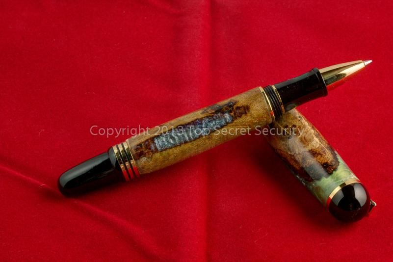

Here it is!
I got off my butt and took a few pictures and here is one that came out rather nicely. I am now off to see if I can duplicate my success!
Elliott

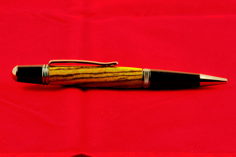

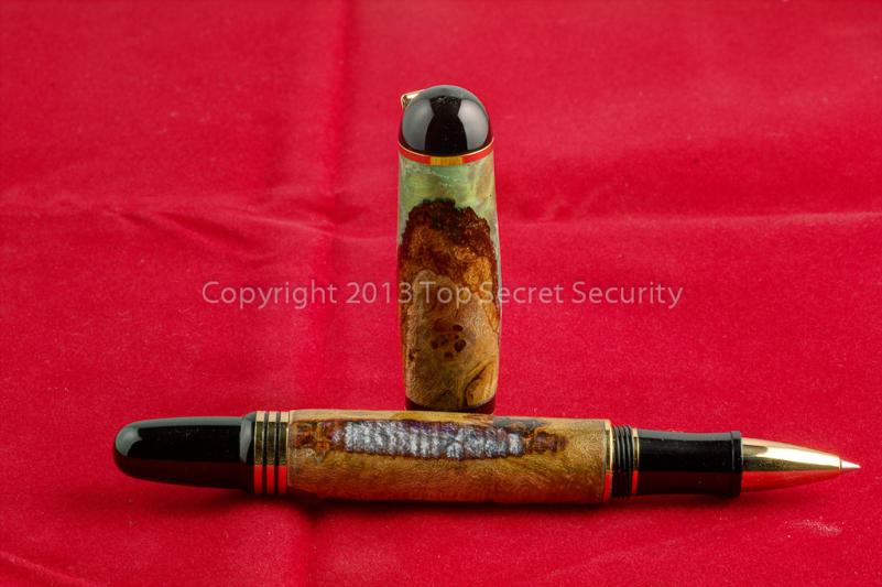

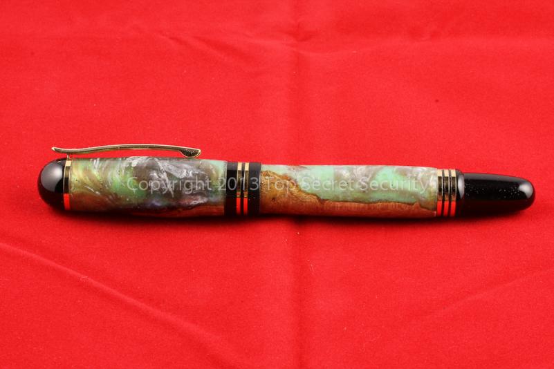

Figured it out!
Awesome. I just figured out posting pictures and how to do a CA finish. Here is my last one.
Elliott
