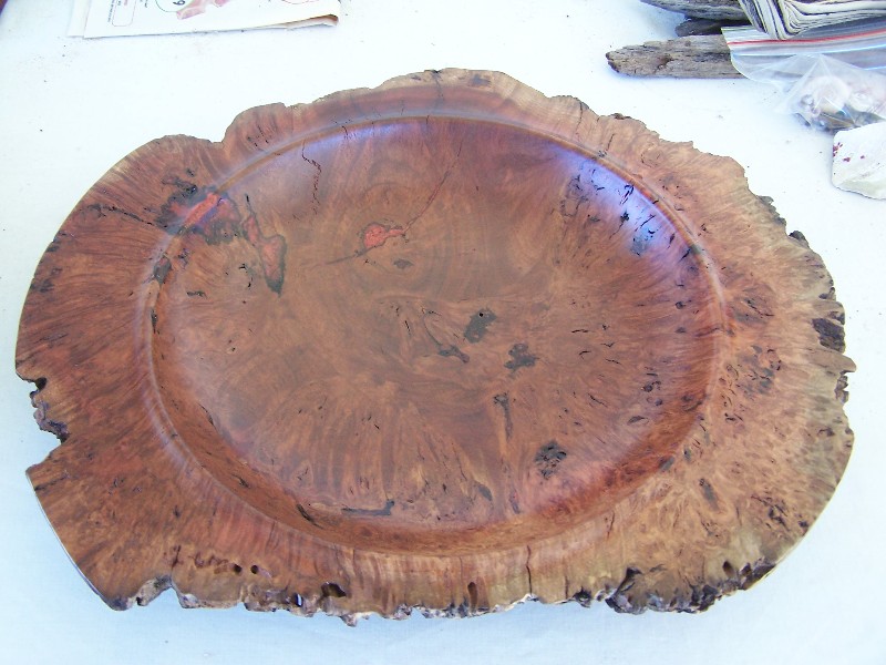

Got these finished yesterday and today.

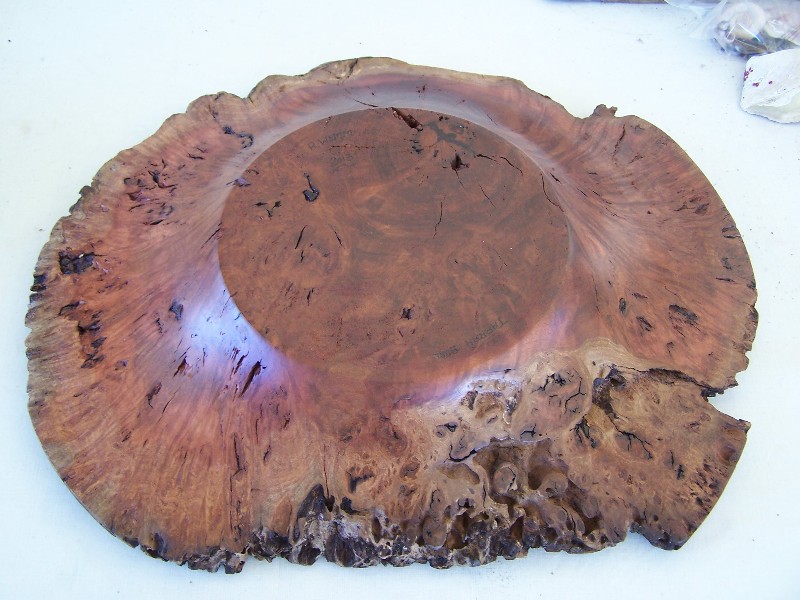

Jarrah Burl platter 15.75in dia and approx. 1.75in high. Top/inside voids filled with colored resin and finished with Mirotone Semi-gloss Lacquer.

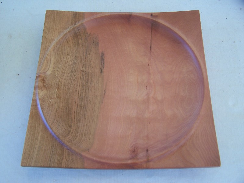

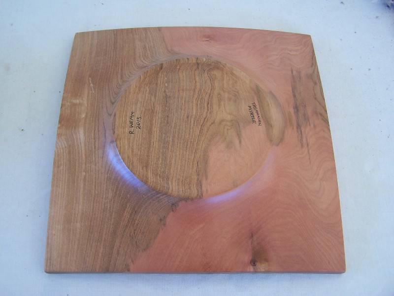

Square Platter is Tasmanian Myrtle and finished the same as above. Size is 11.75in x 1in.

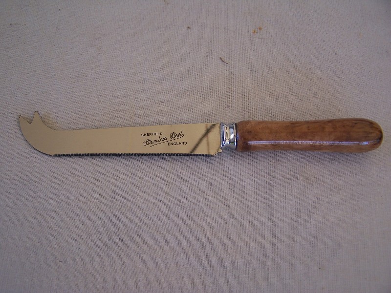

Cheese knife is from Tasmanian Oak Burl, and my very first attempt at a CA finish. (please don't look too closely):biggrin:

Excellent Bob! the semi gloss looks a really good finish. also Bob may i ask you what was your chucking method on the platters thanks in advance.
Hi John,
I use a normal spigot on the base until the piece is finished, then I reverse mount onto my Cole Jaws, (Inside the centre ring, but not holding) sort of like a vacuum chuck, and then use the tail stock to hold it centred against the rubber/nylon blocks of the Cole Jaws. Then I very carefully cut the spigot off as much as I dare with my angle grinder. When I get to the "chicken" point, I demount and finish the last bit off with my drill pad.
Hope this helps.
Bob.
